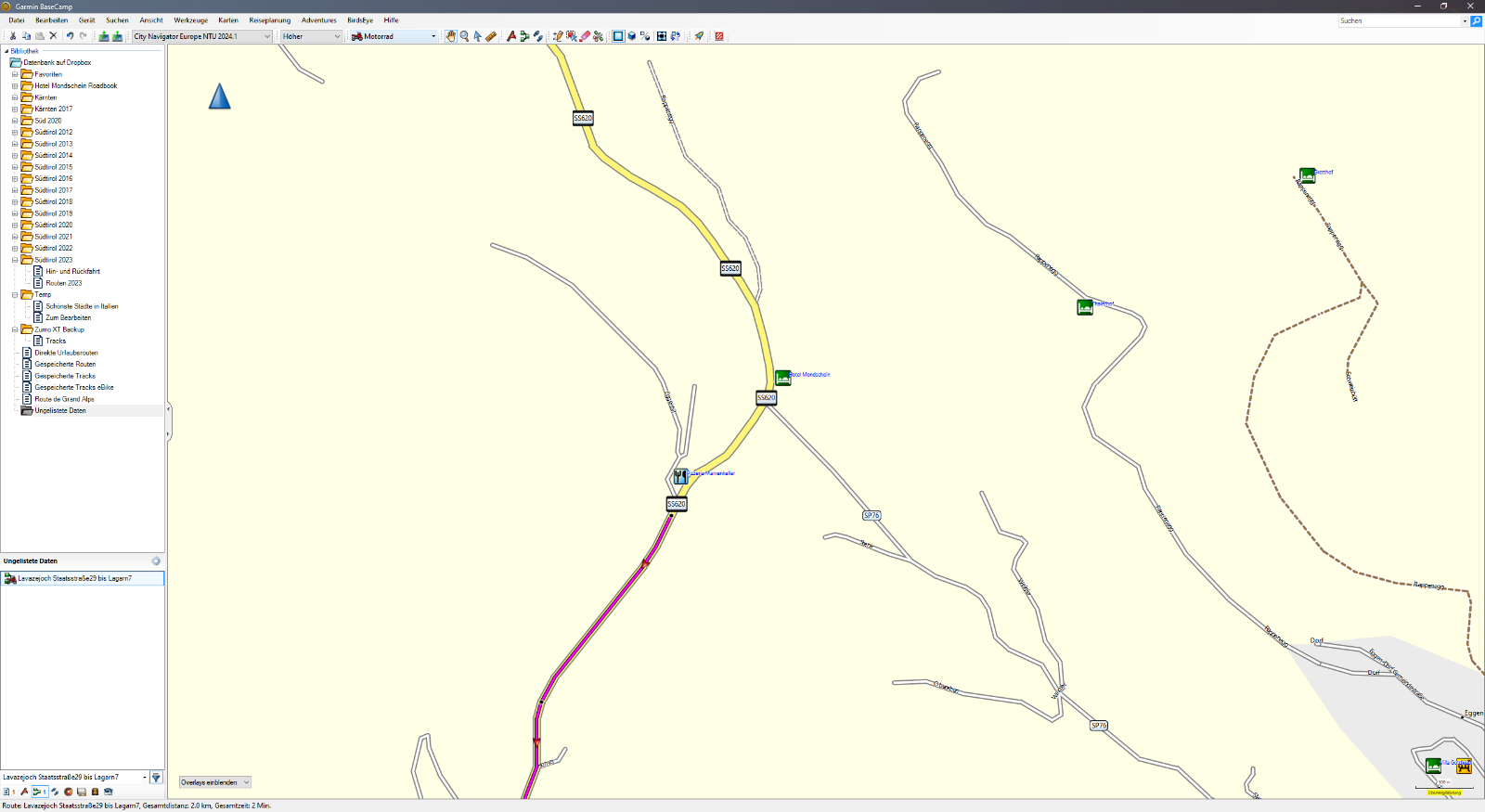

As a picture says more than thousand words, her's a example how i start my routes - starting point is the parking lot of 'Hotel Mondschein' in the center of the map...
