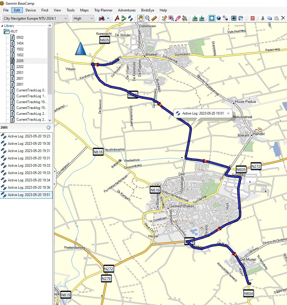

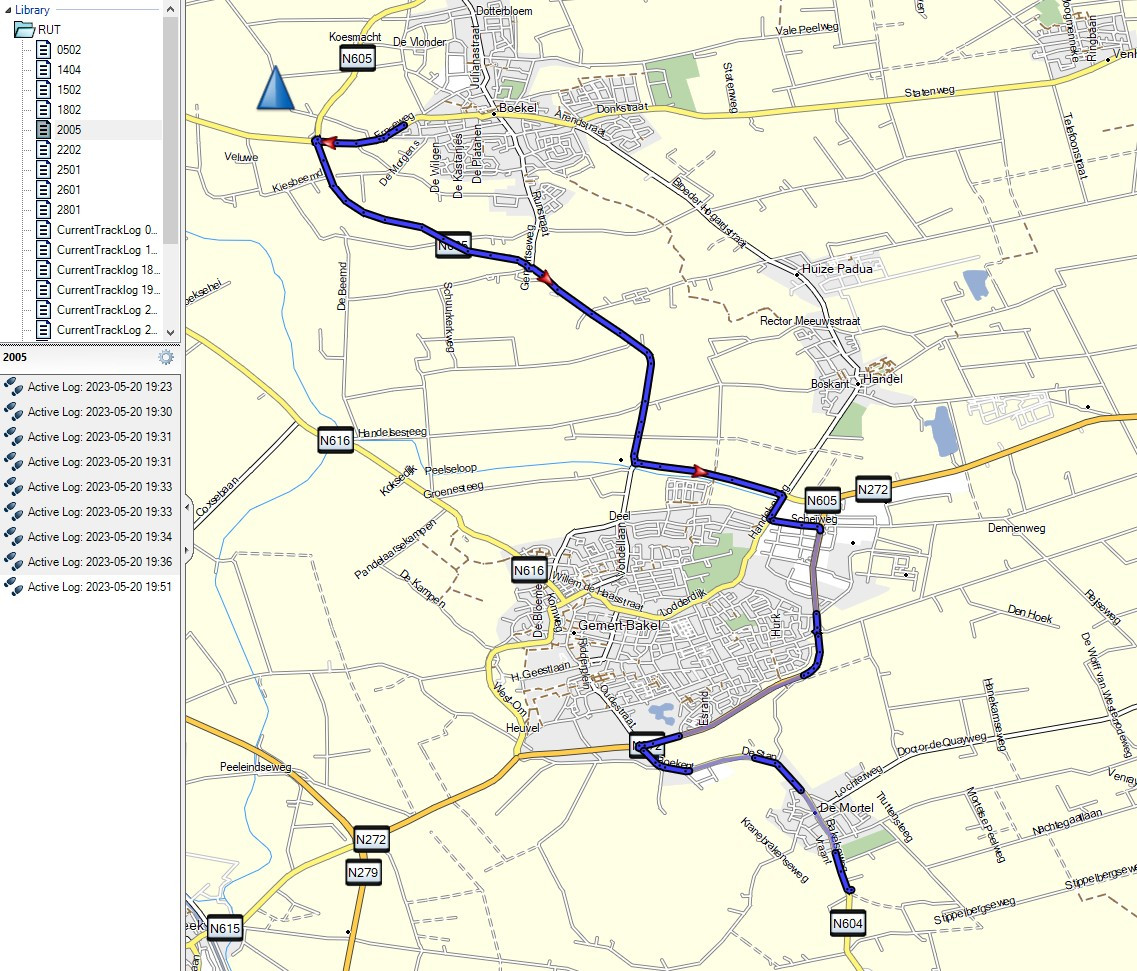

Just did two more tests.
1) Deviated from a trip, listed under Imported, and it kept requesting U-turns.
2) Deviated from the same trip, but patched so that it was listed under Saved, and it recalculated nicely.
Beginning to believe "We've got em"
@danham Meanwhile I created a small Java program that modifies a trip to 'Saved'.
Nothing fancy, and probably real Java programmers will frown their eye brows, but it works. Interested?
Edit: Added 2 screenshots of the tracklog. The first shows clearly that it's broken, The second is unbroken.
Tracklog Imported.jpg (358.21 KiB) Viewed 1407 times
Tracklog Saved.jpg (343.92 KiB) Viewed 1407 times
