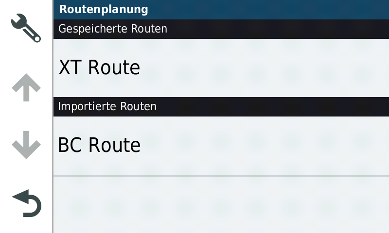

Did check, where the files are stored - 'BC Route' is in 'GPX/temp.gpx' and 'GPX/current.gpx' and 'XT Route' is only in 'GPX/current.gpx'. I add both files, if it is helpfully for you. Also here are the screenshots from the two routes:
Here we go - as expected, 'BC Route' is listed under 'Imported Routes' and 'XT Route' is listed under 'Saved Routes'. Named the routes just as suggested from you, two nearly identical, short routes with one via-point in the middle, 'XT Route' was created directly on the Zumo 595 with the route planning tool and 'BC Route' was made with Basecamp and transferred via drag-n-drop to 'Internal Memory' - after a restart of the Zumo 595, it asks if i want import a new found route to the route planning app, and i said yes...jfheath wrote: ↑Tue May 23, 2023 4:47 pmOh thanks !
Have at lease one route created using trip planner on the 595. Call it something imaginative like "XT Route".
Have at least one route on the 595 that has been transferred from Basecamp, and has then been imported. Call it "BC Route".
Select Apps->Trip Planner->Saved Trips. The XT shows a couple of black 'headers' across the list. One above the 'Saved Trips' and another above 'Imported Trips' Scroll down to see what the 595 has please. Where are XT Route and BC Route located in the list ? Under what Banners ?

Wow - thank you. So yes the 595 does make the distinction, just like the XT. But the 595 never had the RUT issue** - but neither does it have the ability to turn tracks into navigable 'trips'. WHich I think is significant. I think that imported is
** I never observed the RUT behaviour taking place on the 595 and I ran with it for quite some time. But I don't think that I ever formally tested it - and I gave it to my brother.
The issue with temp and current gpx files.
Temp.gpx is where data is stored when it is transferred to the Zumo
Current.gpx is where it is stored when it has been imported.
Temp.gpx is not used by the Zumos except to allow routes, tracks and Waypoints to be imported again.
However, every time you connect a USB cable to the Zumo XT and begin additional transfers, then the temp.gpx file gets over-written - which means that routes connot be imported again if this has happened.
I suspect the 595 might do the same - and that might depend on what file transfer mode it is in - as it requires temp.gpx to be added to, and you cannot add to a file on a system that uses media transfer protocol. But when I was doing a lot of testing, I had a 590 which I kept changing back and forth to a 595. I know that I tested it, but I couldn't say which Zumo I was testing it on.
The XT can only operate in MTP - it does not use 'Mass Storage' - which gives you a drive letter.
But of course, if you create the route on the XT - it never goes into temp.gpx. That is there just for transfer from Basecamp. Neither is temp .gpx used if you transfer the GPX file direct to the Gpx folder. Nor is it used if you transfer to the SD card. In both of those cases there is no risk of losing the files - so you can delete the route from the XT, and it will still be there to import.
