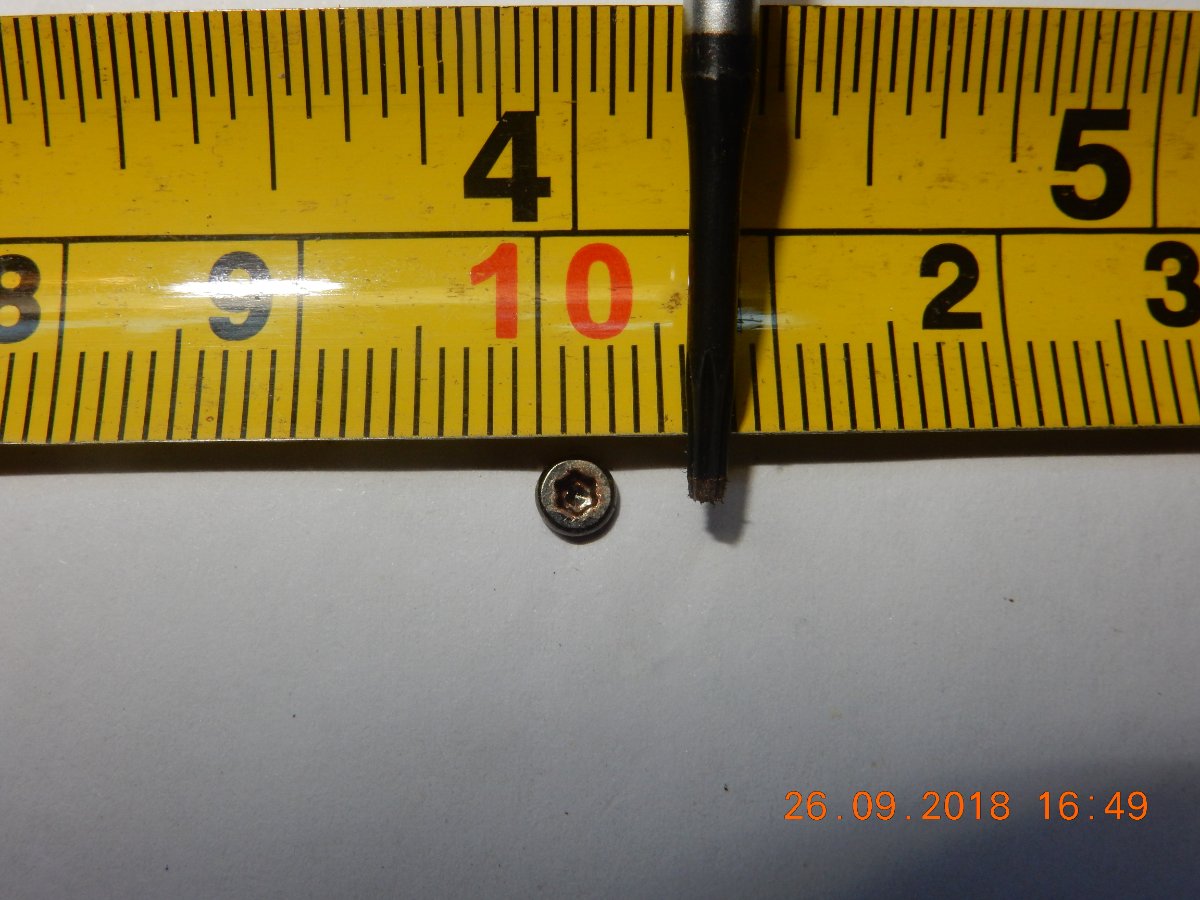

Just for a comparison, I just took this picture of the Z550 case screws. The head is approx 3mm Dia and the driver is a T6

Thank you for your response. I think T6 maybe a little large for the 390 but I appreciate your help as it gives me a guideline. The screws on the 390 are held in deep wells on the back so it is difficult to see actual size. It will be a case of trial & error.

On my 395 the 10 screws require a T6 driver.
