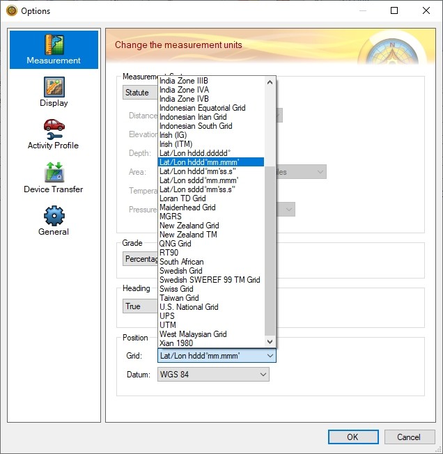

In BAsecamp, if I want to do this, I place a flag - anywhere, and then double click the new point in the bottom left hand pane.
You can enter the co-ordinates in whatever form you have and BC will convert it for you
It will convert it to whatever format you have selected in Edit->Options->Measurement->Position
Click the picture to see a larger version.
In the above formats h = Hemisphere ie N or S / E or W
s = sign eg + for N or W, - for S or E
I find hddd.ddddd the easiest to use for entering data. eg N54.12345 W2.67890
For other formats it isn't always easy to find where the degree ° symbol is on the keyboard.
On the PC you can use the number keypad on the right. Make sure NUM LOCK is on, hold down the ALT key and type 248 and let go of the ALT key.
But I spend more time reminding myself how to do it than it is worth. If I need to, I copy one to the clipboard and paste it using the PC keyboard shortcut CTRL-V
