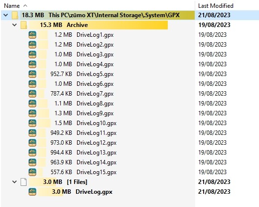

Long shot. Can you see the hidden .System folder ? In there, there is a folder called GPX, and that contains DriveLog.gpx which appears to be a duplicate of the CurrenTrackLog.gpx. The archive folder seems to have duplicates of the numbered archives but these are called DriveLog1.gpx, DriveLog2.gpx etc. They may still be there if the Archive contents were deleted accidentally - but they do not survive a system reset.
Access to the .System Folder.
Main Screen -> Map -> Speed Button -> Long Press Circular Speedo (10 secs) to access the hidden system config menu.
Configuration and Settings -> MTP Settings -> Show .System -> Tick

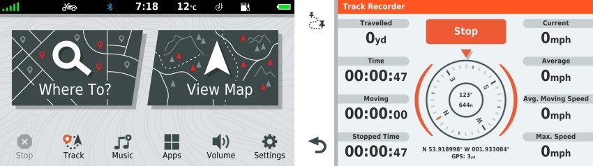

Recording a Track Manually
Some screen shots. Click the pic to get a slightly laregr version.
Note the little recording orange disc on the Track icon.

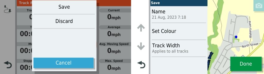

You must press Stop in order to save the recorded track. It will keep recording each time you turn ont he Zumo as until you press stop.
When you press stop, you get the option to save or discard. Tap Save.
Only then does it give you the option to change the name - which you can do by tapping the name label on the left.
And then - you must press 'Done'.

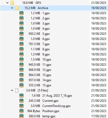

Here is my view of my files and folders.
This is after recording a very short track of my Zumo moving 2 feet across my desktop.
Curiously - I also have just 15 files in the archive - and these are all set to the same date - 2 days ago.
I had never spotted that before. My CurrentTrackLog.gpx file is also large at 3MB
Note at the bottom is the contents of GPX with the same standard 4 file names (Current, CurrentTrackLog, Position and Temp). The saved track log is there - with the name given by the XT by default - I didn't change it.

And this is the GPX folder inside the Hidden .System folder showing the DriveLog files.

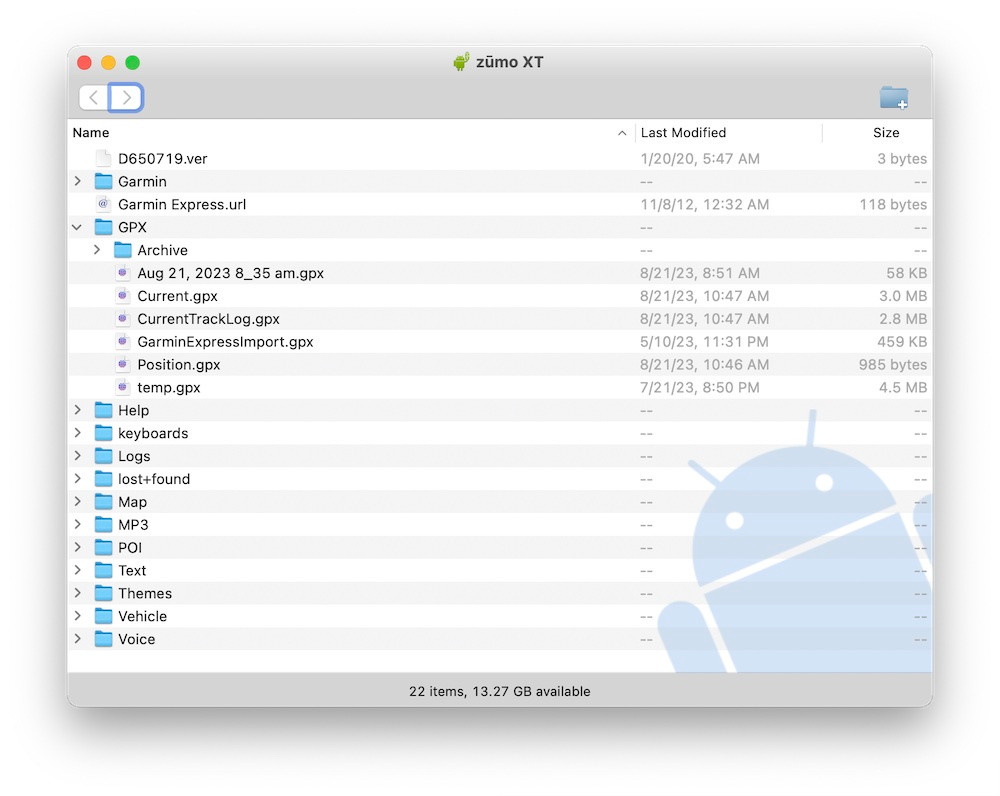

When I got back home, I turned the XT back on and found the track in the Tracks app. The file was there. I hit the wrench (spanner) and selected "Share" and shared via the Drive app. The iPhone alerted me as usual "You've received a file – Do you want to share it?" and I said yes and used AirDrop to send the file to my desktop Mac. It arrived with its usual uninformative filename (bt_shared_tracks.gpx) but this time when I opened it in Utrack... The time and elevation data were INTACT! I could see my max/avg speed, elevation changes, etc. I also tried opening the file in Google Earth and sure enough, it could "fly" the track with no problem.
Encouraged, I plugged a USB cable into the zumo. Once mounted (via Android File Transfer), I opened the GPX folder and there was my track, properly named.
You can see it there at the top "Aug 21, 2023 8_35am.gpx." I dragged the file to my Mac desktop and tried opening it with Utrack and Google Earth again, with the same positive results: The speed and elevation data were properly saved.
So I think this problem is SOLVED!!
My guess (and it's only a guess) is that when the zumo XT is connected to Garmin Explore, it doesn't bother saving user-recorded tracks locally (on the zumo) but just uploads them to Explore. Perhaps to save space on the XT? The files would still show up when I opened the Tracks app, but for all I know the zumo was just accessing the files on Explore via the Drive app. (I could be wrong). That might explain why my recorded tracks weren't in the GPX folder on the zumo and why they disappeared from the Tracks app when I disconnected from Explore. And in any case, when the files are uploaded to Explore they get stripped of their time/elevation data for some reason.
