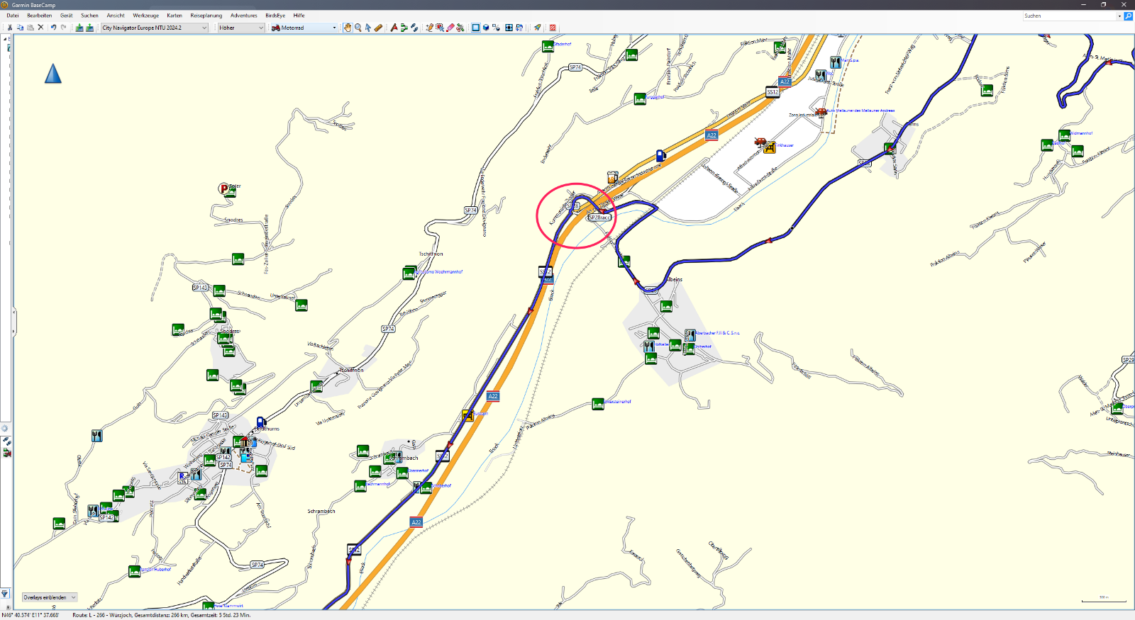

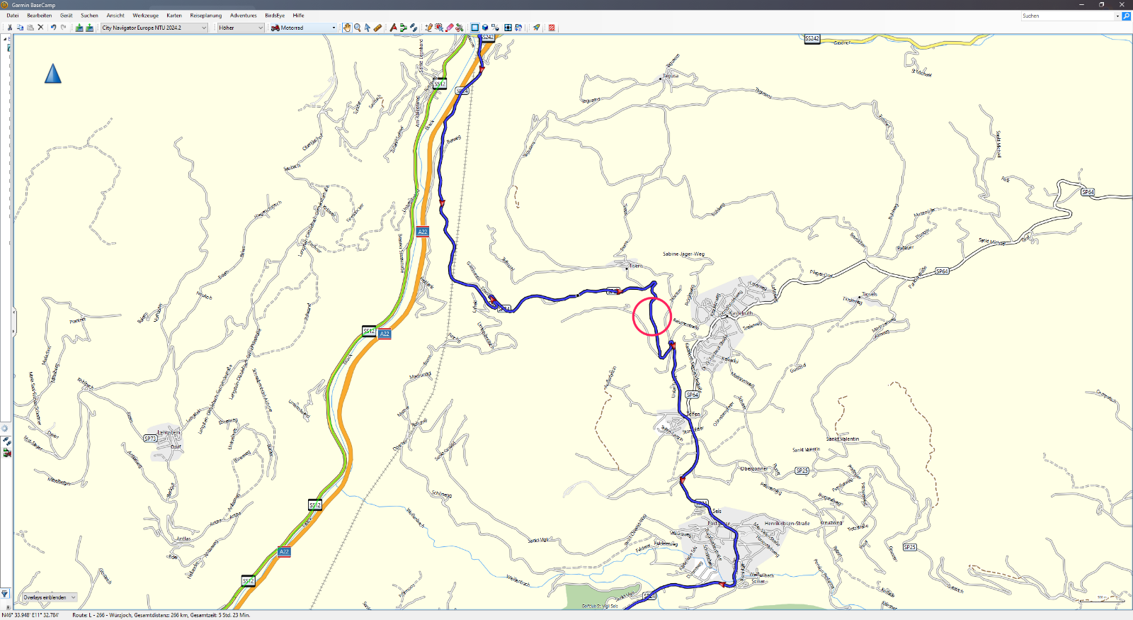

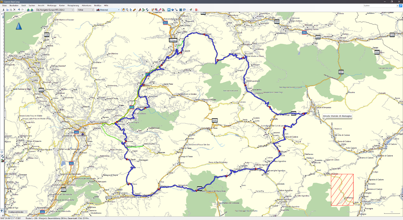

For sure this can't be the only reason for this zig-zag weirdness re-routing!
In my example from 2021, that i've posted above, there wasn't any via- or waypoint in the pre-planned route, only shaping-points and i got the same stupid zig-zag course with an extra of around 100km(!) after such a road-closed-rerouting....
This was the pre-planned route (blue) and my driven track (green)
Red marker shows the place, where the re-routing occurs
2023-09-30 (1).png (543.34 KiB) Viewed 2061 times
Red marker shows the (not really) closed road
2023-09-30 (2).png (662.54 KiB) Viewed 2061 times
And again - red marker where the re-routing starts, orange marker our hotel...
2023-09-30 (3).png (1.2 MiB) Viewed 2061 times
