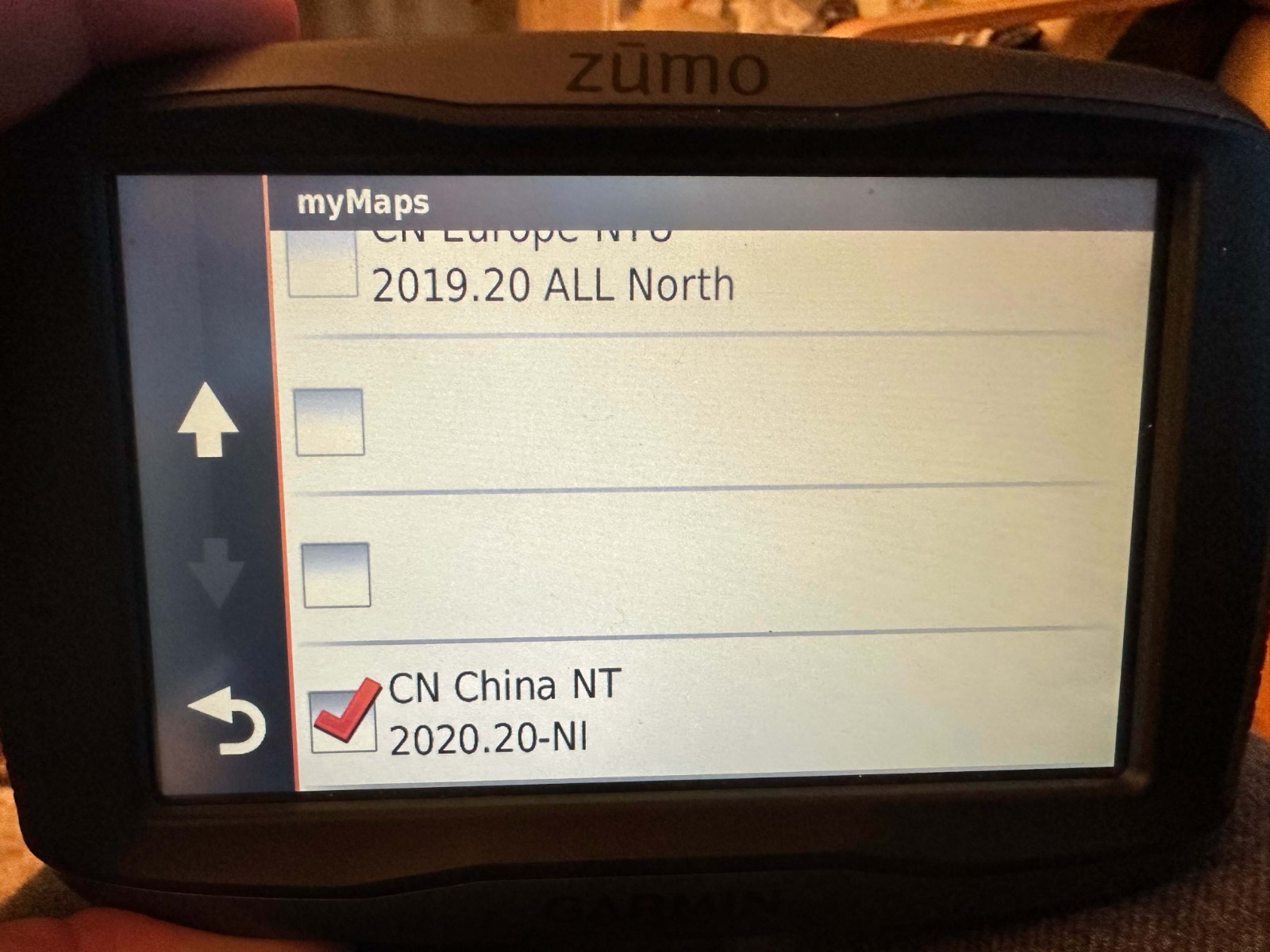

Still going through my steep learning curve and reading all I can on here but I have a problem.
Now should I continue here or should I delete this post and start a new thread???
here goes
I have downloaded the maps for Tajikistan and Kyrgyzstan from https://www.userbeam.de/ and have added them to my SD card.
Then using JaVaWa device manager, I have moved them to the main memory of my device. When my Zumo is connected to Basecamp, I can see the maps present on the left hand side, I can also choose a map from the menu at the top and I can zoom in and make a route with it.
But...
When I try to choose these maps on my Zumo I get a list of maps with the checkboxes except the names for the Tajikistan and Kyrgyzstan are blank although there is a check box. Just no name after the check box.
And when I try to view the maps on my device, they don't show up.
I have tried to rename the maps using JaVaWa - but no luck.
I have read this thread but equally no luck; viewtopic.php?t=2441&hilit=routable+maps&start=10
Any ideas?
Tried that but not much luck. There is a sticker on the battery pointing out it was assembled in 2016. So might be done for.
here goes
But...
Any ideas?

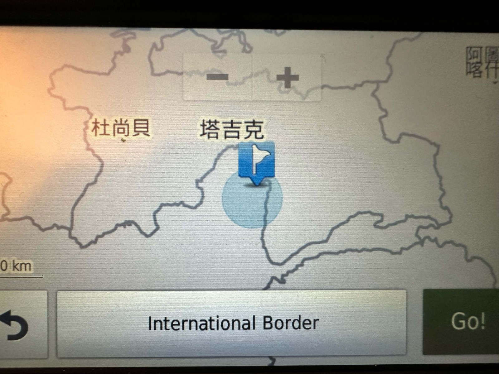

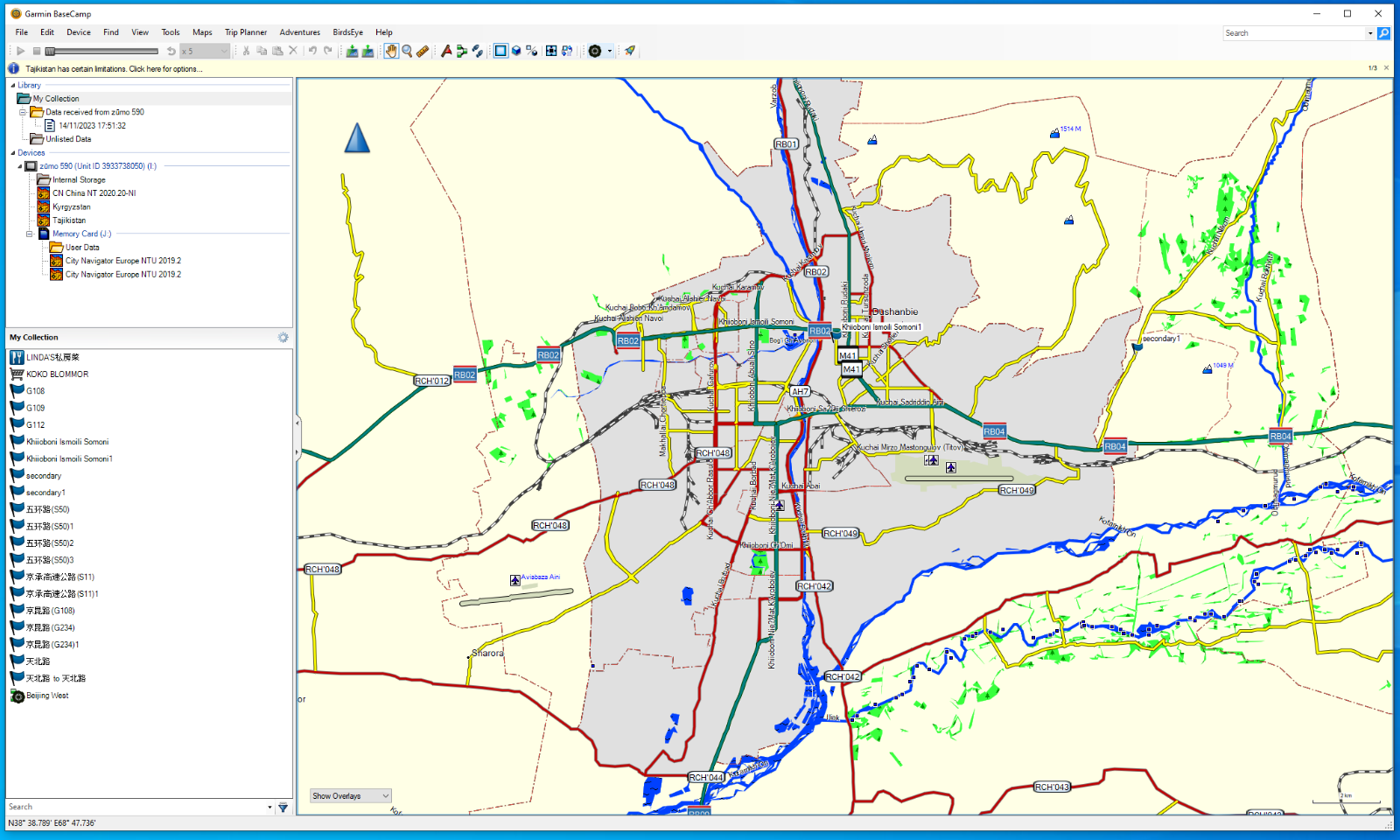

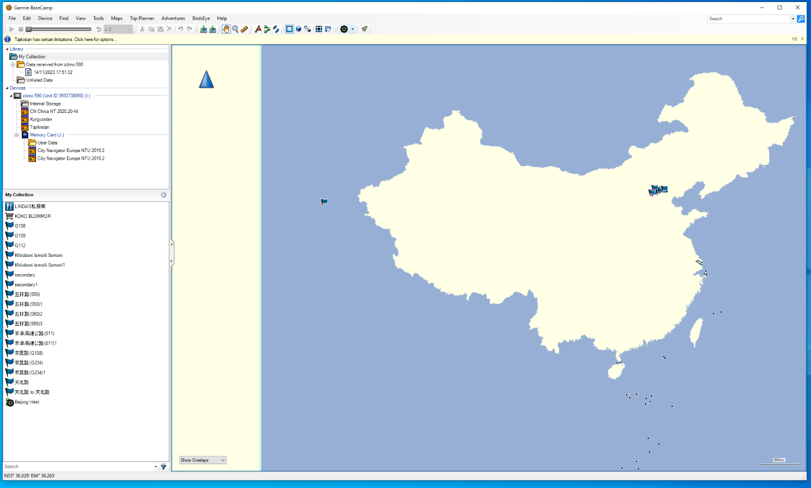

Re: My new (2nd hand) 590.
Firstly, thank you everyone for taking the time to help sort this out.
Hopefully some pictures will help me to explain the issue and make it a bit clearer for everyone.
Picture 1 Basecamp - Shows my device on the left and you can see what maps are installed and where. I am looking at China and am obviously I am zoomed out. Picture 2 Basecamp - Shows a zoomed in view of Dushanbe OSM. You can see that there is detail there so it is not the base map thing. Picture 3 Zumo - The maps on my Zumo have checkboxes but no names showing. Picture 4 Zumo - This is Tajikistan and there is no detail. If I zoom in there is very little detail. I am assuming this is basecamp. Yes, I have checked the boxes that have no names assuming these are maps for Tajikistan OSM and Kyrgyzstan OSM. But no matter what I check/uncheck, I never see detailed maps for those countries on my Zumo.

Thanks for the update and the pictures. I don't know - but I have a question.
How do you know what map Basecamp is showing on the screen?
There is a drop down menu available on the Basecamp menu bar, that you haven't turned on.
From that menu, you can select the map that is showing - including the ones that are on the Zumo
I don't know if it would provide any additional information, but it doesn't help not having that tool visible.
I can't remember how to show it. A right click on a blank part of the menu bar perhaps ? Im not at my PC at present to check.
