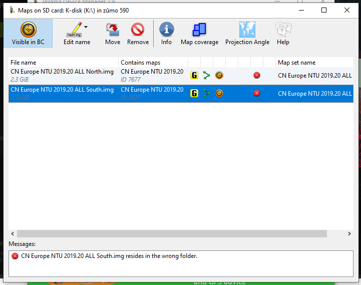

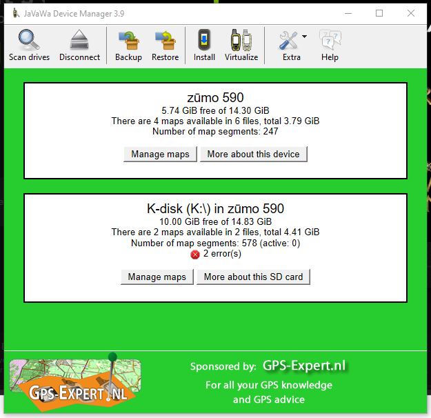

JaVaWa Device Manager can check numerous things on your device, including the name of certain maps displayed on your device and show any errors. Try running it to see what it says about any errors.
What does it say about the name of maps on your device?

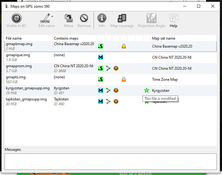

Here are some images from JaVaWa.

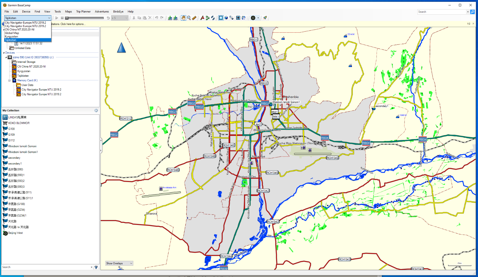

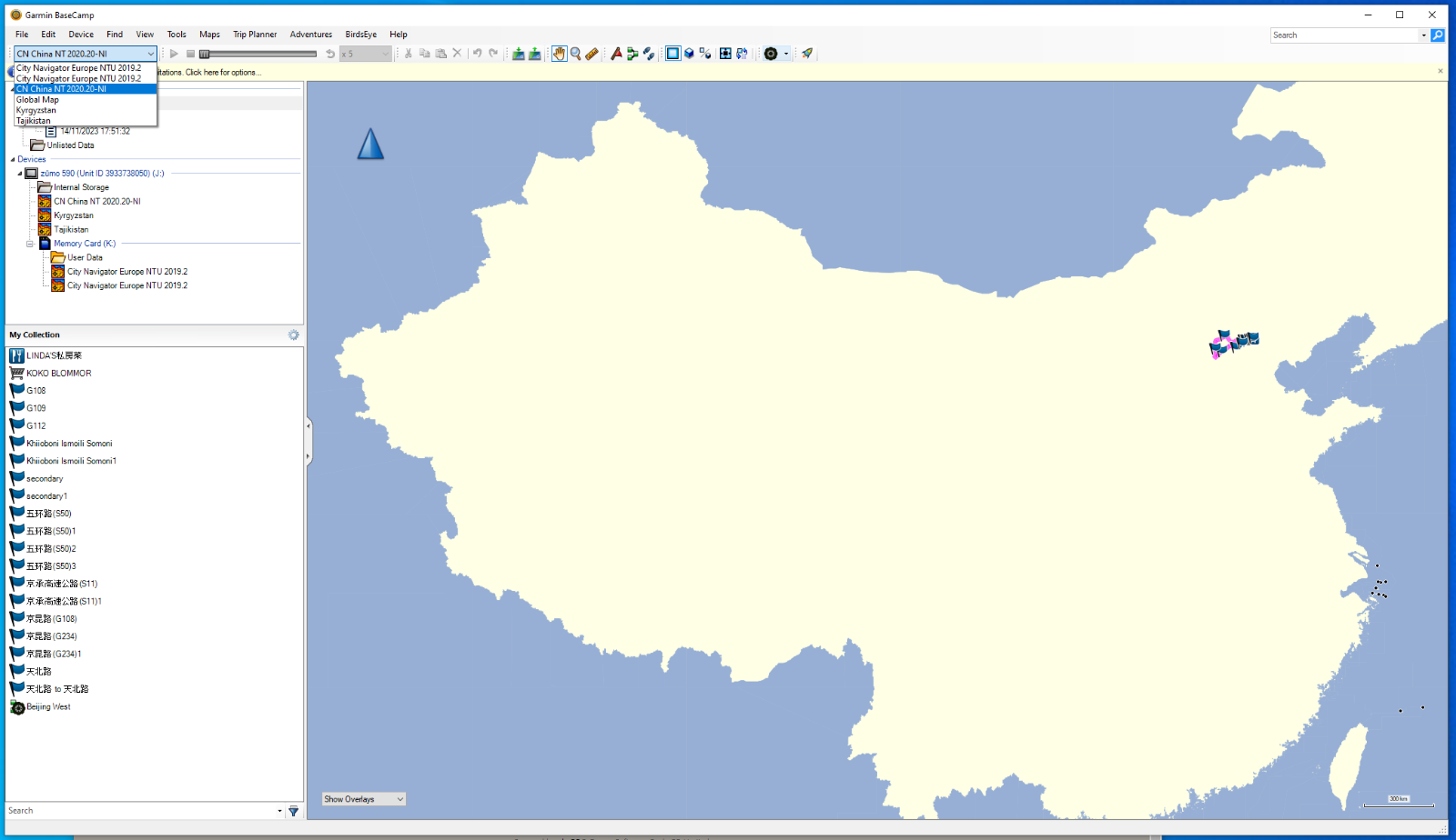

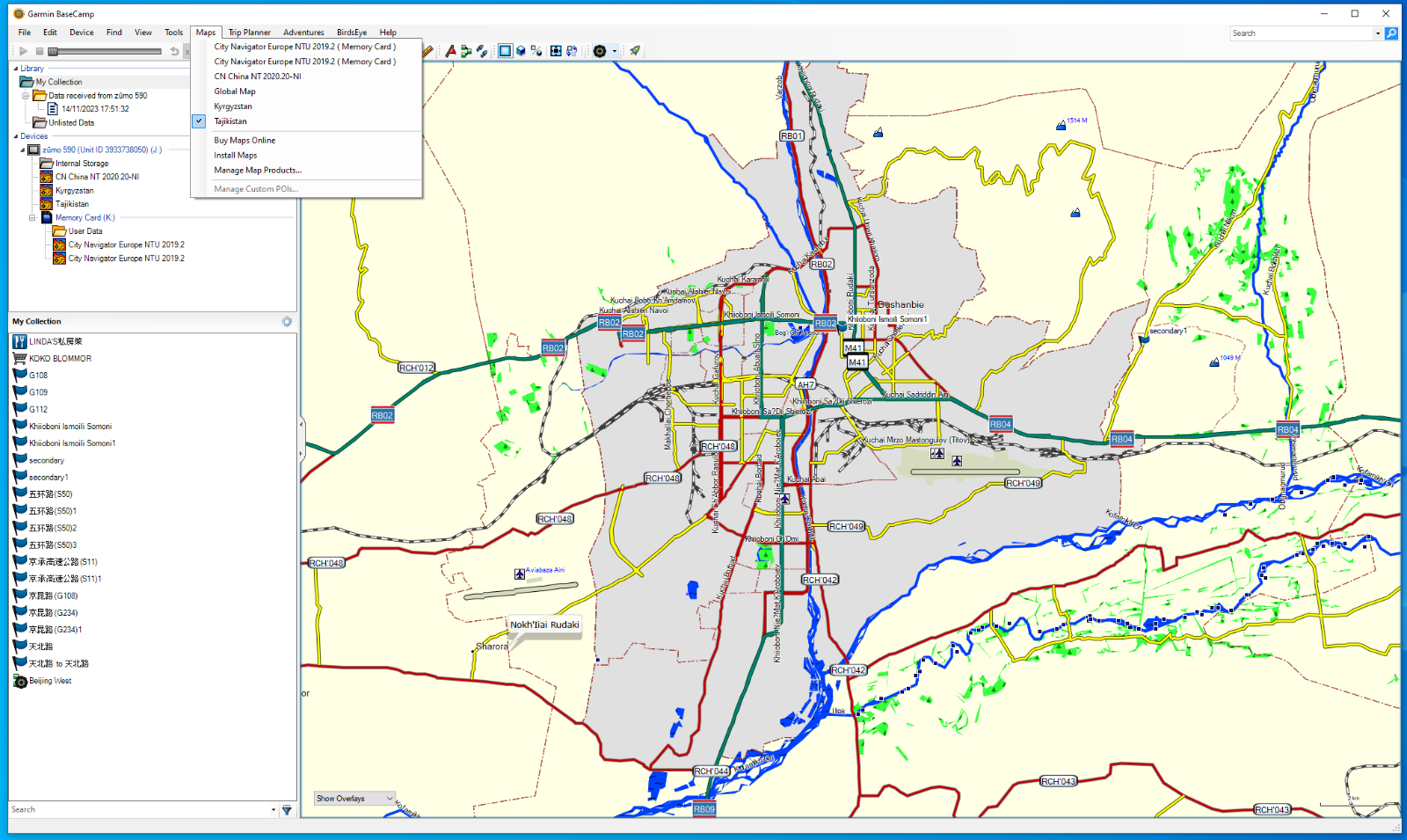

And hopefully I am showing the right screen so you can see what map is being viewed.
Re: My new (2nd hand) 590.
That Basecamp menu is all you really need to see which map is in use or change maps. @jfheath is talking about another option which puts the drop-down on the toolbar. Right-click an empty spot on the toolbar and check the "Map products" box. It is a little more convenient, showing the name of the current map all the time, without clicking. You still need to click twice to change maps.
I'm a bit baffled by the trouble you are having. All I can think to try is to use Basecamp to put the map on the 590, instead of JaVaWa. With the 590 connected to your PC, in Windows Basecamp, you could go to Maps>Install Maps to transfer the maps to internal memory. If that fails, see if the maps can be recognized when installed on the SD card.

OK, I think I have the right screenshots and I am showing the map. If you look at the top left of the screenshot you can see a drop down menu and the map that is highlighted.
I hope I have this right.

jfheath wrote: Thu Nov 16, 2023 6:56 am I don't know if it would provide any additional information, but it doesn't help not having that tool visible.
I can't remember how to show it. A right click on a blank part of the menu bar perhaps ? Im not at my PC at present to check.
Top line select - "View" select - "Toolbars" and select "Map"
Top line select - Maps and it shows to me, what products I have available.
Both of the above without a GPS connected to the Windows laptop.

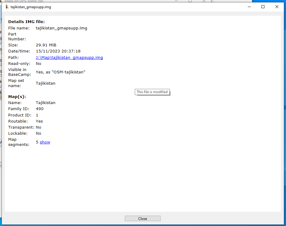

I downloaded both regions, tested them from both my SD card and from internal memory of my 590. They do have some issues. As .img files they do not install in Basecamp, though BC can use them if they are on the Zumo or on a USB stick. Connected to my PC, in BC I could use the maps to create waypoints, and do some limited searches. You may or may not find city names except as part of a business name. Basecamp cannot create a route with these maps, all it produces are straight lines between waypoints.
On the 590, the names on the map list are blank (as you said). I unchecked my other maps and checked both of the blank boxes. The maps display, but the road names do not appear at most zoom levels. Using the 590 Trip Planner, I asked for a route between two waypoints sent from Basecamp and it did appear to create a better route:
