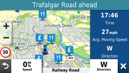

OK - So I went out today, but ran out of time - it had to be the car !
I loaded a track created in Basecamp from a route - using roads that I had no intention of taking. And then transferred the track to the XT.
Loaded the track and selected Go!
The above is typical of the entire 6 mile test. Deliberately off route int he shot above, the dotted line heads for the point closest on the original track. The blue flags are the 'Up Ahead' places which I normally have turned off, but thought I'd turn them on for this test. It also shows favourites as greenhearts - but not in this shot.
Nevertheless the banner remained empty for the entire trip. Note the Off-Course button, bottom right. Easily put in place if it is not there.
This was the screenshot when I fell off the end of the magenta 'Track-Go' - note that the Banner is now telling me what is up ahead !
This is different from my previous observations - which unfortunately I do not have documented (at least I can't find anything).
Aside. Something I said earlier now seems to be incorrect. I said that the calculation was working out which way around a roundabout the magenta line should be plotted. I know that this is what I observed ages back, but this is no longer the case. I plotted the originla route the wron way around on Basecamp. On the XT, no matter whether I selected 'Start to Finish' of 'Finish to Start', for the way I was traveling, it plotted the wrong way round the roundabout. So unless my observations from earlier were wrong, then this is changed behaviour. Not that it matters - the magenta line is close enough since it isn't issuing instructions.
Perhaps my earlier test was for a track converted to a trip, and my memory is confused ? WHatever, - it does not calculate the Track-Go magenta line taking into account the side of a dual carriageway or the direction round a roundabout.
