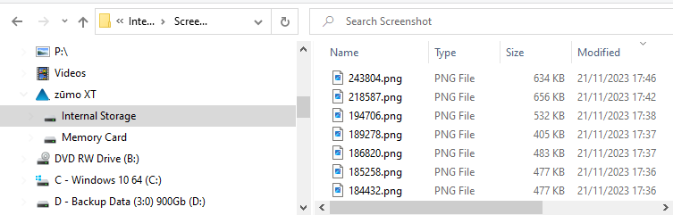

jfheath wrote: Wed Nov 22, 2023 7:00 am
The images are created as .png files (Portable Network Graphic). They are placed as a numbered file in internal storage on the Zumo in a folder called 'ScreenShot'. Goodness knows what the file number means - I've never tried to work it out. The date stamp gives you a clue as to how recently it was taken.
Generally, you cannot view them while they are still in the Zumo. Most graphic programs try to open the pictures to edit them, and on a device that uses MTP - Media Transfer Protocol - opening a file to edit it is not allowed. The XT uses MTP. Picture Viewers - eg Microsofts Photo - may be able to view them. I just transfer them to a temporary file on my PC. Usually I reduce them 50% if I intend to print. 33% is Ok for display on a screen, or 25% if you just want an impression. I use a very early version of PaintShop Pro to do this. I have better graphics programs, but PSP loads fast and is usually more convenient.
One more question, on the screenshots. After I take them, how do I FIND them on the XT? Is it something I need to access via a cable? I'll try this and see if I get anywhere.
Somebody help me....I'm lost! :o
Posts: 3118
Has liked: 429 times
Been liked: 940 times
Re: Zumo XT Route Organization Question...
BradB. wrote: Wed Nov 22, 2023 8:08 pm
Yes - sorry, I assumed ......
Connect the USB cable. Wait. There will be a 25 second countdown to make sure that you want to connect (rather than simpy power the XT), which you can opt to continue witht he USB conenction on the XT screen. Then wait some more until the computer connects. If you are using a PC, you will be able to see the Zumo in File Explorer. It will appear as Zumo XT along with the disk drive(s)
If you have a Mac, then there will be something very similar, but never having owned one, I cannot help. See the computer screenshots below showing the sequence:
