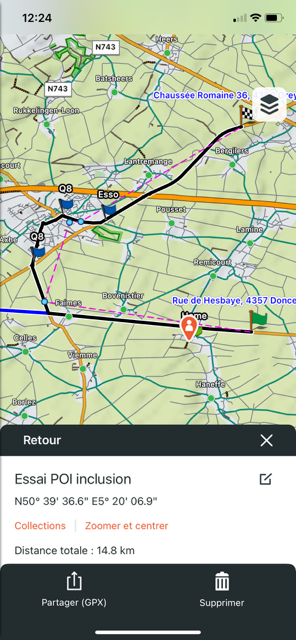

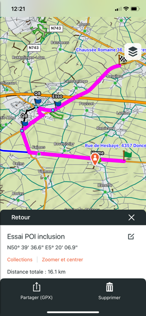

Hereafter, some pictures to illustrate the above post: initial very simple road test from MRA (road with 3 POIs that are shaping points), copy of the road in Tread just after import and after recalc on the XT2, corresponding gpx test file from MRA.

My major concern is the mod of the shaping points. The last route is not straight lines on the XT2 as on the Tread but it goes through the modified shaping points...

Javelin16 wrote: Fri Jan 12, 2024 11:07 am even if I delete the Tread app on my phone, could any recalculation on the XT2 corrupt the transferred gpx?
In theory yes. A route consists (maybe) of a few shaping point and via points - which the route must pass through. Explore (and I assume Tread, since it uses the same database), does not have shaping points or Via Points as part of its route. It doesn't even have Waypoints as a part of the route.
The only way you can get a track / route to be transferred to the XT is if it is sent as a plot of the actual route - using a lot of closely spaced invisible lat/long points. These are fixed in position on recipt by the Zumo, but there are a lot of things that could make the route recalculate (edit the route, deviate from the route, traffic, .....)
With 'Track Trips' the XT gives a warning that if you edit the route, it becomes a normal route and it will find a way to get you to the end. The thosuands of closely spaced coordinates that hold the route in place are all lost. All it can do then is calculate a new route, but it only has the start and end points left. Fastest roads, motorways here we come. The same happens on a normal route - except on a normal route, it still has to pass through the Via and Shhaping points.
There are lots of things that will make the route recalculate. It used to be if the maps on the Zumo were different from the maps used to create the route - it would recalculate as soon as it was transferred. Original route lost. But again changing routing preferences, changing vehicle mode, deviating from the route, pressing skip, editing a route point. I don't know how much of this applies to the XT2 or to routes produced in the Explore database. I have never actually ridden one. I've sat at my desk to see what happens and documented it in that link that I provided.
But what you have said, and the examples and gpx files that you have provided - none of that comes as a surprise to me. A route on the Explore / Tread database has lots of points to keep it in place, but they can get wiped out in so many different situations. Its up to you to find out how to prevent it from doing this. The most obvious is to prevent recalculation (but I don't know if that applies to routes/tracks form the Explore /Tread database).
