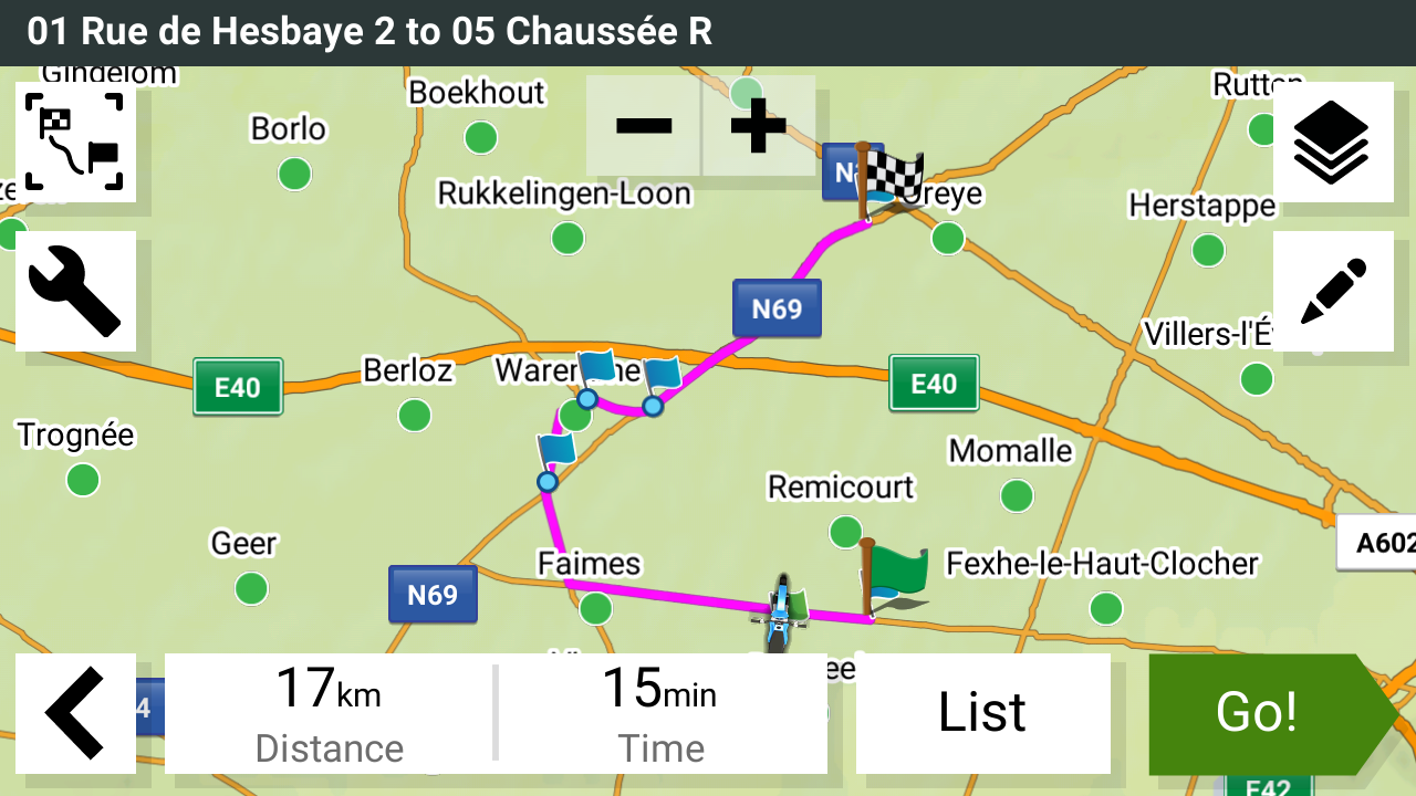

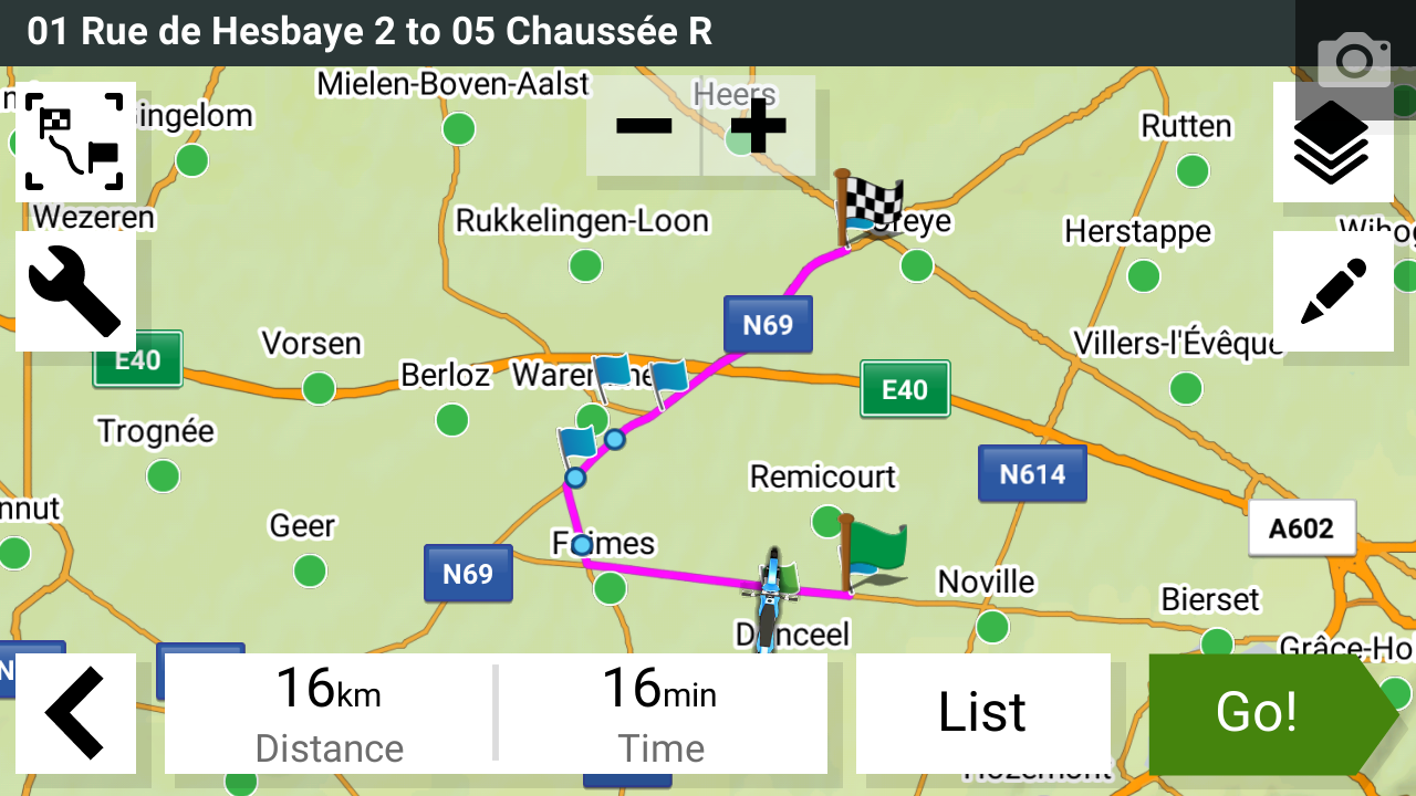

I don' fully agree with that. If you look to my first screen copy above, it shows that the route in Tread (explore) has the 3 shaping points (small bluepoints) at the right place at the POI as on the original MRA route and that the road in Tread goes through them.
After recalculation on the XT2, 3 shaping points are still there (bluepoints shown in the second screen copy) and the road still goes through them in fact...BUT the position of the 3 shaping points on the map is altered during the recalc process! That is what I call "corrupted data". I can fully understand and accept that lots of points of the route which are not via or shaping points get wiped out in a recalc process but not that shaping points are moved...
jfheath wrote: Fri Jan 12, 2024 3:03 pm The same happens on a normal route - except on a normal route, it still has to pass through the Via and Shhaping points.
This provides at least a mean to have a certain control on the recalculated route and on the shape of the initial route, right? But, if the shaping points are moved in the recalc process, what control can we keep on the route? For me that is a fault in the software that corrupts the initial data.

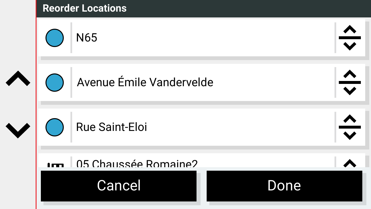

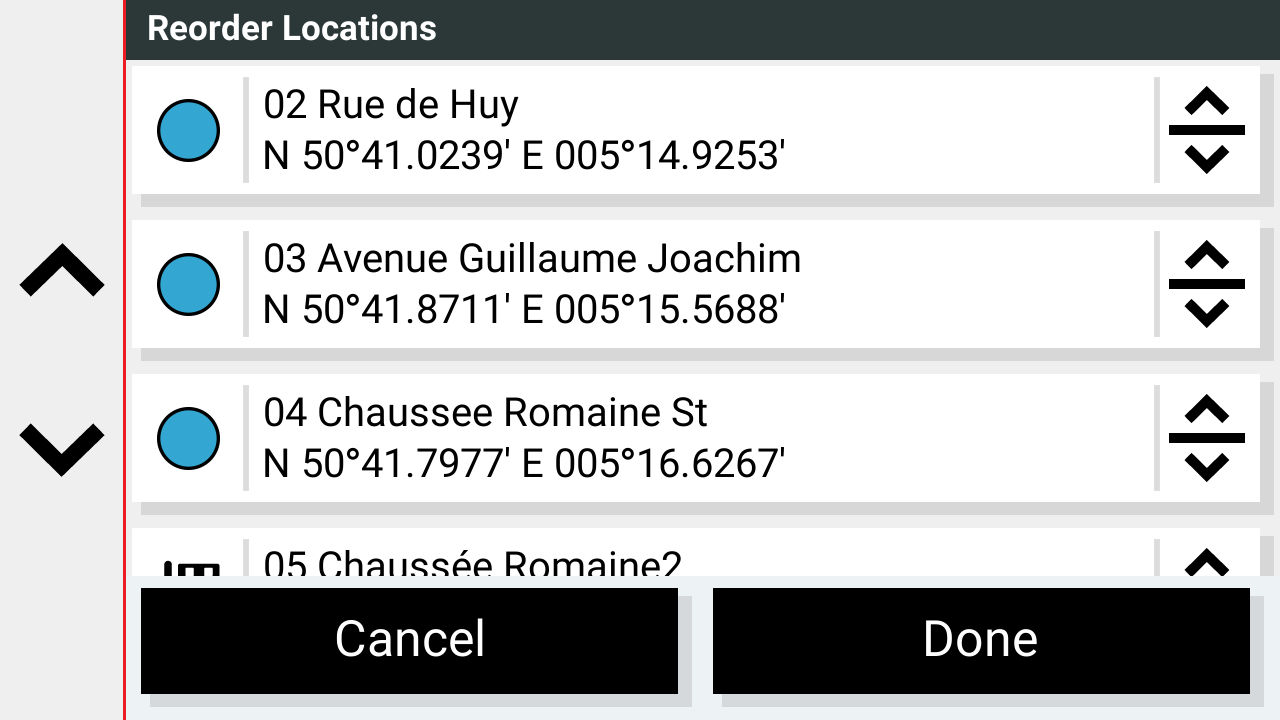

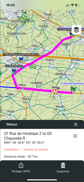

First results from this. The steps I followed were as recommended and described below:
1. I create 5 WPs in basecamp, corresponding to the previous one. I rename the WP with a numeric suffix corresponding to the order of the WPs in the projected roal. I create in BC a route through the five WPs.
2. I define the 3 intermediate WPs as shaping points using the "won't alert" option in BC. Copy of the screens in BC is given in the pdf file hereafter:
Essai Inclusion WP BC.pdf
(210.04 KiB) Downloaded 601 times
The corresponding gpx file with the route and the WPs:
Essai POI inclusionMRA.gpx
(15.04 KiB) Downloaded 571 times
3. This file is copied in the GPX folder of the internal memory of the XT2 (using Windows explorer).
4. The route is imported on the XT2. Corresponding route in the db explore of the XT2 is as follows immediately after import:
5. A sync is done automatically with the Tread app. The route from the explore db in Tread is then as follows:
6.After the sync the route on the XT2:
Similar results as for the route generated in MRA. Just after import on the XT2, perfect results (3 WPs, 3 shaping points at the correct location, good route). After sync in Tread, alteration of the basic data ( 1 WP lost,2 shaping points location changed, 1 lost and consequently, route modified). This sync alters also the data on the XT2 (3 WPs ok, 3 shaping points moved, route modified), all this without using the route in Tread and thus simply from the sync between the XT2 and Tread.
Data transferred to Garmin support. To be able to request an eventual investigation from their engineering team, Garmin requested only Garmin data, which I can understand.

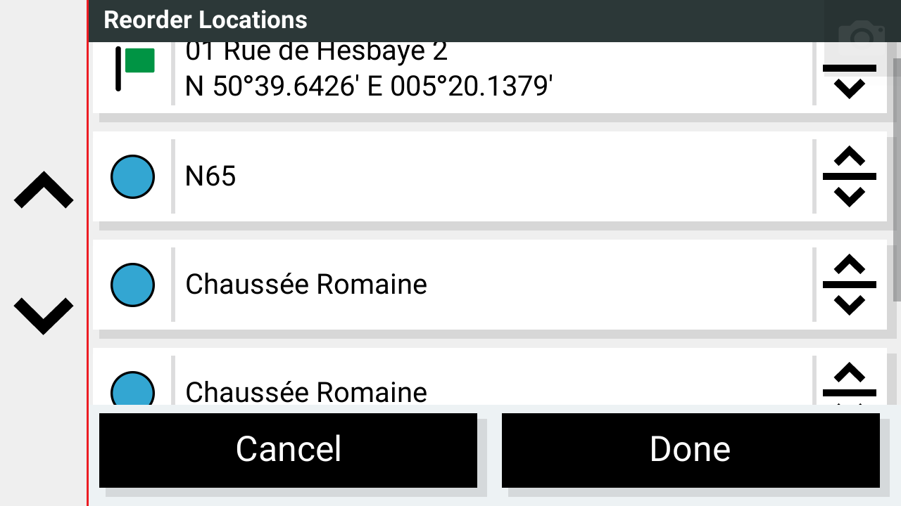

jfheath wrote: Sat Jan 20, 2024 12:43 am So I guess that in Tread, which from what I have read, accesses the Explore database, that the route is being processed as described in section 1 of this answer. Making the route plotted as straight lines, fit the roads on the map.
The waypoints are probably undergoing lookup checks to see what is near the coordinates. Maybe being moved 'Oh he meant Sainsbury's car park' sort of thing.
In fact, the waypoints are in the explore DB of Tread and they are exactly the same as in Basecamp (same long and lat).
What is altered after the sync with tread are the shaping points of the route.

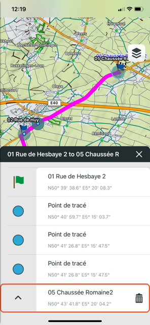

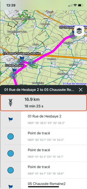

A closer look at the shaping points of the road reveals this:
1. Just after importing the route on the XT2, the shaping points are identical to the shaping points in BC (same name, same long and lat coordinates).
- shaping points in BC:
Coordonnees shapingpoints BC.pdf
(107.96 KiB) Downloaded 670 times
- shaping points just after import on the XT2:
2. For the route in explore db of Tread, there are still 3 shaping points but they are altered:
The name and the coordinates are changed. What is strange is that now shaping point 2 and 3 are at the exact same location. I think the suggestion of jfheat is close: it looks like the shaping points are relocated on the fastest road close to their original location! By the way, in the explore db of Tread, the waypoints are not altered (separated entities as always in the Garmin logic).
3. Now, here are the shaping points on the XT2 after the sync with Tread:
Now, as in explore, the name of the shaping points are changed and the coordinates are no more associated with their name. What is strange is that the shaping points differ from the shaping points in the explore db of Tread (again 3 distinct shaping points with a new location for the first shaping point). As suggested, the logic seems very fuzzy. But, I don't like to follow "fuzzy" routes when riding. I was trying to give a chance for keeping Tread active but it seems hopeless. I'm afraid that your suggestion of a development of a marketing app, with no more rigorous logic and principles, like always keeping via points and shaping points, to please phone screens lovers is delivered by Garmin. Fine if other people like that. But having access to some new interesting properties like weather or traffic infos should not be at the price of "fuzzy" routes that a lot of drivers will hate.
Up to know, the link with BC is still effective, even if each time the XT2 is connected an error message is shown in BC telling that the XT2 is not officially supported in BC. Hopefully, the effectiveness of the link will be kept by Garmin in the future, which I doubt personnally.
It becomes a difficult game with the Garmin new logic: the content of the explore db in Tread is not consistent with the initial content of the db of the XT2 after the sync of the imported XT2 route. Then after the subsequent sync of the XT2 db with the explore db of Tread, the content of the synced db are also not the same! To complicate for me anyway. I will delete the tread app from my phone...

AugustFalcon wrote: Fri Jan 19, 2024 11:14 pm I would like to see this same route imported to an actual Tread device to see if the errors would reoccur.
Here it is. The same route, but first imported in Tread and subsequently, available on the XT2 after sync and recalculation of the route...
1. gpx file of the route imported in Tread. The waypoints are again ok (in explore; one waypoint missing on the map in Tread). The shaping points are less alterated but the name are lost, the coordinates are not the same as in BC (see above for BC). Again, it seems that the shaping points are relocated on fastest road nearby (to a lesser extend for the second shaping point).
The route is modified by Tread since the shaping points are changed.
2. The route on the XT2. When the route in explore on the XT2 is open, error message as already shown in several posts on the forum:
If the option recalculate is chosen, the route on the XT2 similar to the route in Tread but the shaping points are again modified (see the second shaping point hereafter):
Again, for me very strange logic difficult to understand. I cannot rely on that.
