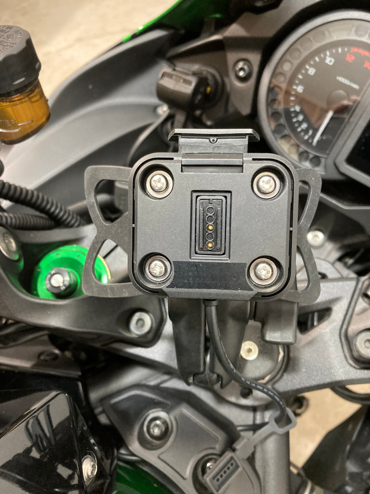

I always pull on my XT after putting it in its mount to make sure that it is seated properly in the top and bottom grooves. I cannot see any way, short of damage that the unit can bounce out. The clip holds the XT in position against the mount. In theory an upward bounce could put pressure on the clip to release it, but In practice that is not possible. There is a square moulding around the electrical contacts which prevent the XT from moving in any direction once it is clipped in.
I've read that some people have done something to make the contacts press more firmly against the rear of the XT. I wonder if this pushes the XT away from that square moulding allowing any force from a bounce to be transferred to the clip, thus allowing the clip to give way.
Clearly it has happened to people, but it is impossible to say after the event whether or not it was fitted properly in its mount.
I would be wary of mounting it so that the top is close to the screen, or reaching over the top of the Zumo when riding. Long RAM ball mounts are also best avoided if mounting close to any other item. They flex more.
A common location for a mounting place seems to be between the bars in front of the fuel tank, which makes access to the ignition key awkward. I have my 590 mount located there. It occurred to me how easy it would be to partially release the XT catch and when turning the ignition on/off, if had put the XT there instead. My XT is mounted to the top of the dash, behind the screen on the left hand side.
But just for the peace of mind, a tether would be a useful investment.

Looking at this again today, I am still befuddled that a 2A USB charger (2A x 5V= 10watts) would not provide enough power to boot the dead XT, but on the 13.6V power supply, the XT started just fine while drawing only 0.42A, or 5.7 watts of power.
Just an amateur guess, but I wonder if some of the other pins in the bike mount supply something that helps "wake up" a dead battery?
There are only two pins in the mount: +5VDC and ground.
I plead senility. ;-) I guess I was thinking of my old 660 mount.

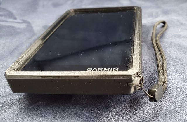

When I bought a 3D printer and was looking for a project, I found a soft "bumper" for my XT, which provides some protection in the event of a drop, and also improves my grip on the XT to prevent a drop in the first place. It included a hole to add a tether but I never bothered to do so until my wife was throwing out some device which had a tether. I still don't think it is really necessary, but being able slip it over a wrist if my hands are full is sometimes handy. On the bike, I slide the loop over the mount, to keep it from flapping in the wind and to hopefully snag on the mount if the XT releases itself. Similar bumpers (with tether) can be found by searching for "Zumo XT bumper case".
