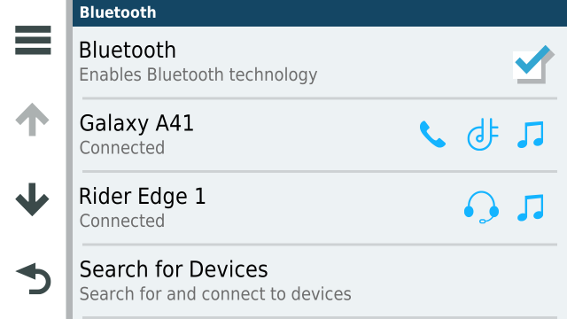

Eg - This is a screen shot of my XT having paired with my phone (Galaxy A41) and my Cardo Edge headset (Rider Edge 1).
The symbols in blue are the features that are available on each device. If they are shown in black then that feature is not connected.
By selecting and item (eg Galaxy A41) I can break the connection for individual features. Eg - If I don't want the music to be active from the phone over BT.
This screen also makes it easy to diagnose a problem because it shows you exactly what is connected and what isn't. Sometimes it is necessary to unpair a device and pair it again - if a particular feature was not connected in time when it was first being paired. Genrally, the XT conencts first time every time with devices that it is paired with. If it doesn't then it is usually to do with a device having been paired before with something else, and it found that device first. That is a common probelm when trying to set it up in the house. The solution is to do it away from other devices, or to go round turning every other BT device off so that the XT and your other devices can establish a proper conenction.
