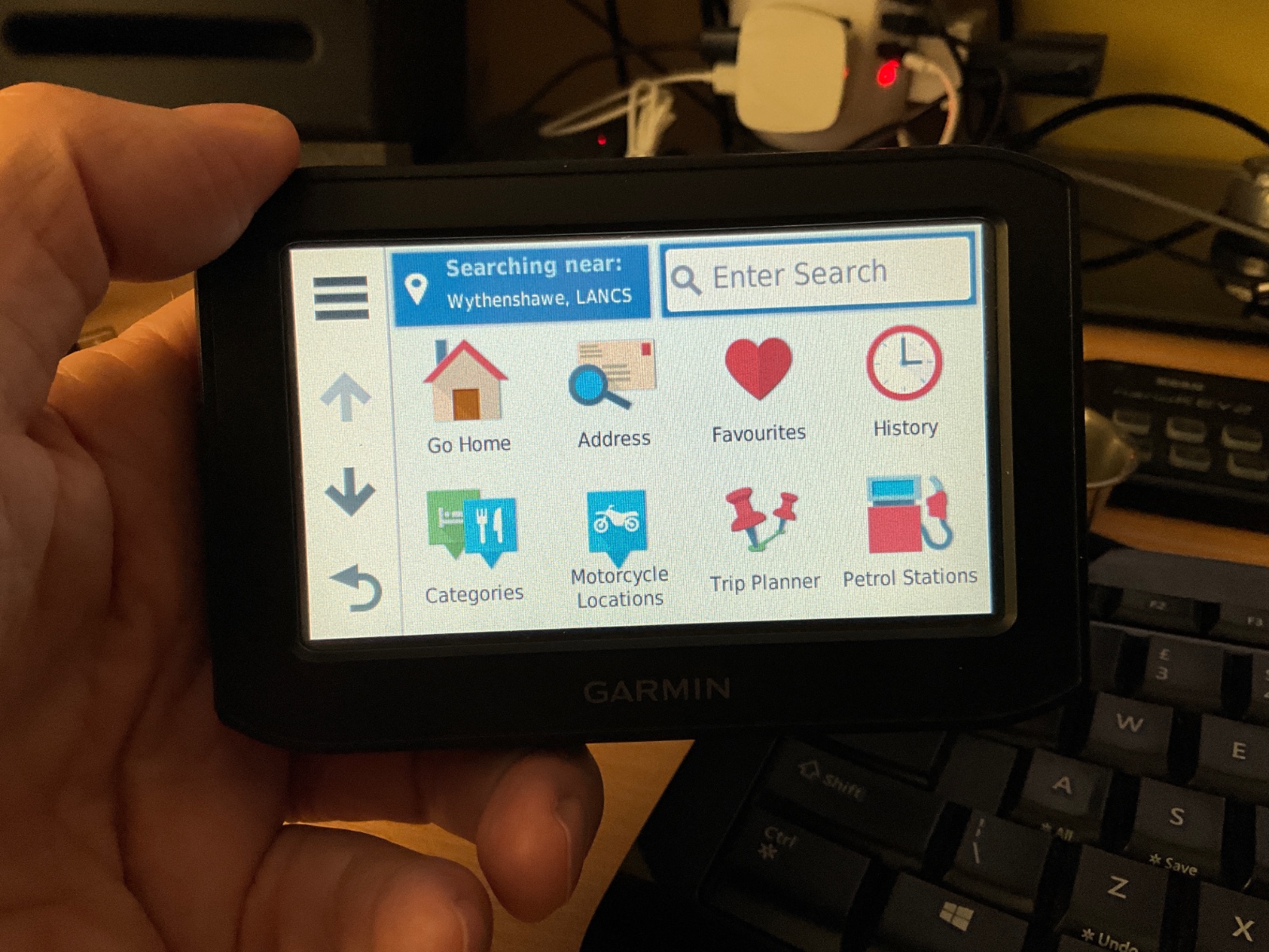

Here's what I tried on my 396 this morning. Map is CN NA 2025.10, USA and Canada, device firmware is up to date.
I tried Where To. Selected search for a City. Entered a city that's about 80 miles away. Search results showed that city first and then others with the same name in other parts of the USA. Selected the first city and a route to that city was planned.
I tried Trip Planner, add a trip. Add a destination, left the starting point alone, and searched for the same city. I got the same search results and selected the first city. I got a route and a 2nd option to select a shorter distance, longer time route.

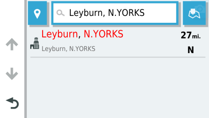

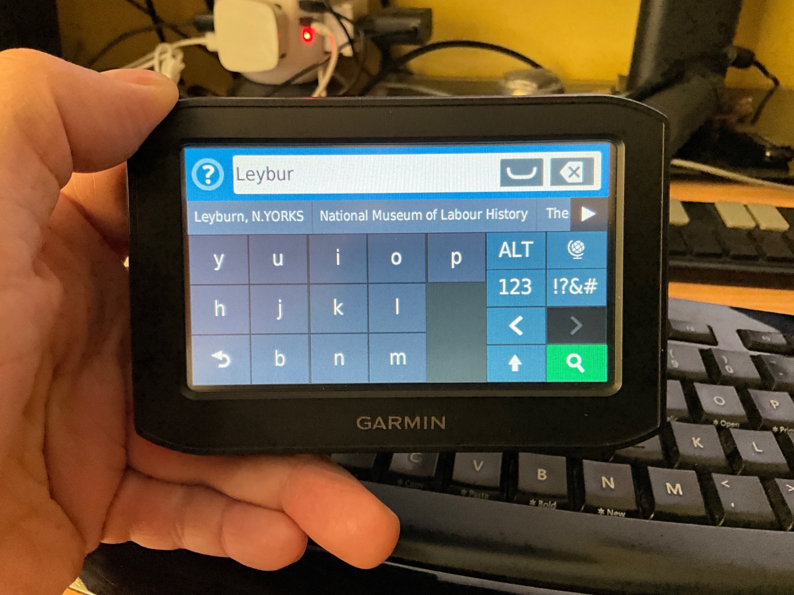

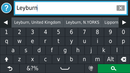

Now I remember it took me ages to spot this particular feature. But as you type in L --- E --- Y ---- B etc there is a scroll bar displayed above the keyboard which displays likely candidates. This form the XT - I had to scroll left/right with the pointers. I then selected Leyburn, N. Yorks from that banner. It found the correct one, and kept the correct one.
If I select the green magnifying glass, bottom right, then the Zumo searches its database for whatever you typed. I don't know, but this seems to be getting the data from elsewhere. FourSquare is the database used on the XT and that seems to cause all sorts of issues at different times for different people. But if you scroll across the alternatives, and choose Leyburn, N.Yorks from that by tapping the word on the scroll bar - that seems to behave much better.
In the above, note the little tear drop icon to the left of the white banner. This is another button that is hiding in plain sight. It presents itself in different forms on different Zumos, but it is still there. On one of mine it is accompanied by the caption 'Searchin Near'.
And that is exactly what it does. It tells the Zumo where it has to search for whatever you are typing in.

MSTOCK27370 wrote: Thu Apr 04, 2024 1:36 pm Here's what I tried on my 396 this morning. Map is CN NA 2025.10, USA and Canada, device firmware is up to date.

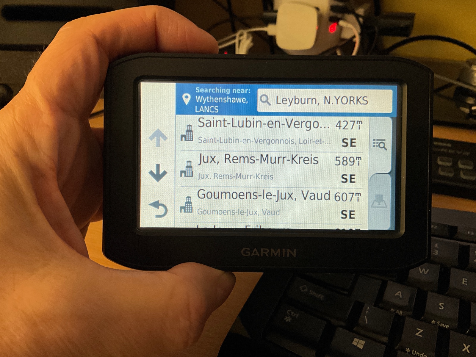

Thanks lots. So i tried a v simple search this time. Clicked the ‘where to?’ Icon, then entered Leyburn straight into the white search box on next screen (hopefully the image attachment works!)
It then finds the place as i’m typing so i select the correct place ‘leyburn, n.yorks’…
And the results are wrong…
Clicking the ‘searching near’ button as you suggested doesn’t make any difference unfortunately :(

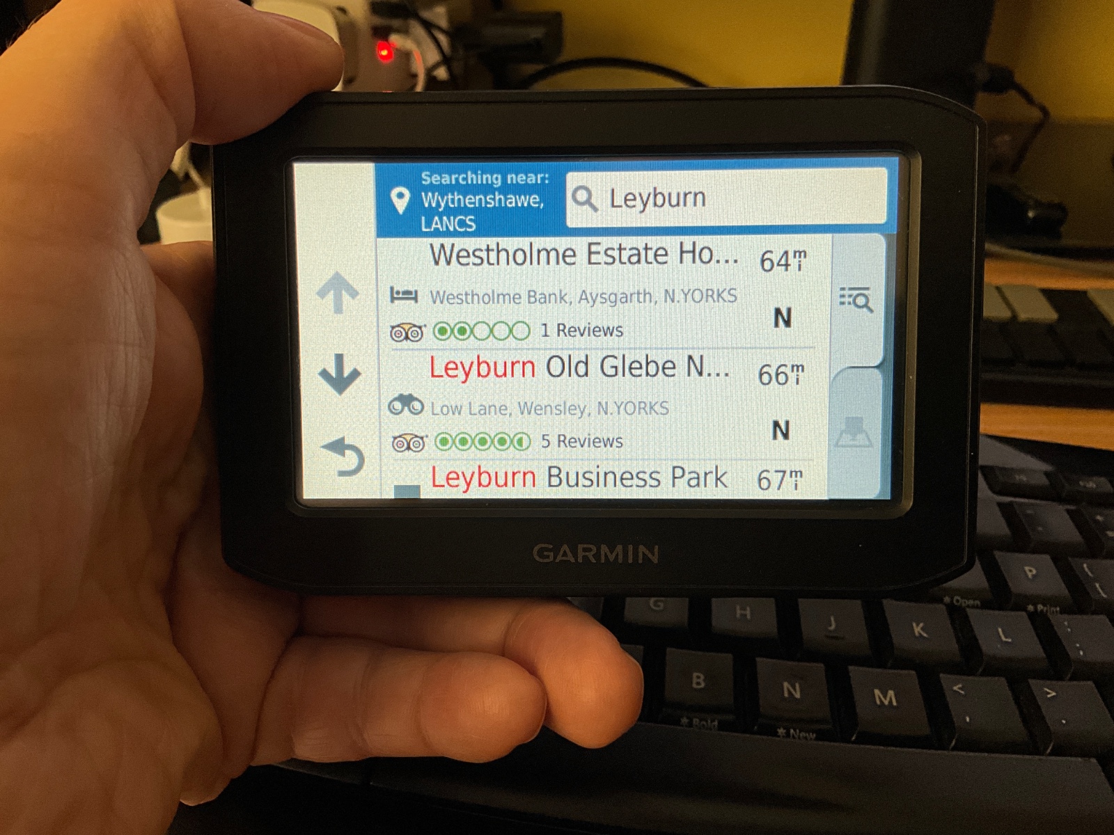

Hmmm. Just experimented with the green search button. If i type in ‘leyburn’ then don’t click on the suggested ‘leyburn, n.yorks’ option below it but click on the green/white magnifying glass button instead, it seems to display POI results around the correct leyburn - just not the town itself. Weirder and weirder…

You search for a location eg Leyburn
You select the Leyburn N.Yorks from the banner
The Zumo gives a list which does not include Leyburn, N Yorks, but does give Leyburns in other countries.
Is that correct ?
I note the screenshots have a search criteria. Can you change that to a different location or Where You Are now, see if the behaviour changes.
Is that correct ?
Text and keyboard language settings both on British English.
As to your recap - correct except the results don’t show any leyburns at all. Just totally different named places in different countries with no apparent similarity.
