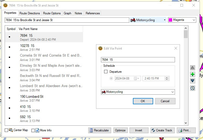

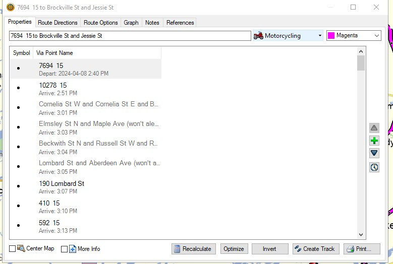

I'm attaching 3 screen caps. The first is the list of points. You can see that they are grey, but the title says that they are via points.

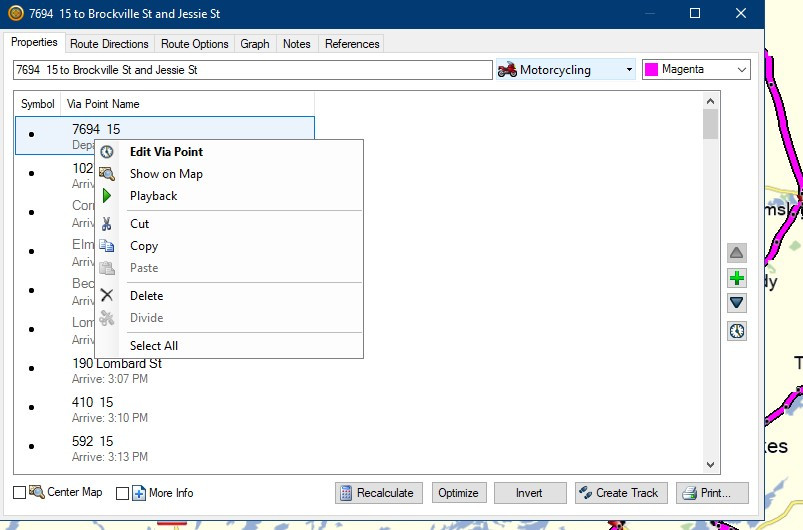

The second shows the window when I right click on one of those points. You can see that the list does not include changing from one kind of point to the other.
The third shows what I get when I choose "edit point" from that list. Again, I cannot change it.

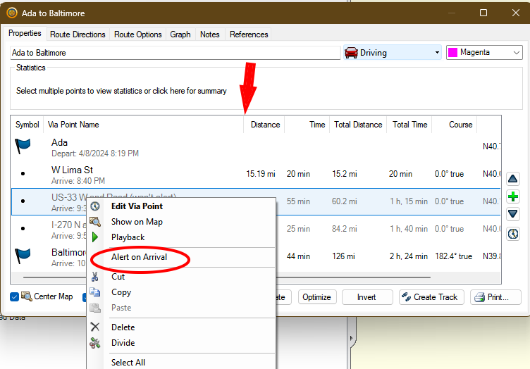

The Start and End Points are (alerting) via points by definition - you cannot change them to (non-alerting) shaping points. A right-click on the intermediate points will show the option to toggle the alerting status.
Your display is missing a lot of info about the route points. If you click and drag the line the arrow is pointing to you can move it to the right to see the complete name and alert status. Or right-click that header bar to reset it.
Re: Basecamp and via points/shaping points
In Basecamp, the only way to tell whether a point is a shaping point or a via point is in that dialog box that @lkraus has shown.
Via points are in black lettering. The points alert on arrival.
Shaping points are in a lighter, grey lettering, These say (won't alert..)
The symbol used does not mean anything.
On the XT, Vias are shown as flags. Shaping points appear as small blue discs.
Note that the heading on that dialogue box says 'Via Point Name'. Ignore that - the table contains Via and Shaping points. I think that is something that was carried over from Mapsource - Basecamp's predecessor which used only Via Points. It was never corrected.

Ignore the title. Trust me.
gwilki wrote: Mon Apr 08, 2024 11:14 pm The second shows the window when I right click on one of those points. You can see that the list does not include changing from one kind of point to the other.
The first and last points, called "the Start" and "the Destination" points are always via points and cannot be changed. Follow the instructions you were given for every point between theses two.
gwilki wrote: Mon Apr 08, 2024 11:14 pm The third shows what I get when I choose "edit point" from that list. Again, I cannot change it.
Don't do this. Simply right click a point and select as pictured above.
