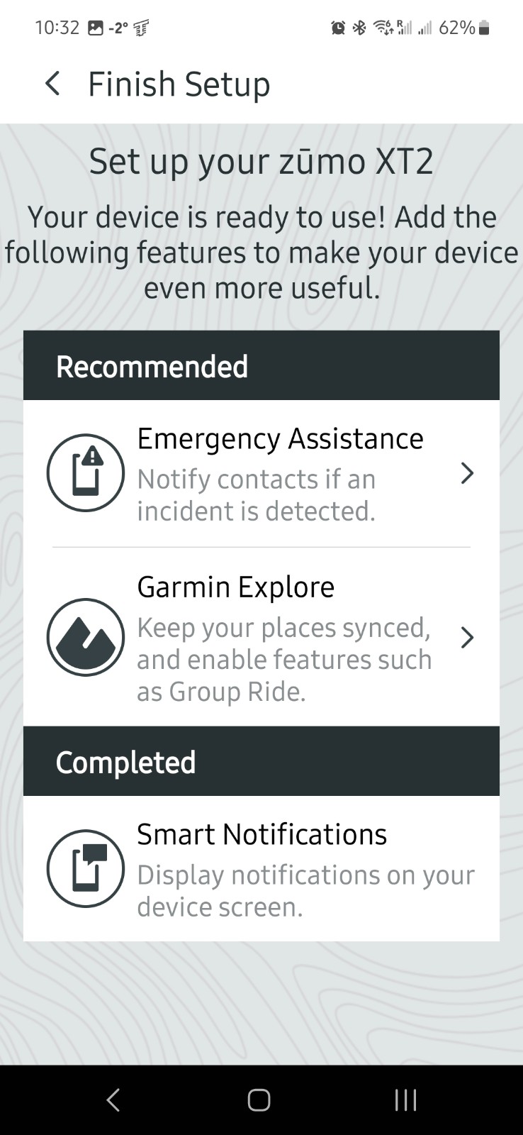

Just curious Technoguppy as I might be missing something here. You say "I can assure you I didn't make up the screen shots. They are real"
I must be blind or something as I can't see any option to not synch the data to the tread app from locking at your screen shots.

To see this setting, the Tread App and the XT2 must be connected to each other. This might be your situation. When your phone and unit are paired, go to Settings --> Devices --> Zumo XT2 --> Finish Setup. You should see the screen shot as shown below.
Where you see "Finish Setup" at the top of the app screen, you then see under Recommended another setting "Garmin Explore" which offers to "Keep your places synced, and enable features such as Group Ride". I have NOT enabled that feature. I believe this is the "feature" that Garmin uses to sync data between the Tread App and the XT2, which then ultimately mucky mucks with your pre-planned (BaseCamp) routes. You can see that it is under the category Recommended and not Completed.
Hope this helps.
NOTE: I suspect that once you enable Garmin Explore, there is no UNDOING it. You would have to uninstall the app from your phone (reboot it), factory reset your XT2 completely and rerun. I truly believe (but have not tested the theory) that once you enable it you're stuck with it. Tread lightly (pun intended).

Thanks for the reply to my question Tecnoguppy.
