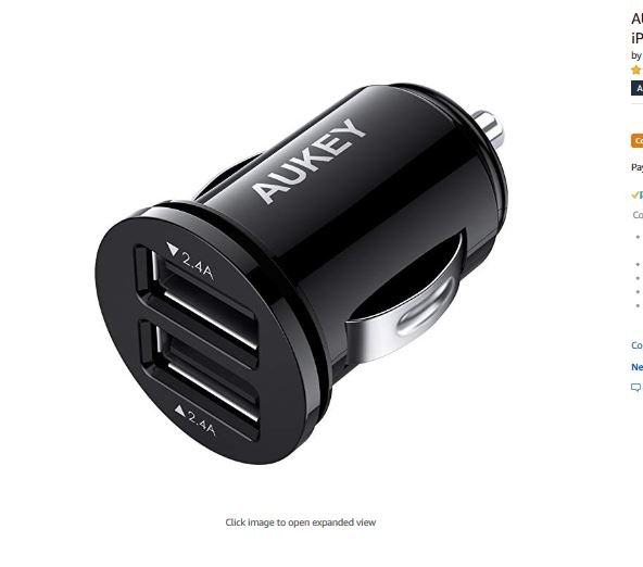

I think that configuration will work fine particularly b/c the cigareete socket is (as you describe) inside the tank bag. I'd change one minor thing tho- instead of a cigarette lighter socket to usb cable I'd use a 2 usb adapter in the socket and use standard usb cables. Small velcro straps are your friend for such things so longer cables can be used (reasoning follows). Then I could keep my phone charged inside the tank bag as well, charge my mp3 at stops, etc. Plus, with a simple 2 usb port wall outlet, the same cables could be used in a motel room as well, hence the need for longer-ish cables.
Look for something like this, pay attention to your usb power needs of your devices.
usb adapter.JPG (25.38 KiB) Viewed 25346 times
