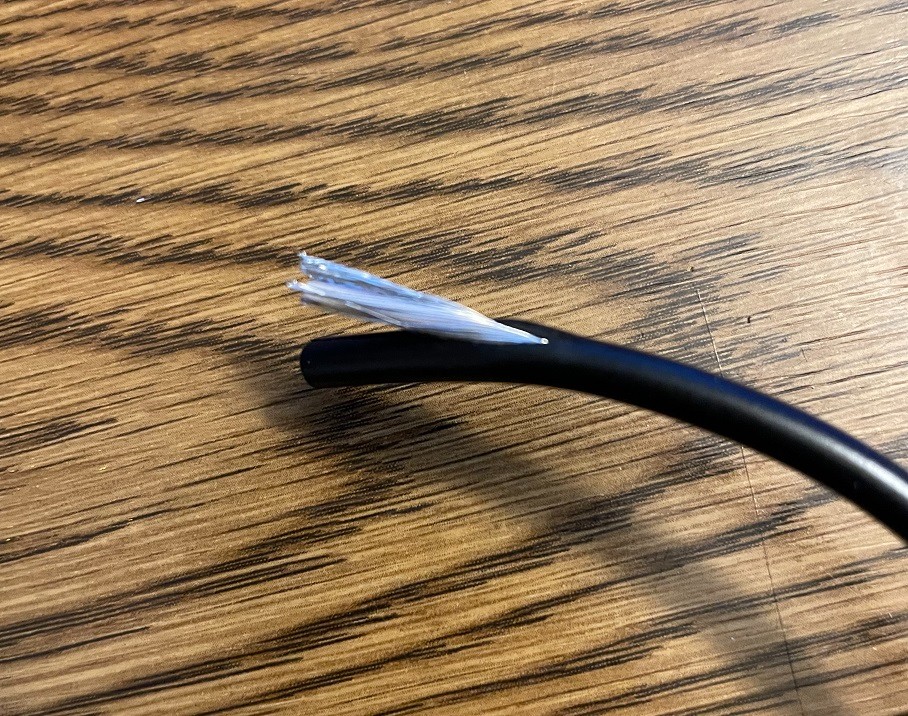

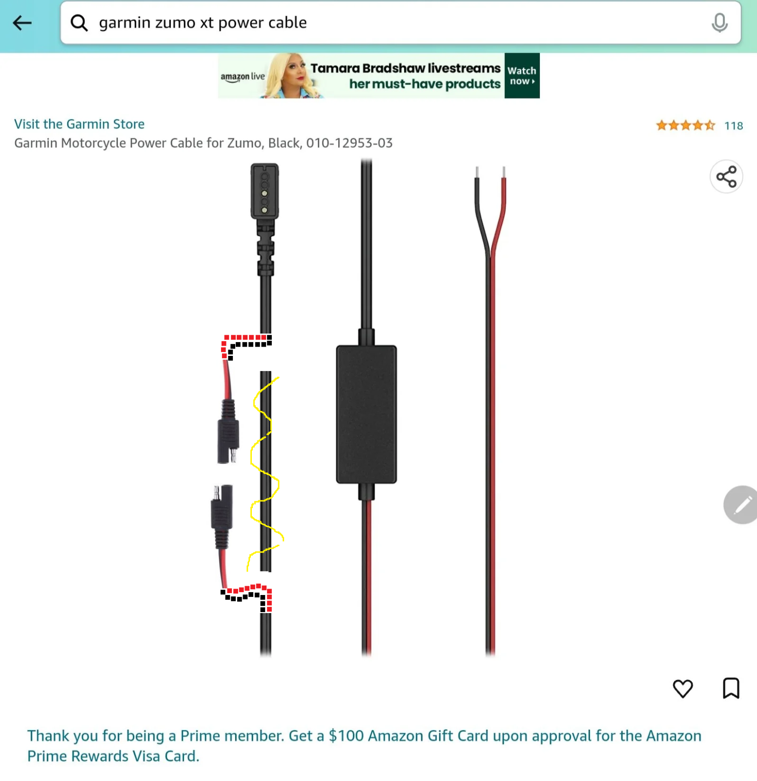

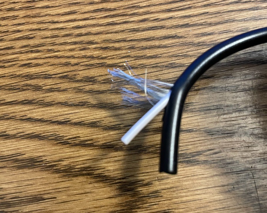

So I am not an electrical-minded person, but not unintelligent, so I attempted to modify the Zumo XT power cable only to fail and ended up purchasing a replacement. However, since I am still in possession of the currently ruined cable, I thought maybe someone here in this forum could possibly help me to what I had originally set out for.
I want to hard wire the power cord with the supplied ring connectors to the motorcycle battery and run the cable underneath the outer fairings up to the mounting bracket which attaches to a 1" ball joint mouthed on my fork stem. I won't use the Garmin each time I ride, nor is it the only device that I commonly mount to the ball joint. For that reason, I don't want to leave the Garmin power cable hardwired and permanently connected all the time - I want to be able to connect and disconnect it when I need it.
My thought was this: In the picture I hope to attach, you will see the standard Garmin power cord as advertised on Amazon and posted by another user. I have illustrated the image to show how I had HOPED to snip the power cable close to the cradle, and insert the 2-wired (red +, black -) SAE cables easily available online, and this would allow me to leave the bulk of the Garmin power cable connected to the bike and under the fairing, but to also quickly disconnect the end of the cable as desired so that I can use the ball joint for other accessories (phone, camera).
HOWEVER....
When I cut the cable and split out the wires inside, I was expecting to see two wires (again, red +, black -) but instead found a bunch of fine wires surrounding another central plastic shielding, which in turn had a bunch more of the same type of loose silver colored wires. I have no idea what the outer wires are (+, -, ground?), nor what the inner wires are (+, -, ground?) , whether its possible to connect these to the SAE pigtails, and if so, how.
Can anyone give me a hand here?
HOWEVER....

Re: Zumo XT power cable
I split my XT power lead to instal a dashboard switch, so that I could switch the XT on and off independently of the ignition. Definitely just the two leads.
I have done exactly what you are trying to achieve and installed a waterproof connector. The co-ax is the negative and the wire inside the white sheath is positive if I remember correctly, you can test the continuity with a multi-meter to determine positive and negative. I used Posi Lock connectors offset to minimise the profile.
