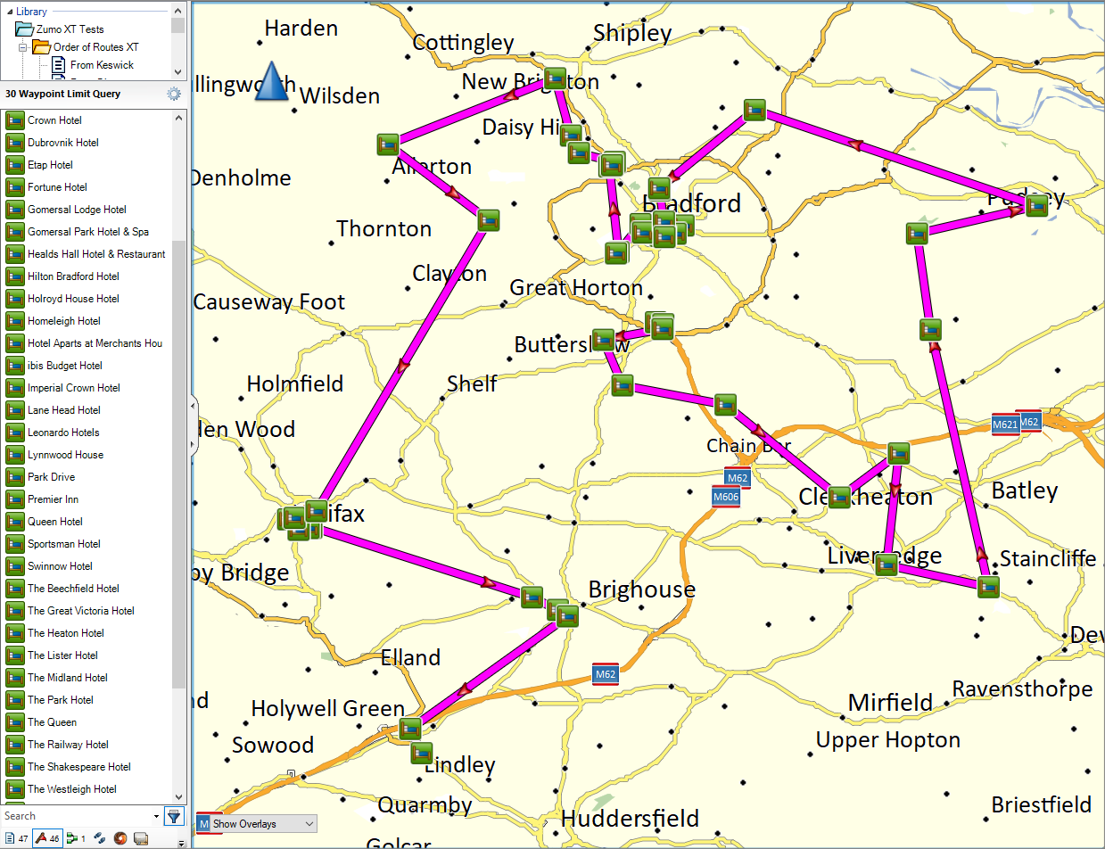

OK - I cannot answer the question about the Maximum numbers for the XT2. It is way more than I would ever want to know.
But clarification on the number of waypoints. The statement that is (was) on the website is definitely wrong.
I used Basecamp's POIs to search for hotels in and around Bradford, and kept re-searching until it got above 50.
I selected each one of the first 46 discovered hotels and right click on the name and created a waypoint from it - so I had 46 waypoints saved in Basecamp.
I then selected all of the Waypoints and got BAsecamp to create a route from them.
(Then asked it to optimize the route. Click the image to see a better quality version.)
At this point the route is a straight line (Direct) route. This is only becasue the route that follows roads rather clutters up the display.
The routes were recalculated using 2025.1 Europe maps
I created two copies of this route - both of which are attached.
One I called 46 Waypoints All Vias
The other copy I modified so that only the first, last and the Lister Hotel were set as Via Points. The others were all set as Shaping Points.
Why the Lister Hotel ?
Once optimised, the Lister Hotel was the 31st point in the route. The XT splits any route with more than 31 Via Points into two parts - which meant that the Lister Hotel would be the last hotel of the 1st part and the 1st hotel of the second part. The hotel is used in both routes (which is why the figure of 30 Via points is often quoted)
So then I placed the GPX files onto the memory card of the XT and the XT2 and asked them both to import.
This took a long time. I reckon about 15 minutes for both routes before the XT and XT2 came back from their import duties.

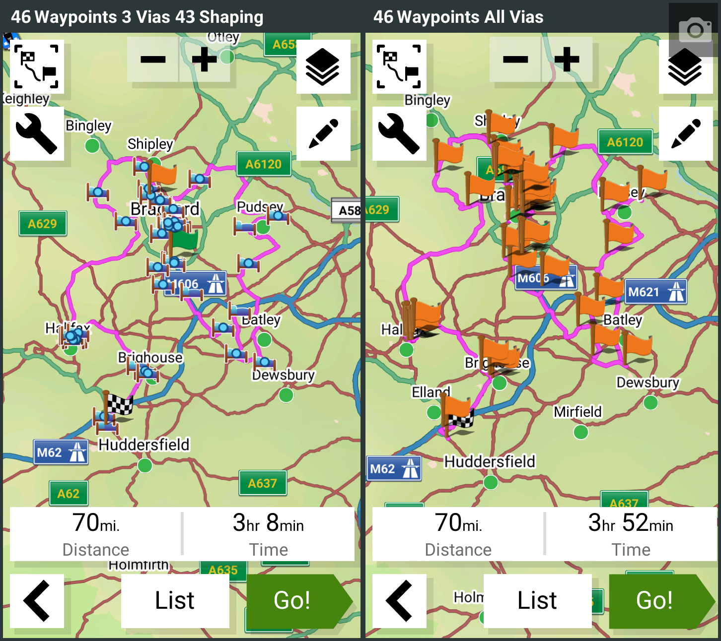

The second route with 3 Via points imported perfectly OK. So it too had 46 Waypoints, but only 3 Via points. The rest of the waypoints ahd been set as shaping points.
In the trip planner app the three Via were marked with flags - green, orange and chequered, and all of the rest were shaping points.
Second copies of the Waypoints were not imported - even though they were all declared in both files.

The Zumo XT2
The processing took a little longer than the XT - but there wasn't much in it. The link with the Explore database has not yet been set up - so there was no chance that it was synchronising. Both routes were present without any warning message, and indeed - the 46 Waypoints All Vias had imported as one route. So the Via Point restriction of 31 doesn't apply to the XT2 - although why you would want a route with that many Via Points, is beyond me. But it suggests that Garmin have a need for that. I have thoughts on that, but not for this thread.
No issues with importing the Waypoints. The XT2 calls them 'Waypoints' at long last. Not Favourites or Saved.
They are used in the route and for one route all 46 waypoints have been imported and all 46 are used as Via Points - if we count the start and finish as Via Points - because they are.
The other (mainly shaping point) route is also imported correctly with all route points shown on the map and in the list view.
On import, the XT2 asks which collection you want to import to, or you can have them go into unorganised, or you can create a collection just for these routes, waypoints and tracks. Not that we had any tracks in these gpx files.
My advice (although I reserve the right to change my mind when I start to know what I am talking about) - is that you should import everything into a bran new collection (which you can create during the import process). That way you can turn off all other collections and have the XT2 looking as though there is nothing else there. It becomes much easier to organise if you have everything to do with one route in its own collection. Later you can split off the stuff for individual days - keep the full collection name - just have some of the data also in Monday's collection, some in Tuesday's - etc
I have just noticed the time difference of 44 minutes between the two routes. Is that an extra minute added on for each Via Point ??
