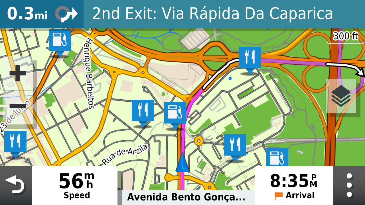

I can't help much with the auto-zoom, but you probably can simulate traveling a route far from home. This is a screenshot of a route from Almada, Portugal to Setubal. I've never been there, and don't have a CN map, but I made it with a free OSM map from OpenMapChest.org on my XT while sitting at my desk in Ohio.
Go to Settings>Navigation (or similar) to activate the GPS Simulator, then use one of these two methods to set a simulated starting location.
The simulated route does change zoom levels, but I am not sure it does so in the same way it does in the real world. I think actual speed has an effect on zoom levels, and I don't know of a way to control the speed of the simulation.
