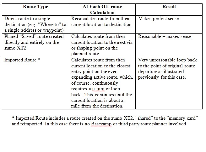

After almost 3 weeks without word, and after doing some further testing, I provided this chart and footnote to Garmin support:
Comparison Chart.jpg (81.07 KiB) Viewed 8589 times
Garmin Support said: I can totally understand how it can be frustrating for the way the unit is wanting to loop back to the entry point. I have heard back from the engineers of the unit and that is by design [emphasis added]. They would love to hear feedback at Garmin.com/ideas . We will continue to track any future reports from other customers besides yourself and will pass your feedback onto our engineers. [emphasis added]

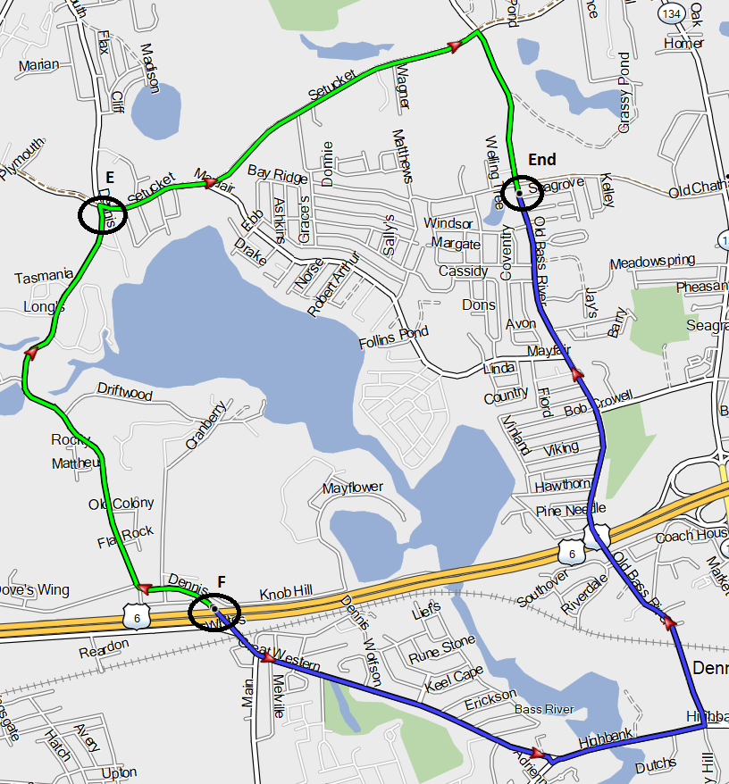

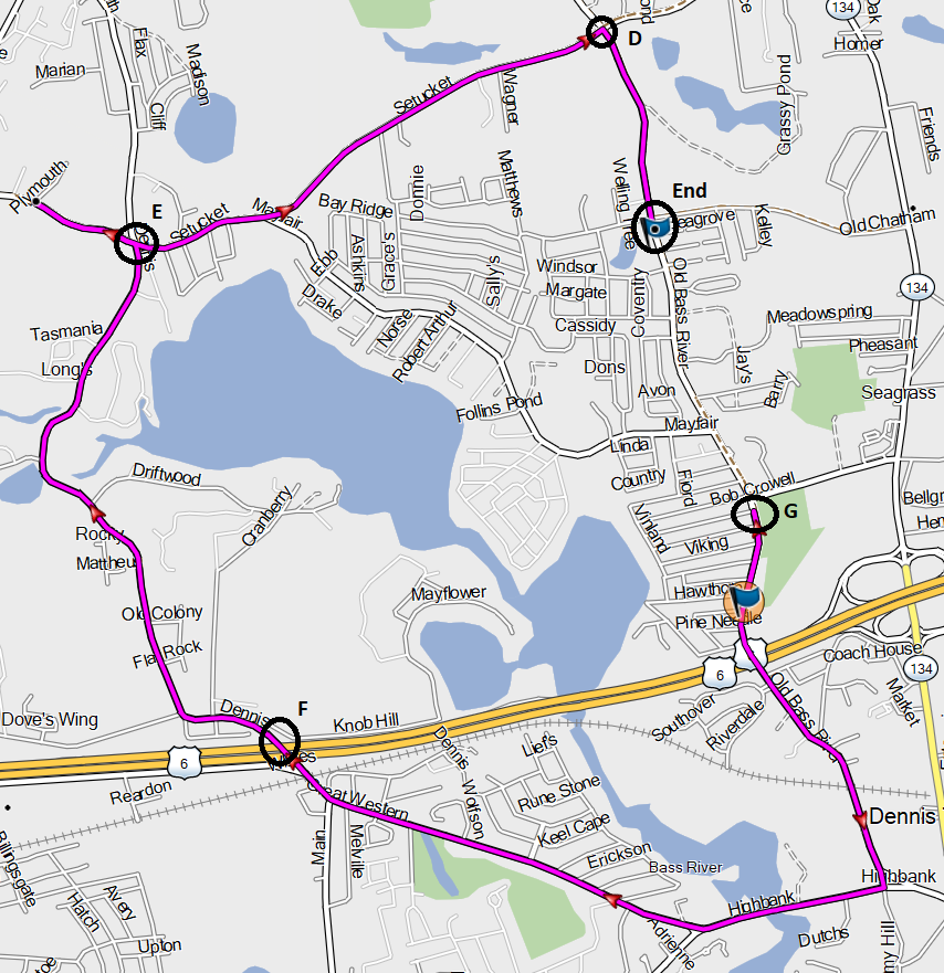

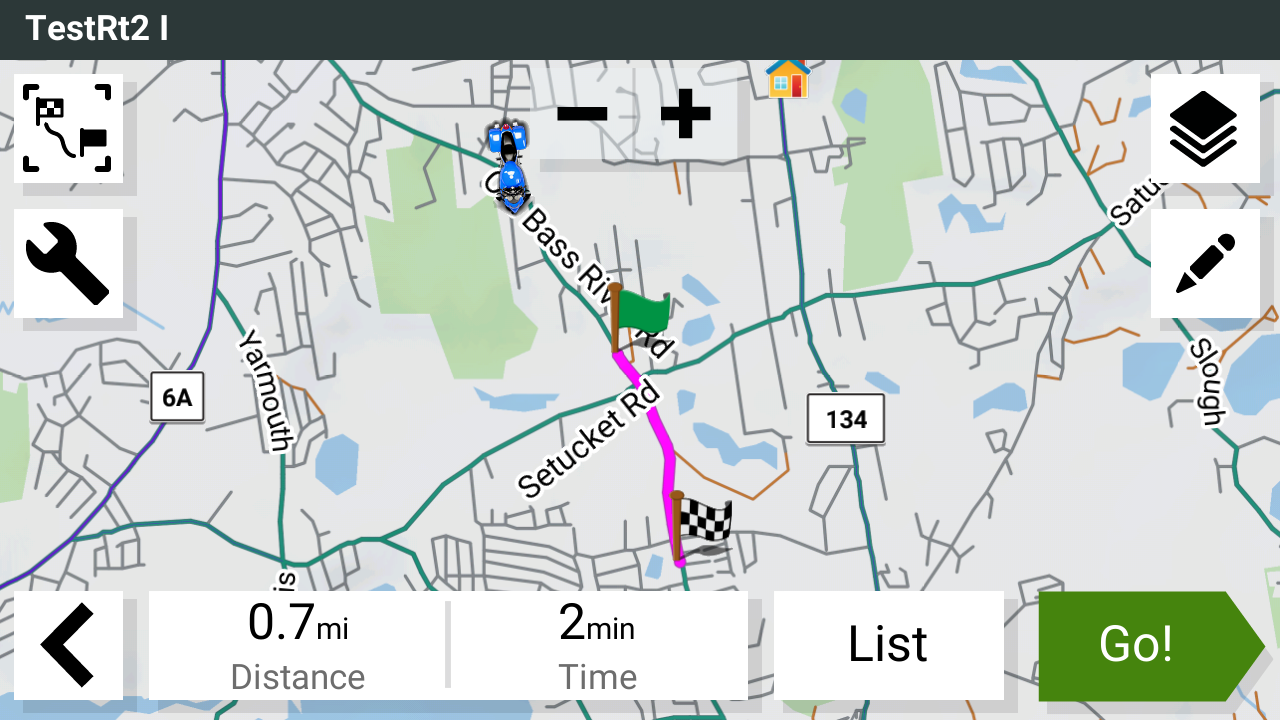

For those wondering how I've demonstrated the issue on the XT and XT2, I'll explain one of my two test routes. My test routes are the result of my own experience and testing as well as the insights provided on this forum by JFHeath and others.
My zumo is configured with automatic off-route recalculation, u-turns allowed and faster routes preferred. I start my routes using Closest Entry Point.
I'm using Basecamp here to illustrate, but an identical route was created on both the XT and XT2, then written to the sd card and imported, so that I had identical saved and imported routes on the device without using Basecamp or anything else.

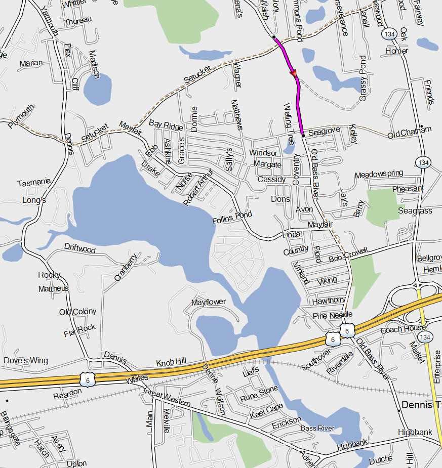

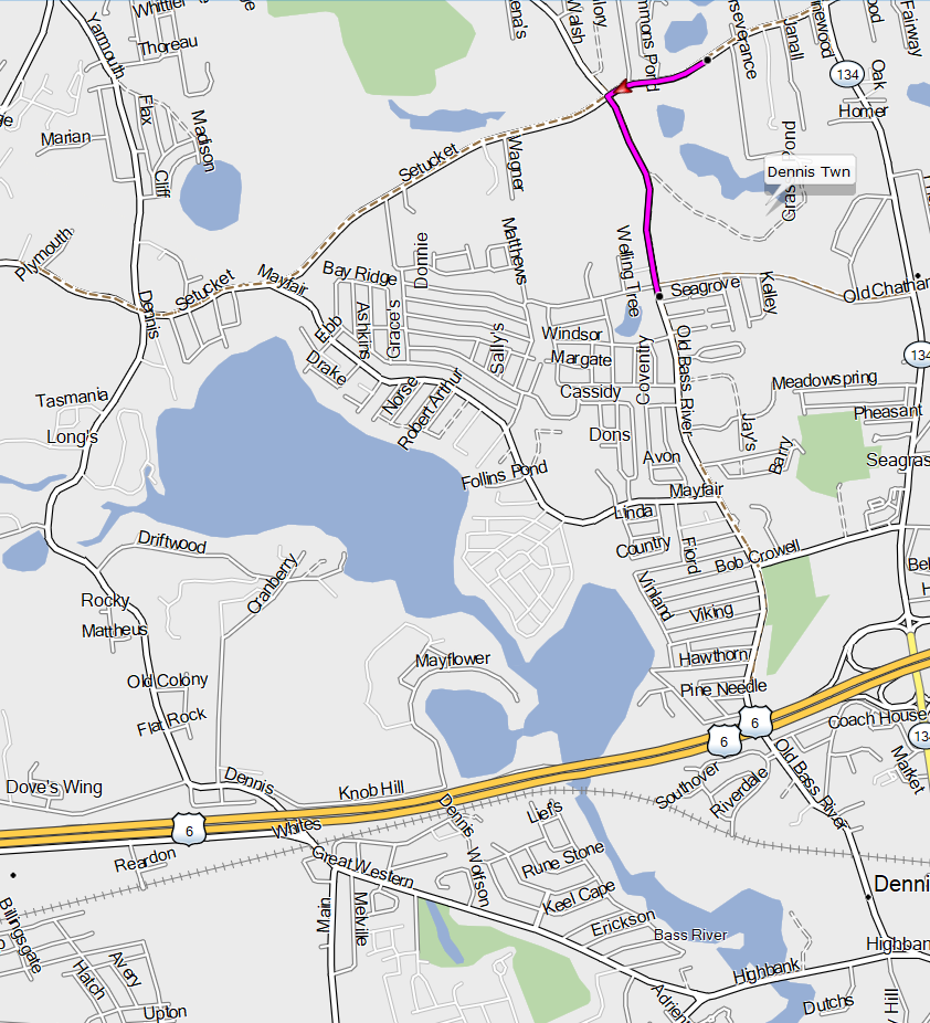

The planned short and simple two point route:
The route just after selecting Closest Entry Point:
but I fail to make the left turn, instead continuing straight ahead. The zumo tells me to turn around, which initially is logical.
After missing the left turn at point D, I eventually turn left at point E and begin a long loop back toward the original endpoint. Note that until I reach point F, the faster route to the endpoint is to turn around. For both the imported and saved versions of the route, the zumo correctly tell me to do so.
After passing the "Tipping Point" at F, is where the variation comes into play.
Imported Route:
Both the zumo XT and XT2 continue to tell me to turn around until after point G, which is well past the point where it makes more sense to continue ahead:
Identical Saved Route:
The routing behavior logically changes at point F. Prior to F, I am told to turn around to follow the faster green route back, but after F I am directed ahead to follow the faster the blue route:
You may notice the extension of the imported route at Point E that does not occur for the saved route. Prior to turning left at E, the zumo has extended the route past that point as it directs me to turn around. For an imported route, it seems to continuously extend the route. For a saved route, it seems to recalculated the route as noted in the table above.

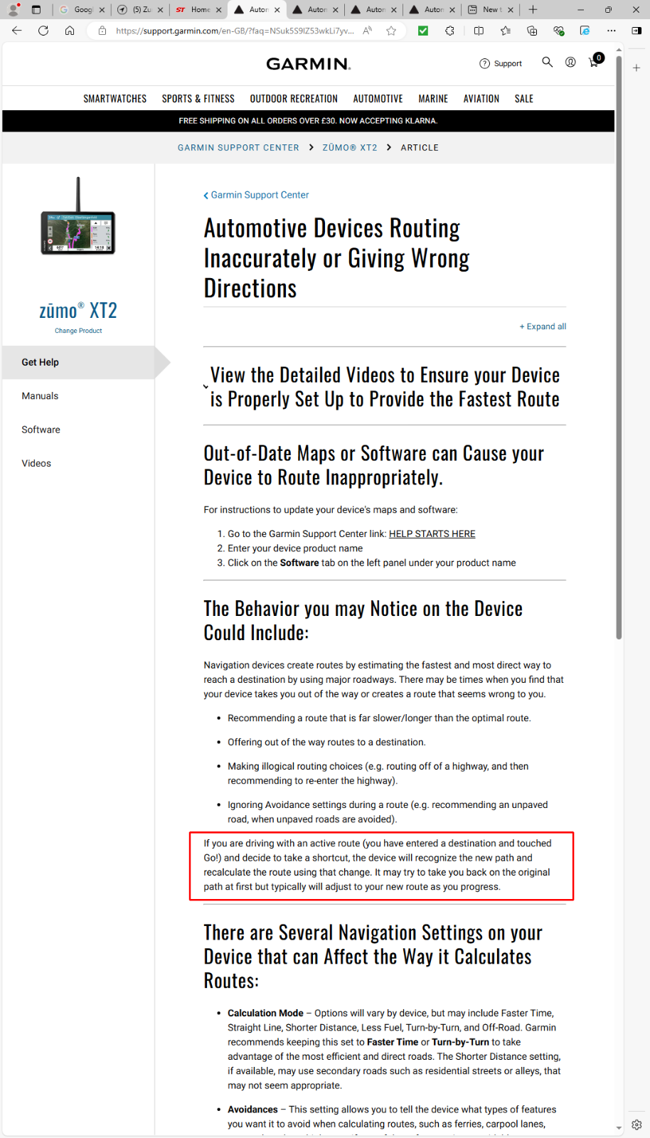

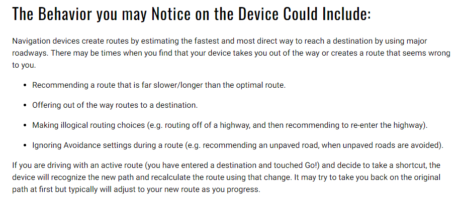

Found it.
The same information is provided in all on-line manulals for the Zumo 590, 595, XT and XT2.
https://support.garmin.com/en-GB/?faq=N ... tab=topics
Click the image - I haven't reduced its size. You may need to save it to be able to read the screen shot - but the link above shows the page that I captured. Unless they change it.
Expected XT2 behaviour.png (541.09 KiB) Viewed 8453 times
It refers to an active route - and then says - if you have selected a destination and tapped Go !. I believe that method does exactly what it describes. But an active route could also be a stored route in trip planner - from a gpx file from elsewhere. So this doesn't actually clinch it, but its the best we have got on how it should behave.
Edited to add another screenshot
Screenshot 2024-06-27 193503.png (80 KiB) Viewed 8408 times

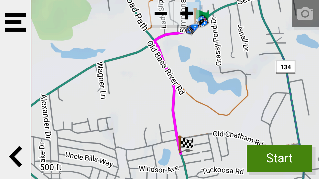

@jfheath Thanks for the support page link and the comments. As usual, you bring up good points. You inspired me to do a bit more testing.
I adopted a route with a start point that I would definitley travel through and an additional route point that I could skip. The skipped route point was there simply to make the Zumo recalculate the imported route - my belief (still) is that the recalculation ...

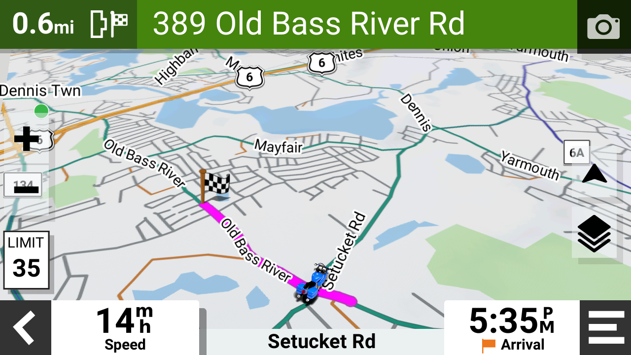

OK, so I approached my same two point imported test route by going straight up the road from before the start, selecting the start point rather than CEP.
It appears that when I selected the start point as next destination, it calculated a route from my location to the start point and merged the 2 routes, making the combined route the active route.
After passing through the original planned route start point, I turned right to go off-route.
The same RUT behavior occurred.
Side Note: from the above screen shot, it appears that once I passed through the original planned start point, the XT2 dropped the merged part from the active route, keeping just the original planned route as active.

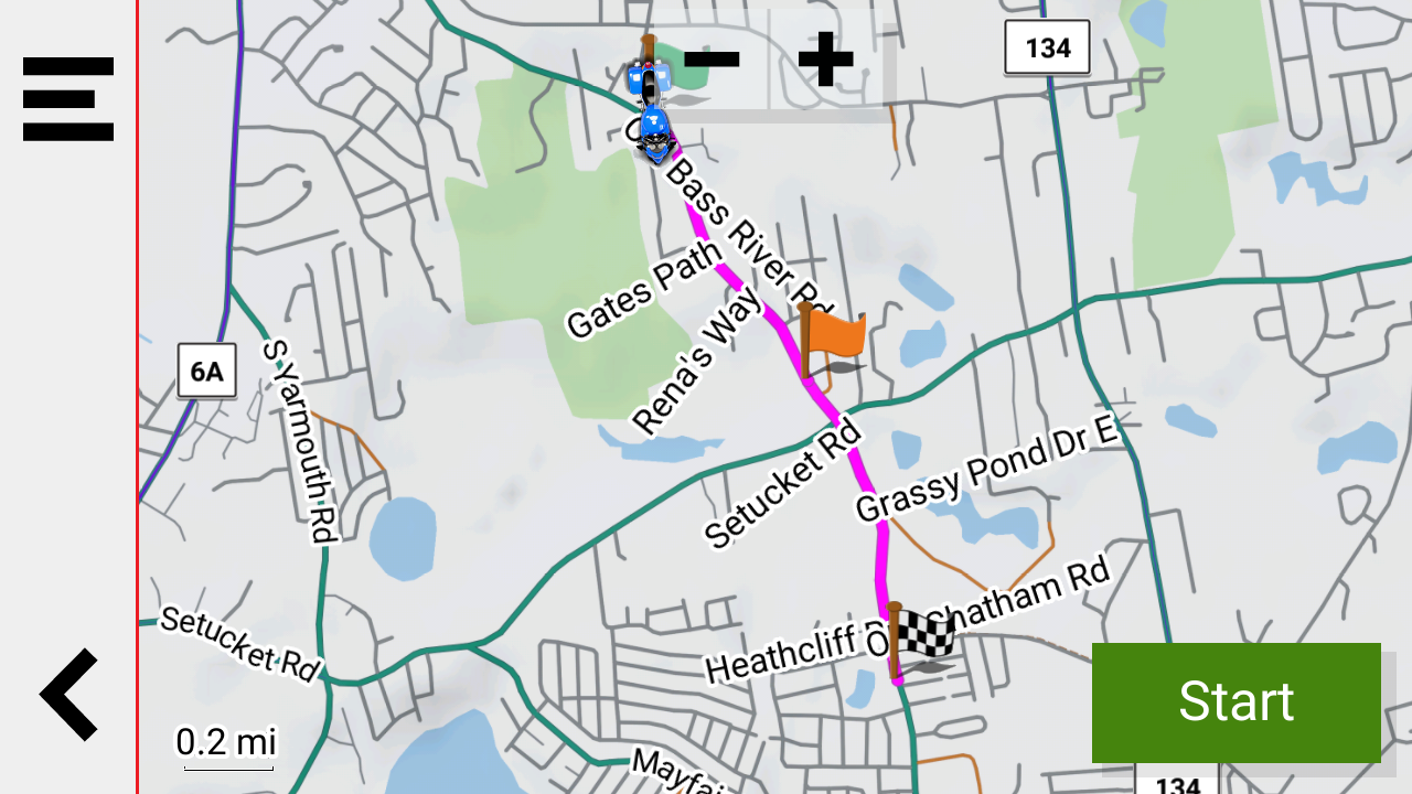

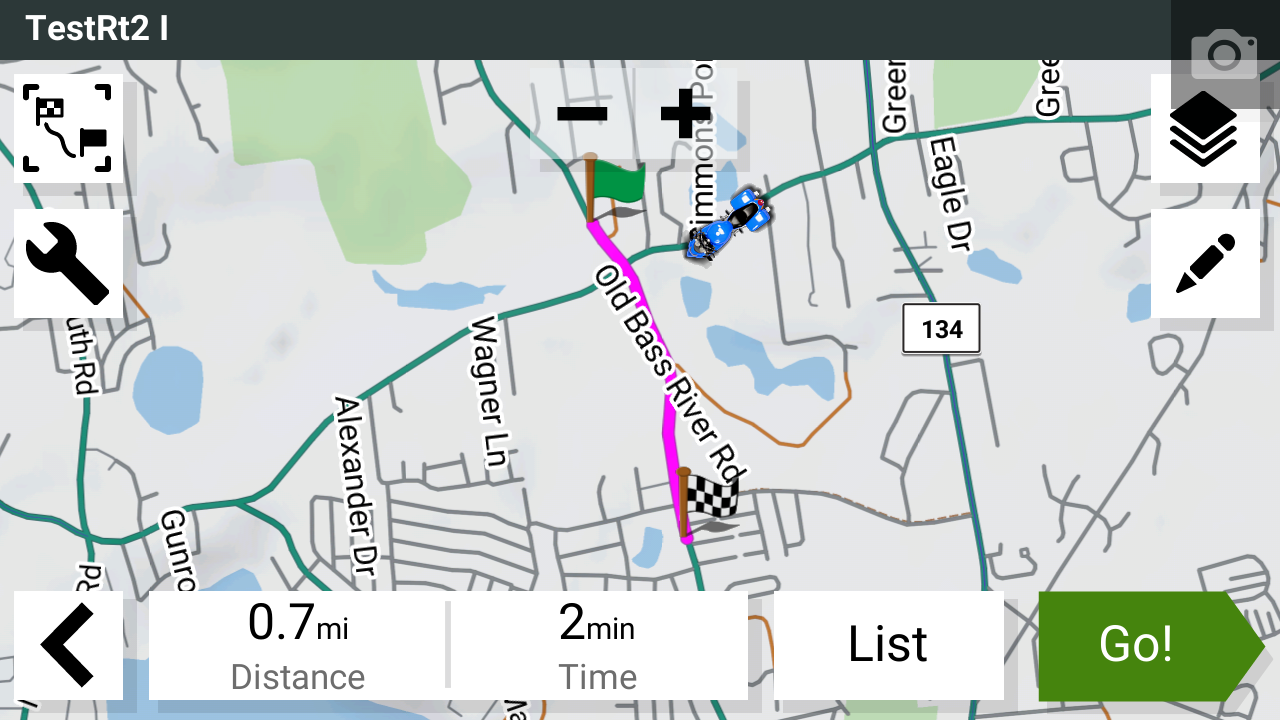

The thing that spring to mind in your test is that you don't know where the selected closest entry point is located. That point could be treated as the start of the route, and if it is just after the left hand bend heading south, then by going straight on at the junction, you will have failed to go its selected start point !

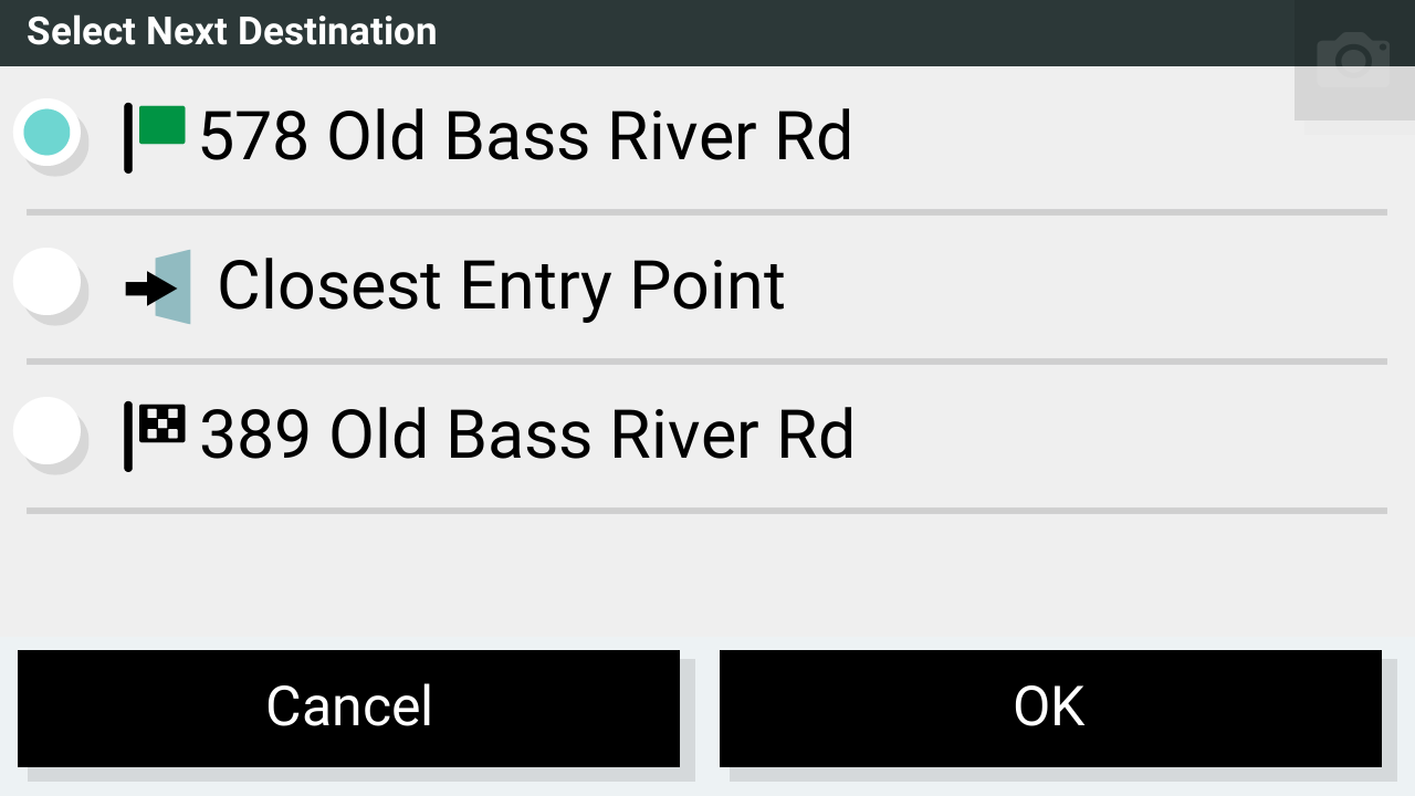

So going back to the CEP approach, just before selecting a "next destination", the route looks like this.
Just after selecting CEP, but before I began to move, the route becomes
The XT2 appears to have selected the intersection ahead as the entry point to the original planned route, calculated a route from my current location to that point, merged the 2 routes together, and dropped the now irrelevant beginning part of the original planned route. The start point of the active route appears to be my current location. This route has only start and end via points (at least as it shows on the map). There are, of course several hidden or ghost points. I would expect one of those to be right at the intersection.
You may recall my theory of how CEP works here: viewtopic.php?p=20792#p20792
