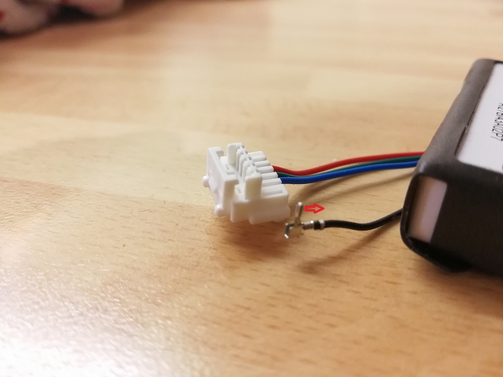

If you look at the connector on the battery you will see 5 small tabs.You need to lift these and pull the wire and pin out of the connector block. Be careful as they are a little delicate you can see that one of mine is a bit bent as I was a bit rough.
2017-03-14 19.10.58_zpsrecmely7.jpg (223.33 KiB) Viewed 65236 times
Once removed you need to bend the pin very slightly in the direction shown here. Be careful not to over do it and keep the pin straight as they easily go off centre.

Ensure the tab is straight and pushed back down on the connector block then insert the pin and wire back in to its slot ensuring it is fully home give it a little tug to make sure it is.
You could also probably go in from the back of the connector block with a pin and bend the connector pin but I removed them as I also wanted to give them a clean
