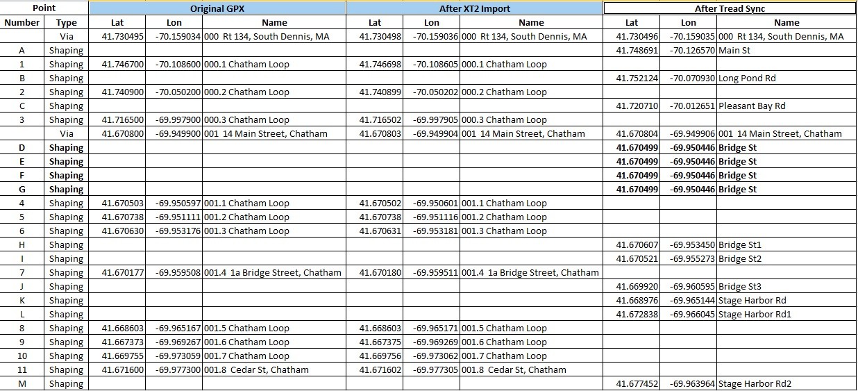

The process:
Export a gpx file containing a perfectly valid route from Basecamp.
Copy the file to the XT2's sd card.
Remove Tread from my phone so it will not sync.
Import the route from the sd card and open it on the XT2 - it looks fine, both in map view and list view.
Re-export the route as a gpx from the XT2, via the sd card, open it in Basecamp and assure that the XT has not changed the route.
Reinstall Tread and allow it to sync.
Observe that the route has changed significantly after sync.
Using the same method as above, Export that changed route as a gpx from the XT2, via the sd card, open it in Basecamp and observe the route changes in detail.

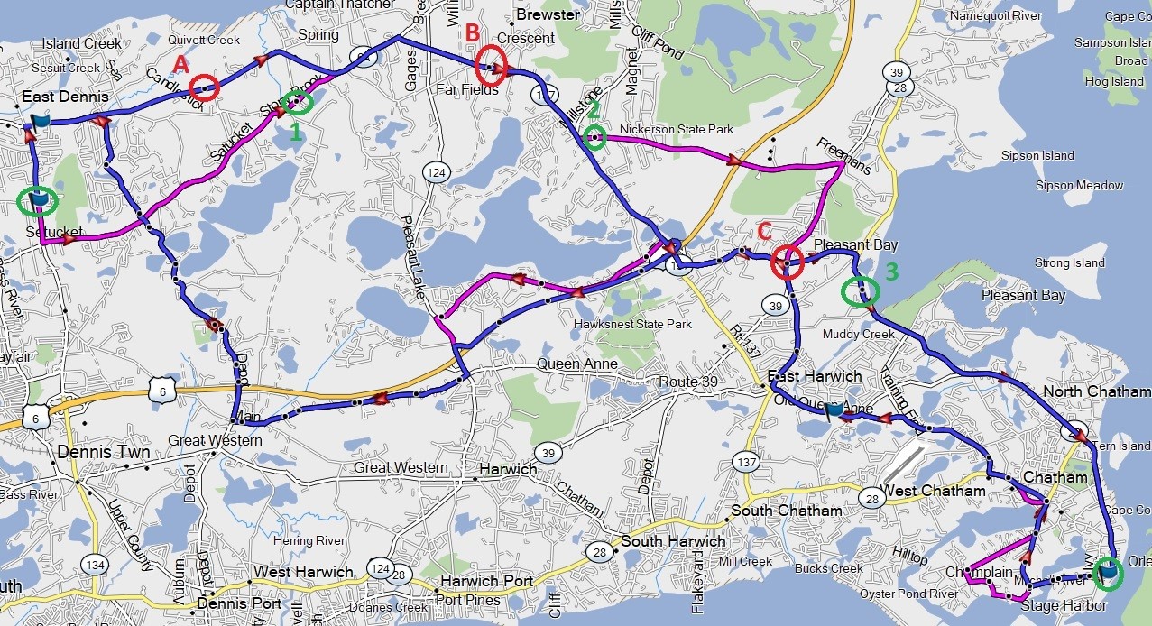

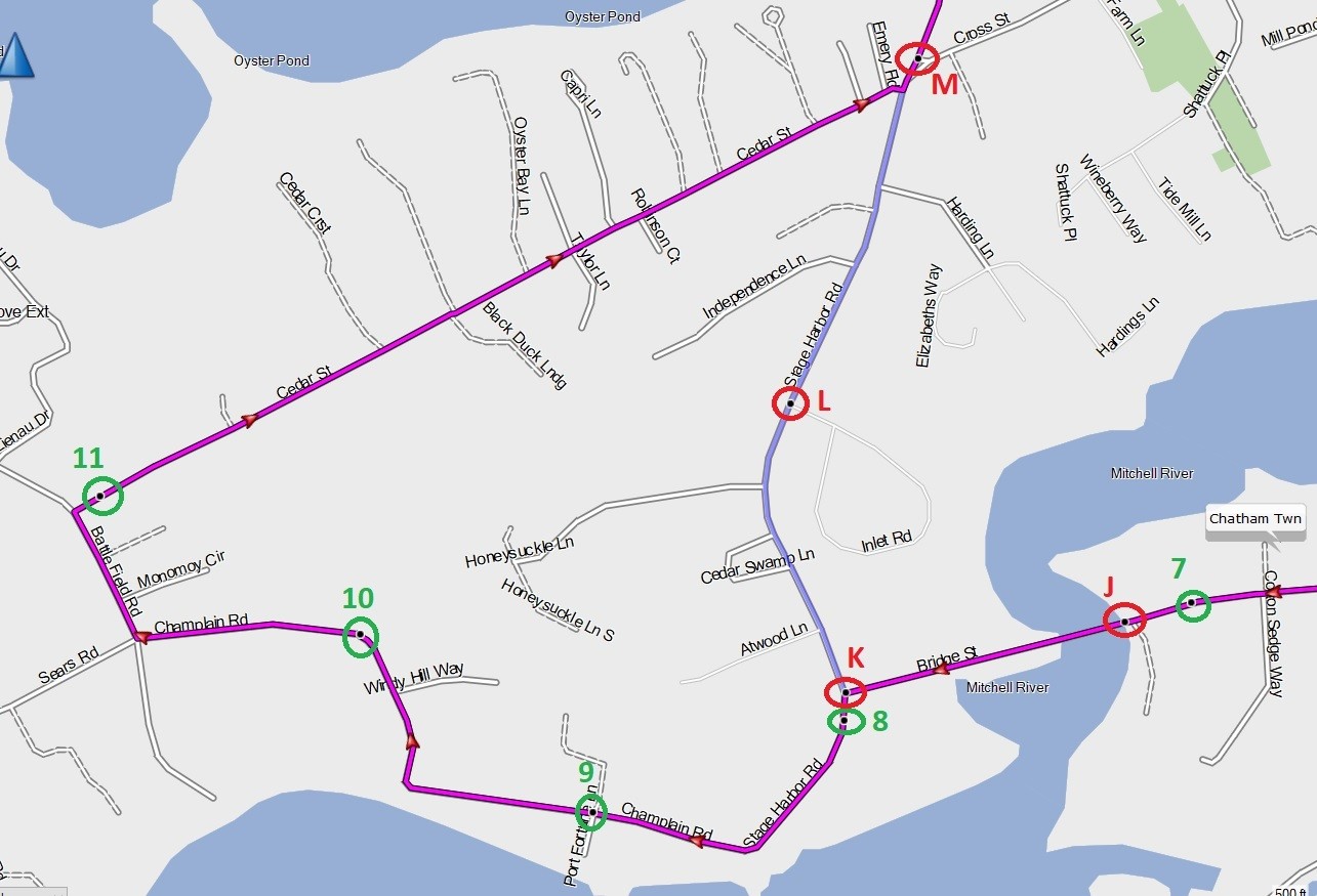

The magenta line below shows the original route which was imported to the XT2 and the route as re-exported before sync. They appear identical.
The blue line shows the changed route after Tread sync.
The via points are identical for all the routes, The shaping points in the post-sync route are very different. In the next 3 images, the shaping points in the original (and pre-sync exported) route are shown with numbers. The shaping points in the post-sync route are shown with letters.
Note that Tread created the exact same shaping point 4 times at D, E, F and G.
Extracting the points from the 3 gpx files shows, consistent via points, very minor shaping point location differences between the original and pre-sync exported files, and significantly different shaping points in the post-sync gpx file.
