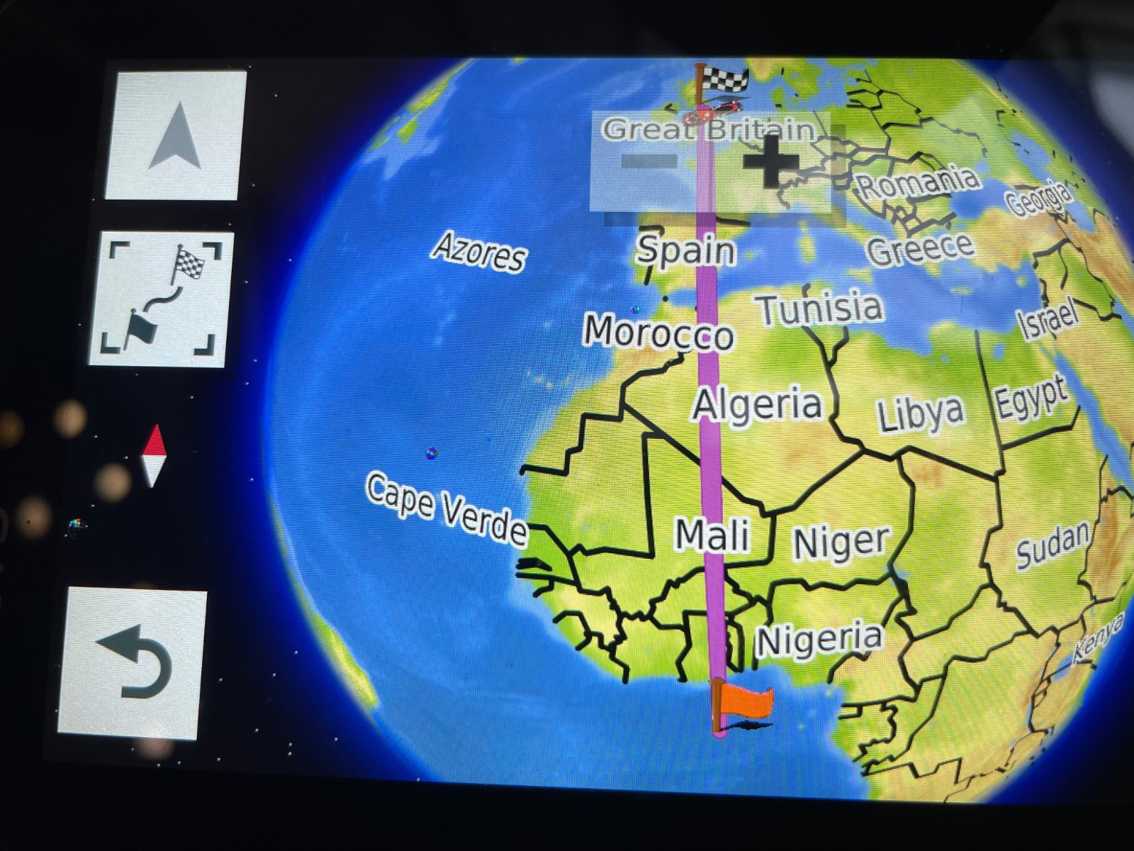

After two weeks pottering around Spain and France, returning to the U.K. via Rotterdam to Hull I entered “Where to” and “Go Home” in my Zumo XT.
This gave a surprising arrival time (>24 hrs) so I checked the route. This shows a waypoint - nothing to do with anything I’ve created as far as I know - in the South Atlantic.

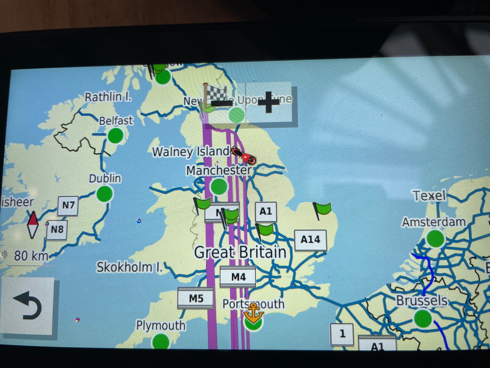

Took a couple of snaps of what appeared on the screen and… (second photo from Wetherby services where I retried the Route)
Extremely odd route to go home

That location looks suspiciously like 0 degrees N and zero degrees west. ie on the Greenwich Meridian on the equator.
Which means that it doesn't know where you are. It has to have something, so it starts with 0,0. Goes hunting for satellites that should be int he vicinity at that time. Finds something. Once it has found four it can get a sort of better position. Its not very accurate because the satellites that it finds will be near the horizon where positional errors will be very high.
It then repeats the calculation using (hopefully) better information - but of course it could have found satellites that were further south - which isn't going to halp a great deal. Remember you are a lot further north than it thinks that you are.
And so it goes on. It can take quite a long time to get an accurate fix. Even longer if you keep moving while it is doing it. Really you need the Zumo to be prevented from turning off with a good view of the sky.
Or - and I haven't tried this - you could find out your current position from a Michelin map and enter the details into the Position.gpx You would need to copy it and edit it in a text editor and then copy it back.

Thanks for the reply. It gave strange results from both Hull, after being out of satellite range for several hours, but also from Wetherby having been in the U.K. for a couple of hours - albeit in motion. It did appear to know where we were in the ferry terminal as it displayed the route out - it only went pear shaped where the M62 joined the A1(M).
I’ve since tried it and it appears to be working just fine. Hopefully that will be a one-off but I’ll monitor it as a matter of course.
