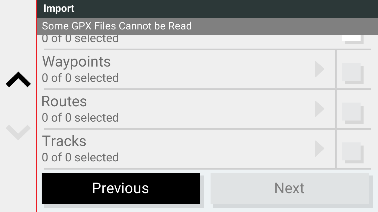

Many thanks, it was the Alternate route that I was after. Having done that the XT2 wouldn't refresh the SD cards contents and insisted on installing what was previously on there in the GPX folder. A reboot just sent it into a reboot loop, then without the SD card in, it booted successfully and finally got the files installed. Getting there slowly...

@m326 Yes, the XT2 does seem to have issues with the sd card at times. My guess is that the software is sometimes not properly closing the card, but that is only a guess. I have been removing and inserting the card only with the XT2 turned off. It seems to help. I write gpx files to the card with it inserted in my pc, and I'm careful to "eject" it before removal from the PC. In some cases, the XT2 seems to only recognize new files on the card after a 2nd power up cycle? I have not bothered to narrow down the issue nor have I pursued it with Garmin support. (I'm still waiting for them to get back to me on bigger issues.)

I have not taken the time to narrow down the sd card issues, but here are a couple of example observations.
1. After [proper I believe] sd card operations, I have had the zumo XT2 go into a continuous reboot on power up and solved it by removing the sd card. This is not a frequent occurrence, but it has happened a few times. It would appear that the XT2 tries to read the sd card during boot and never gives up trying if there is an issue with the card or its contents.
2. A simple exercise involving only the XT2: On the device, "share" (save) an existing route to the sd card. After it is saved, import it. Sometimes it works and sometimes the just written gpx file can not be read. In cases where the file can not be read, power cycle the XT2. The file can then be read.
(Yes, saving then immediately importing a route is an odd operation. I noticed this sd card issue when testing saved vs imported route behavior related to RUT.)
I'm keeping mental notes. If I get the sd card issue(s) sorted out sometime in the future, I'll post what I find.

On my Windows PC I always 'eject' the SD card before removing it from the system.
I've not seen any way of 'ejecting' it from the XT2 and thus far I have been putting it into sleep mode and removing/replacing it.
Doing this I have not been able to get the XT2 to re-read the cards contents and each time have to reboot the device to get it to refresh the SD cards contents which is obviously time consuming.. Is this normal behavior?
Once it does read the card correctly, it then takes it's time importing the file(s).
My initial way of transferring was via USB and that was even slower to make a connection, haven't timed it yet but seems like 5 minutes! Is this also expected performance, anything to speed it up?
Sorry, this is all off topic.

Generally speaking the SD card is only read from, not written to. You don't need to formally eject a device if all you have done is read from it.m326 wrote: Tue Sep 24, 2024 1:41 pm On my Windows PC I always 'eject' the SD card before removing it from the system.
I've not seen any way of 'ejecting' it from the XT2.
Unless the route is being shared to the SD card. The XT is in control of that, So I would assume that it flushes its own cache on completion. Just leave it a few seconds longer.
I'll try to remember to investigate whether or not the SD card in is Mass Transfer Mode or MTP.
After trying to find out whether or not the SD card uses MTP when writing files, jfheath wrote: Ok - I tried a couple of things. One of which was to place a word processor (Word) document onto Internal Storage on the SD card. Word would not open it. It just sat there with the document name in the filename box and did nothing when I clicked 'Open'.
Word likes to keeps an open file in the same location as the original file, and it writes to it periodically. So if it cannot keep a temporary file open (I assume because the device is using Media Transfer Protocol), then the original file will not open either.
I assume that the reverse is true: If Word cannot open a document - becasue it cannot create a file that it can keep open, then the device is using MTP.
Lots of assumptions in there, I'm afraid. Whatever - if you have found that Ejecting the SD card stops a certain issue from happening, then use it. I do anyway - just as a matter of keeping a good habit going.
