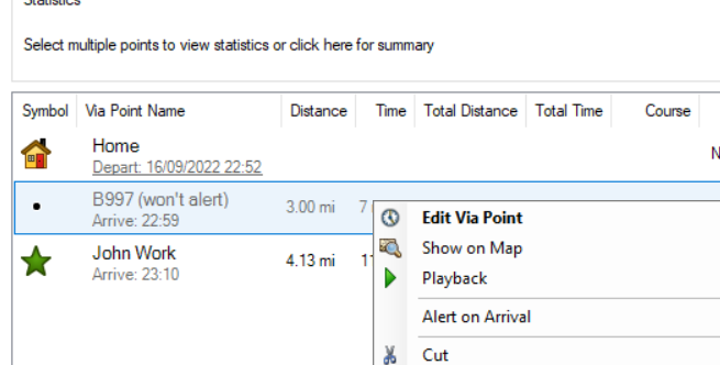

jfheath wrote: Fri Sep 30, 2022 2:36 pm OK thanks. That is what I assumed that you meant. But different from garmins definitions.
Via Points announce on arrival.
A via point by Basecamps definitions might, or might not be announced.
Anyway, a point that is just dropped onto a road to be included in the route, unannounced, has exactly the same rubbish routing effect as the waypoint / shaping point options.
The routing algorithms make more sense when there is only a start and finish point defined, but, still seem to favour faster roads over a faster time. Basecamp doesn't exhibit this. I see a two minutes less journey being calculated in Basecamp compared to what the XT would have me do. When I take the turn onto the road, the XT then shows a reduced time! And the time in total is only 7 minutes so 2 minutes is a large proportion.
Via point in basecamp.PNG (64.27 KiB) Viewed 3207 times
