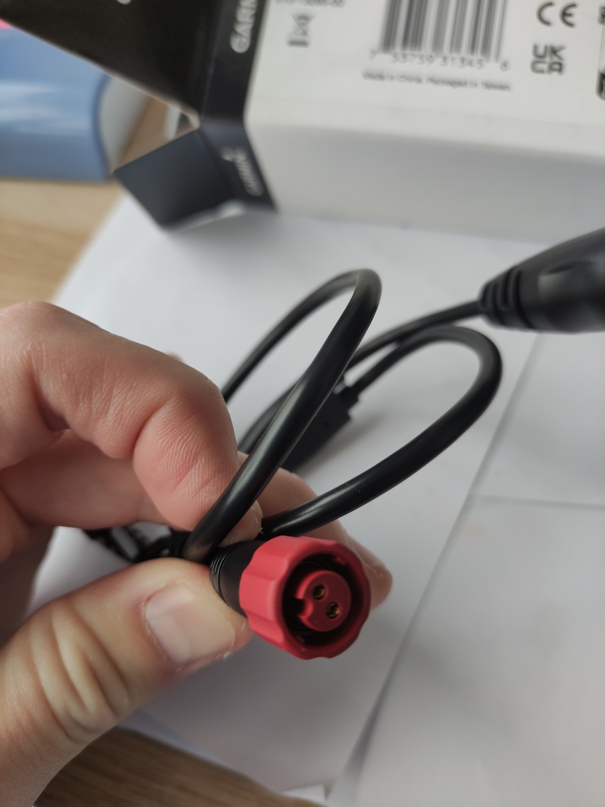

The Y adaptor connector shown in the photo posted by @turbo19 has pins 1,2,4,5,6. No pin 3 (shown above as asterisks)
So it has a pin for supplying the 12v feed for the Zumo XT2. It does not have a pin in the position where the XT1 cradle provides +5v.

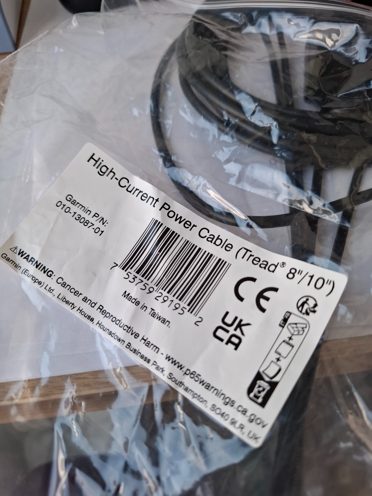

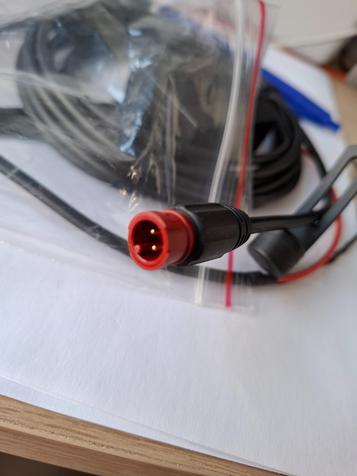

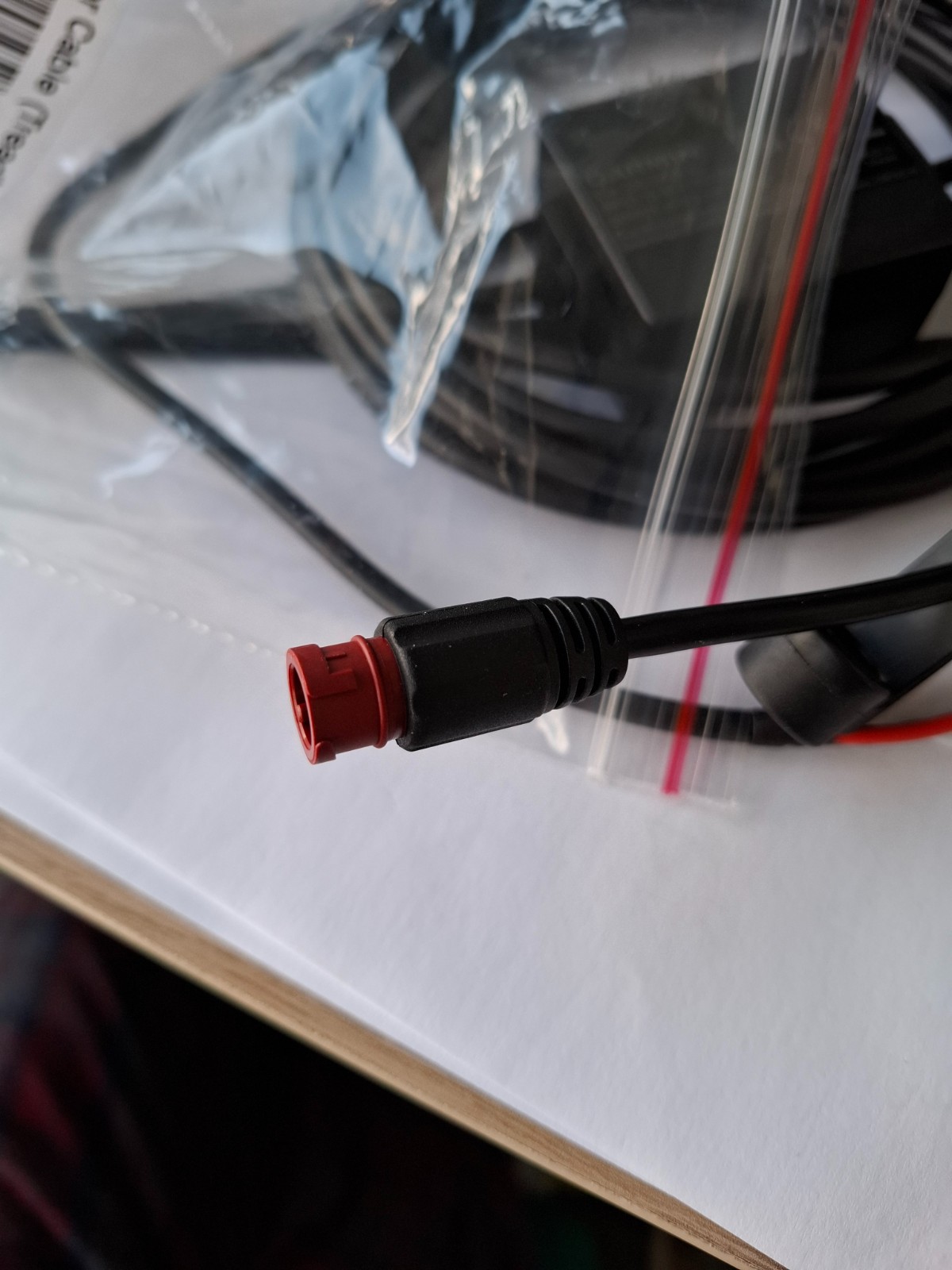

I just received the cable:
As I already mentioned, I think this cable makes sense if it is a vehicle with a double battery (truck type, etc.) 24v. But having a Can-Bus 12v output on the motorcycle, I don't understand why this cable is needed, only for the red male power plug.
As Marc said, I think it could be connected directly from the Can-Bus to the Y cable without problem. I'm still looking for a male plug like this, but I can only find similar ones, I can't find anything like it. :roll:

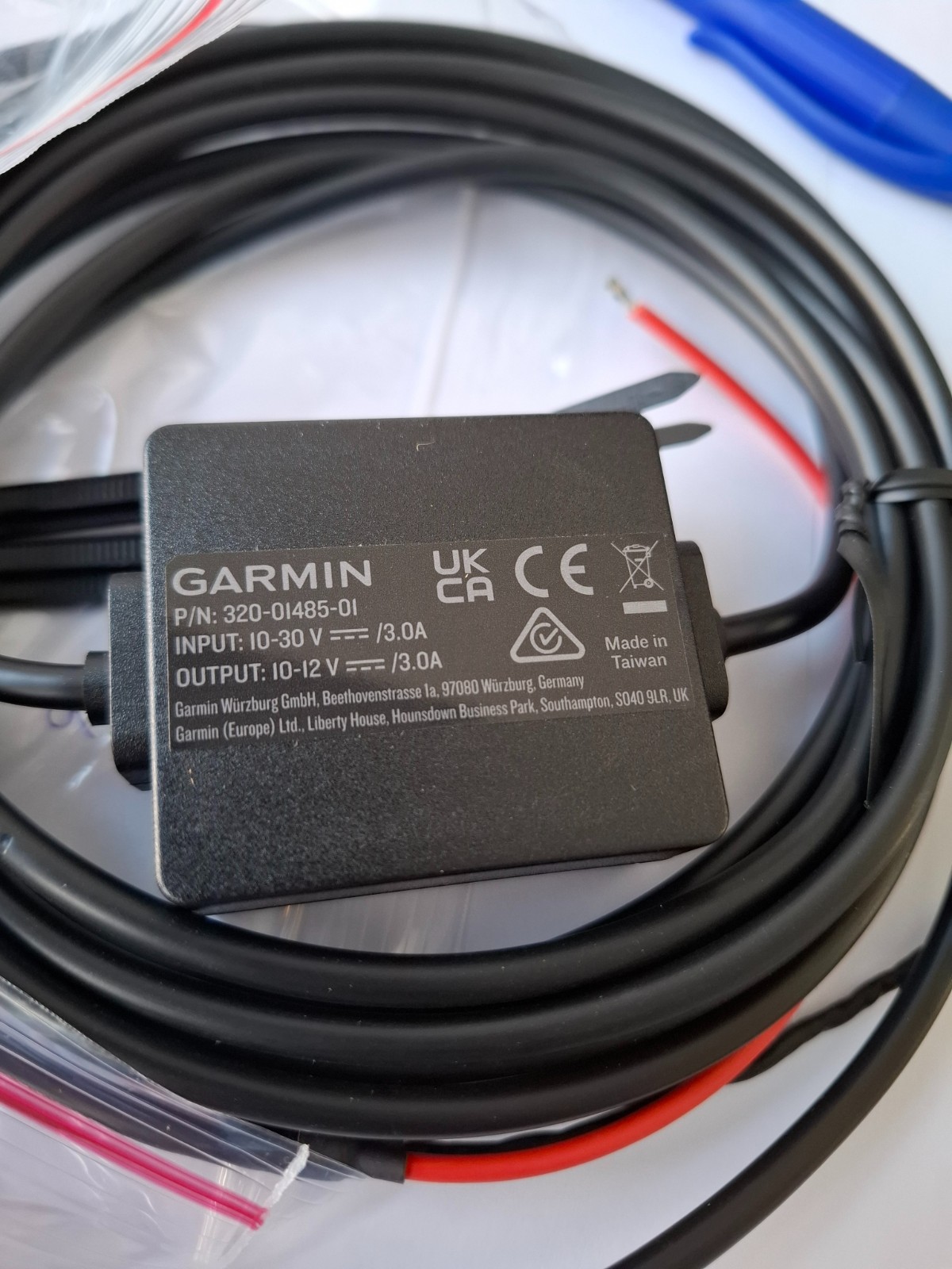

Thanks @turbo19
That info on the black box might contain the answer.
It says Input 10-30v DC
Output 10-12v DC
XT2 spec says that it can take input from 12 to 24v DC - so it can handle the fluctuating voltage that comes from the bike's battery / alternator without the need for a voltage limiting buffer.
Maybe the Remote Cotroller needs a more restricted voltage of 10 to 12V than the varying voltage that is provided by a direct connection to the battery ?
If you cut out the High current cable with its black box, the controller will be exposed to whatever the battery/alternator is putting out - which we know is often over 14volts.
Just a thought - there must be a reason for that black box. Maybe that is it ??
