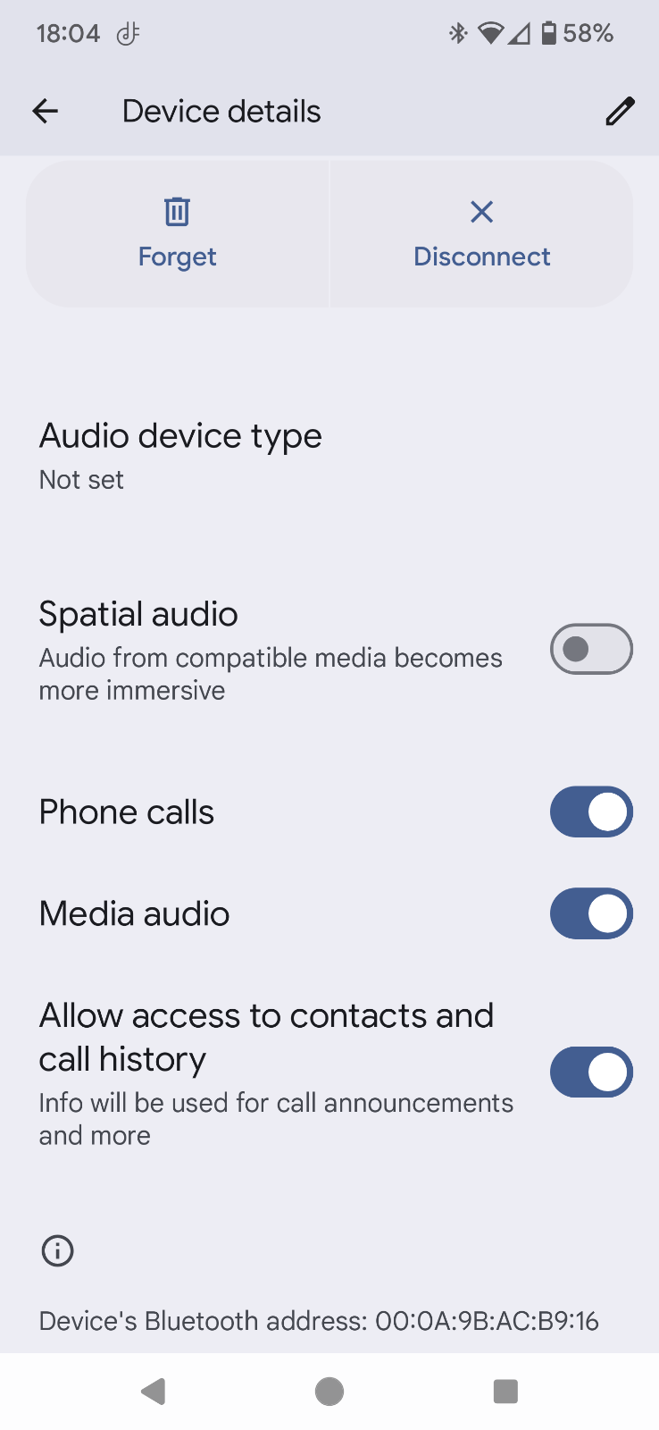

The settings you need to change are on your phone not on the XT
connect everything up then go to bluetooth settings then click on the settings for the XT
This is the settings I have using a Cardo Edge
This is the settings for the Zumo

Stu,
I think you just helped me with this problem! I followed your instructions and I think the phone settings are what I needed to do. In addition I went to the Drive App settings and removed permission for calls and contacts.
Now when I go to the XT Bluetooth screen, it says Galaxy S23 Connected, plus about every ten seconds it says "connecting." BUT it does not succeed in doing so. I will test it on a ride, but this could be the solution to my problem!
