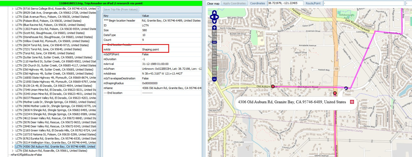

jfheath wrote: Thu Feb 13, 2025 8:15 pm If you add another point after the previous end, MRA seems to change the previous last point back to what it was.
This seems to be true although I don't understand the rationale. I had made a route from California to Oregon on the iPad when I first subscribed to MRA Basic. I just added another point to the end of that route and it turned the previous end into a via point. As you say, BaseCamp would have made that a shaping point. Not sure if this is a bug or a feature.

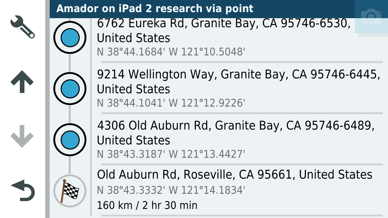

Hi Tom. Long story short. I cant reproduce it. All points (except start and finish) are shaping. Now I'm not questioning your observations, very likely we do something different, or your XT is different etc. But for the moment I'm out of ideas
This is what I did.
- Downloaded and installed OSM maps for the USA. In BC and on my XT.
- Loaded the GPX you supplied earlier in BC, to get an overview.
- I saw that all points in BC are shaping. I did however see some points placed at locations that I would not appreciate. But it's very unlikely that that will have an effect on a point being shaping or via.
First attempt:
- I cleaned my XT, and copied the GPX to internal storage. Via Windows Explorer.
- Restarted the XT and imported the trip. All points are shaping!
- Checked the trip with TripManager, that confirms all points are shaping.
Second attempt:
- Cleaned the XT
- Now I transfered the GPX with TripManager and selected the .trip format
- Same results.

tombarrington wrote: Tue Feb 11, 2025 11:58 pm Thanks @jfheath. My eyes are watering from looking through the gpx 1.1 file but I confirmed point 36 designated as shaping.
Yes, MRA doesn't do new lines in its GPX file. Most of the file is track points - so if you find the <trk> command and delete everything to the </trk> command, it is easier to see what is left.
If you have a program like Microsoft Word, you can then use Find/Replace on the entire document and replace <rtept with ^p<rtept
^p is the code for a new line - which starts a new line before every Route Point command. The whole thing is then much easier to read.
Like this:

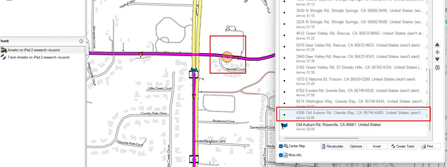

The maps wouldn't make much difference in the designation of Via and Shaping points
Except perhaps in Basecamp where it will automatically make known locations as 'alert on arrival', and other unrecognised locations will not alert. So that would depend on the map and what known location on the map is close to your mouse pointer when you place a point.
Basecamp does not use the term via and shaping points as it should. That is because BC was based on Mapsource - which was written long before the Via / Shaping point distinction was introduced formally with the Zumo 590 and related satnavs. The route list shows them all under the heading 'Via Points' regardless of whether they are Via or Shaping. BAsecamp's GPX files names them under the <extensions> qualifier. Mapsources GPX files simply refers to them as route points - with no <extension>.
I don't bother about what type of point they are when using Basecamp - not until the route is completed - then I use the route list, select all but the start and finish point and change all the others to not alert on arrival (shaping points). Then pick out the ones that I do want to alert and set those individually. Those are the Via Points.
