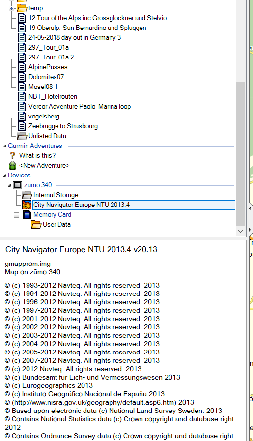

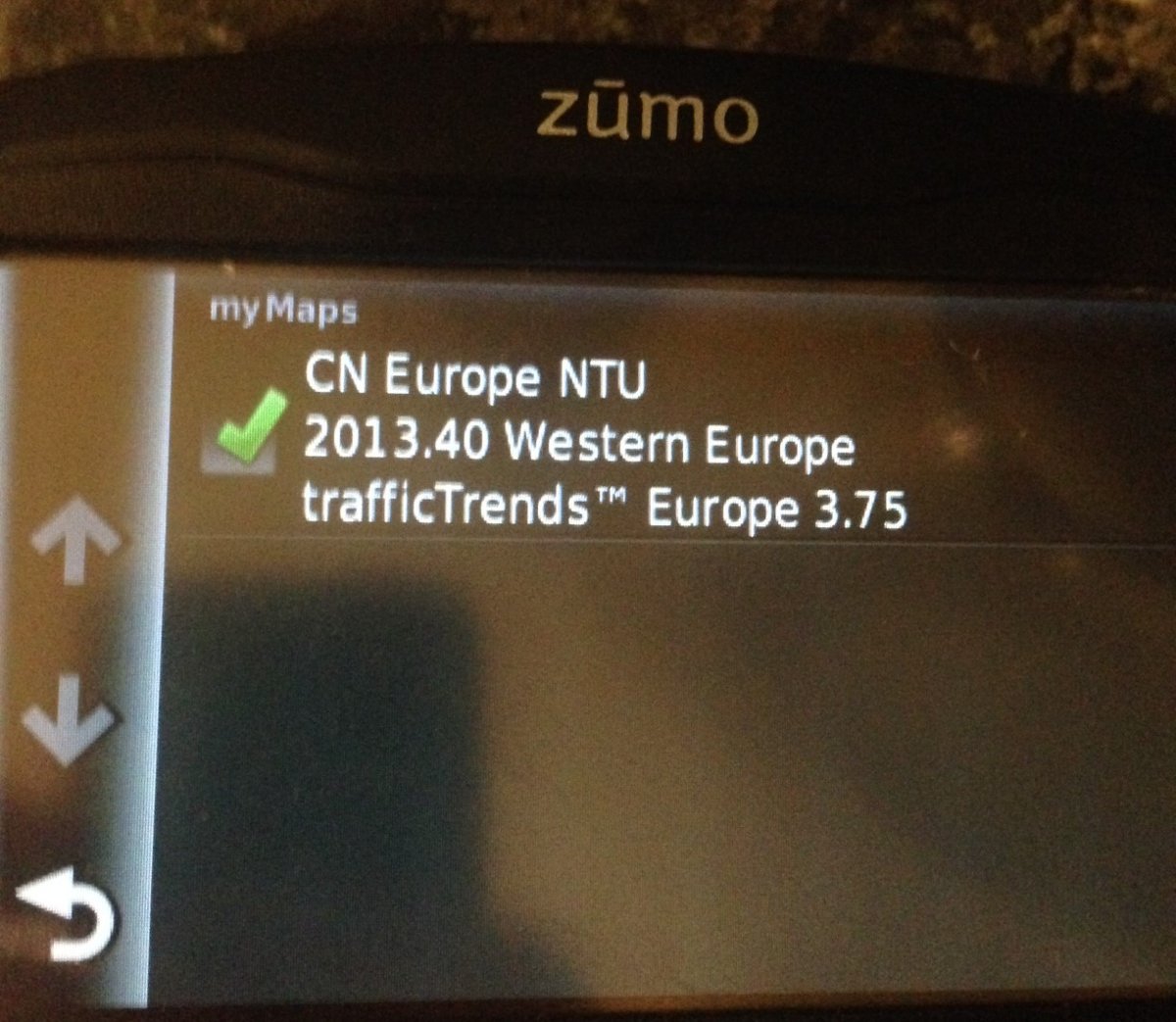

should be simple enough. but it doesn't work. I still keep getting Garmin Express saying that NT 2018.20 is uptodate and installed. and yet I can't even see it any where on the zumo nor am I able to select any map other than the 2013.40 NTU map. I'm stumped

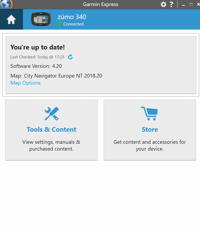

OK so this is what I see in Garmin express with Zumo connected
what I see in Garmin Express with zumo 340 connected
I'll try to get a pic of just the my installed maps from the zumo itself.
cheers
Andrew
Re: How to put maps onto your PC
Well that's suggesting you're up to date with 2018.20 NT, yet you say you only have a 2013 map showing and it's the NTU version. The two don't compute so I am now lost, which doesn't happen often.

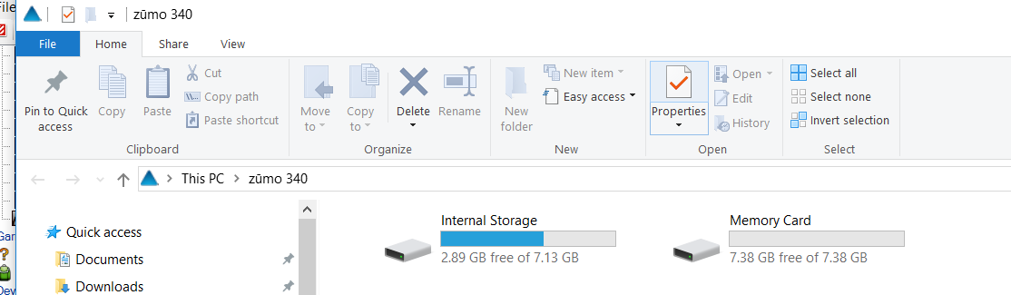

to begin with, as was suggested earlier, here's a pic of what I can see on my zumo itself.

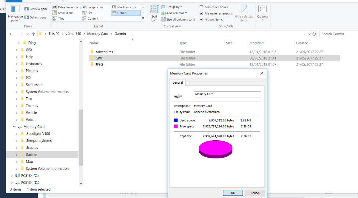

when you talk about the card installed, I'm not 100% with you. There is an internal memory and a (SD?) card. this is what
file managers shows
and in BC you can see the same situation really
are you referring to the internal storage or to the memory card?

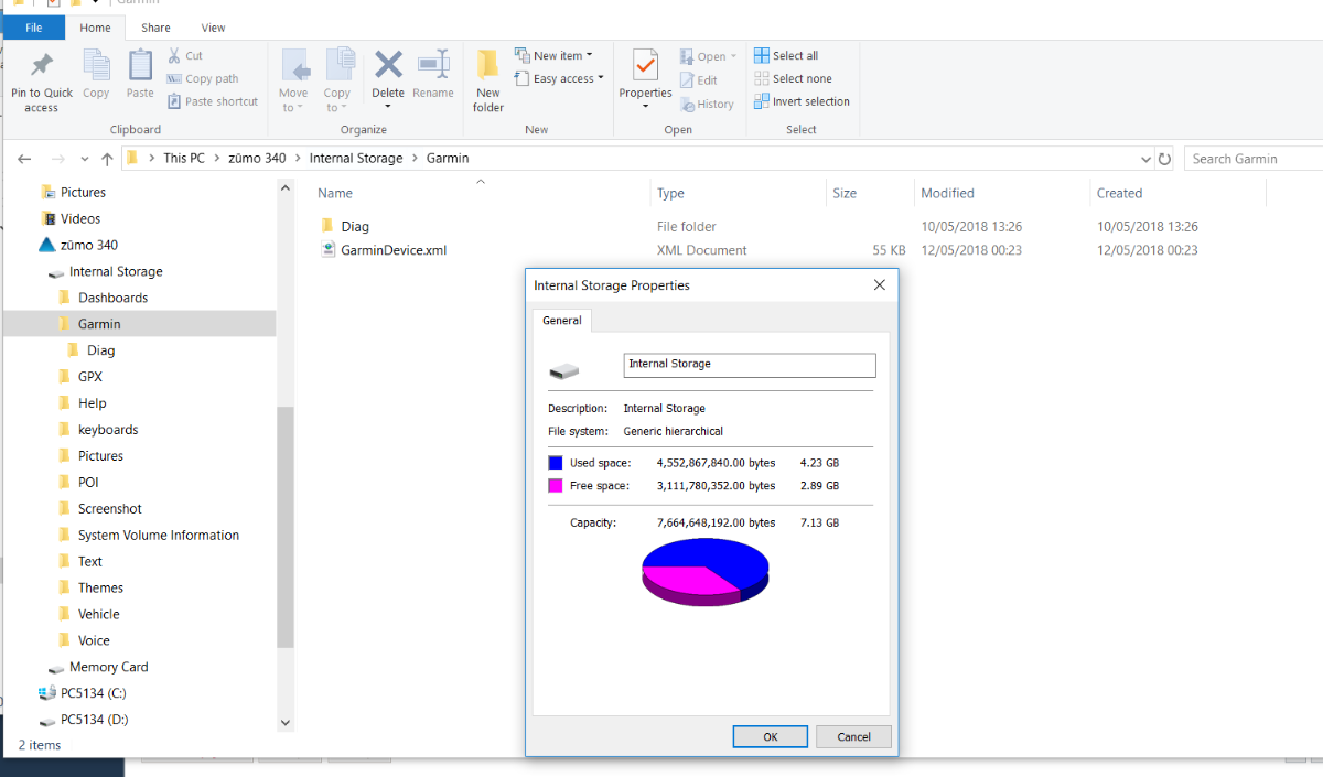

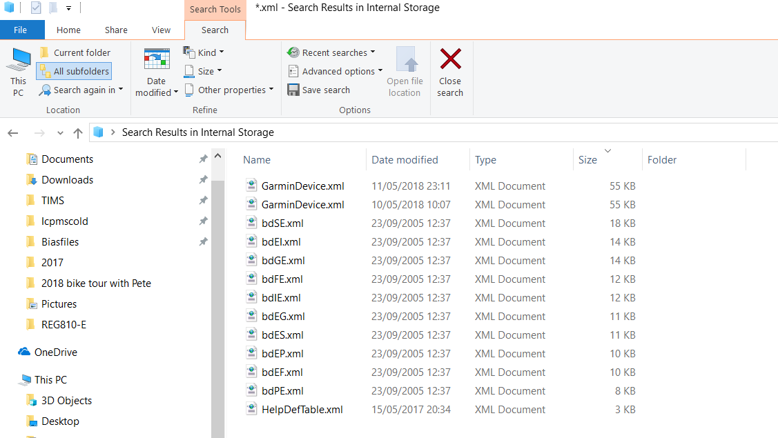

in the internal storage I can see two garmindevice.xml files. I'm guessing this probably doesn't help matters.
which of the two should I pm you?

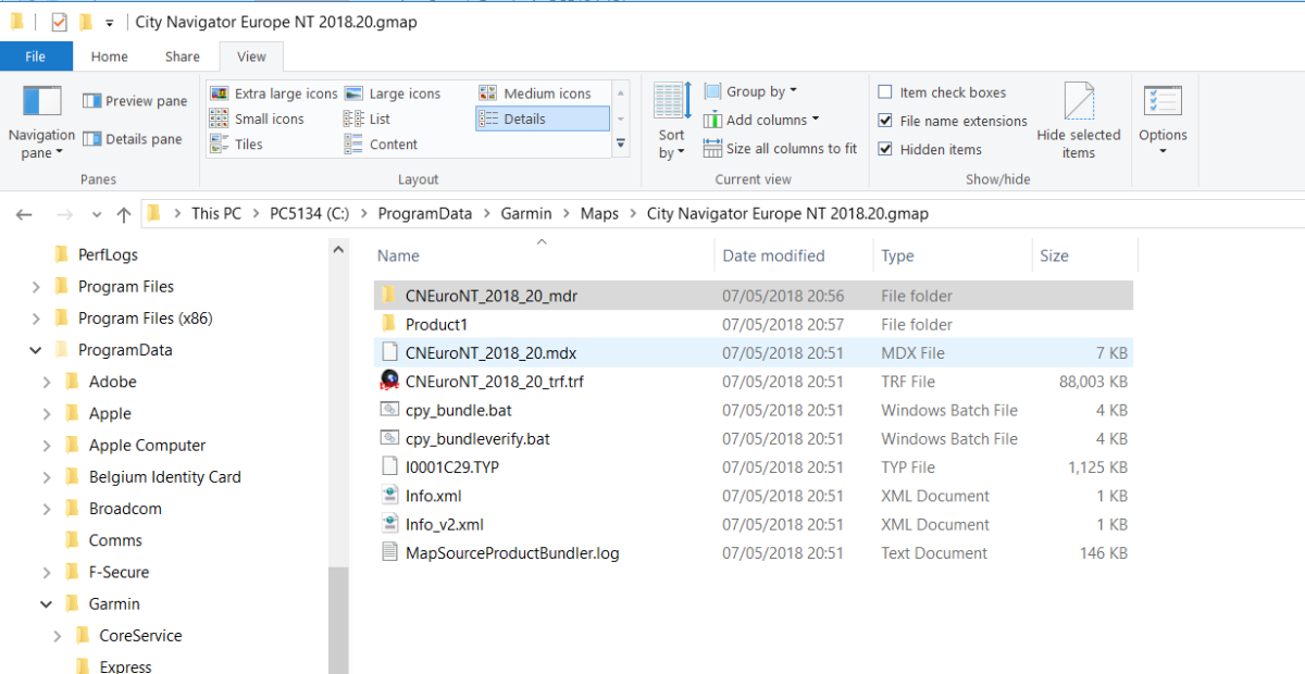

looking at my computer itself, I can see the following info about the 2018.20 map
not sure if that helps or not
cheers

Regarding size and formatting, this pic shows the info I can see about the internal memory. It does not indicate either way if it is FAT32. And I can't even see a map folder in the internal memory.
and this pic is about the memory card

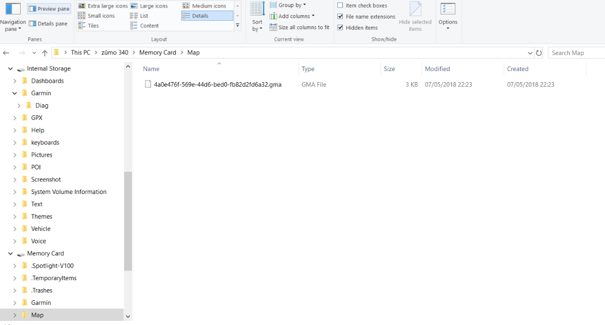

indicating it does have a map folder
but it also has a Garmin folder
and again no inidication of FAT32
