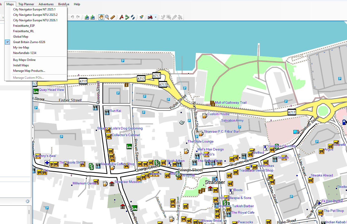

I tried your Graphical interface for making Garmin maps from OSM. Its great and much easier than remembering the commands for MKmap and Splitter in a command window. I ran the GB test file and changed the map format from ZumoXT to Generic. The Generic format works on any Garmin automotive device from a 21 year old Streetpilot 2610 to a Zumo XT whereas the ZumoXT may only work with NT devices such as the Zumo 660 BMW NAV 4 and up. (Yet to be tested).
This is Generic GB (Stranraer to be exact)
Screenshot 2025-04-13 202034.png (488.73 KiB) Viewed 6156 times

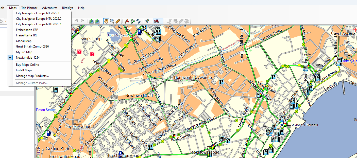

This is my first test using the Zumo XT map format of Newfoundland (as it was a small file to process)
The Map Section is St. Johns
Screenshot 2025-04-13 201835.png (745.24 KiB) Viewed 6156 times
