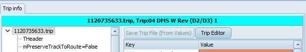

The problem, for me, is that the same list is used for all file types, and only for trip files the mtripname can be displayed. Besides getting the tripnames requires copying the file to your computer first, because a program can not read files directly from an MTP device. So it would probably take much longer just to display the list. Will keep it in the back of my head though,
For now you can rename the trip files, as @smfollen pointed out, or you can look in the green bar.
