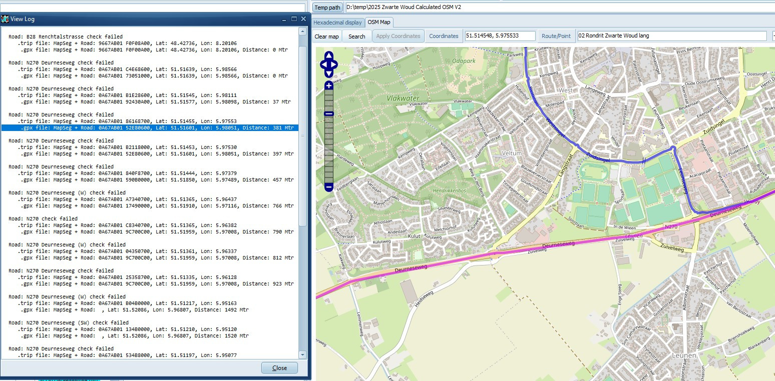

You may find it interesting to know that we (@smfollen and I) are working on version V1.5 that will have the option to do the compare automatically.
You can read more here: https://github.com/FrankBijnen/TripManager/issues/12
For anyone who would like to test that version, send me a PM, and I will give you a download link.
Here is a screenshot of the work in progress:
