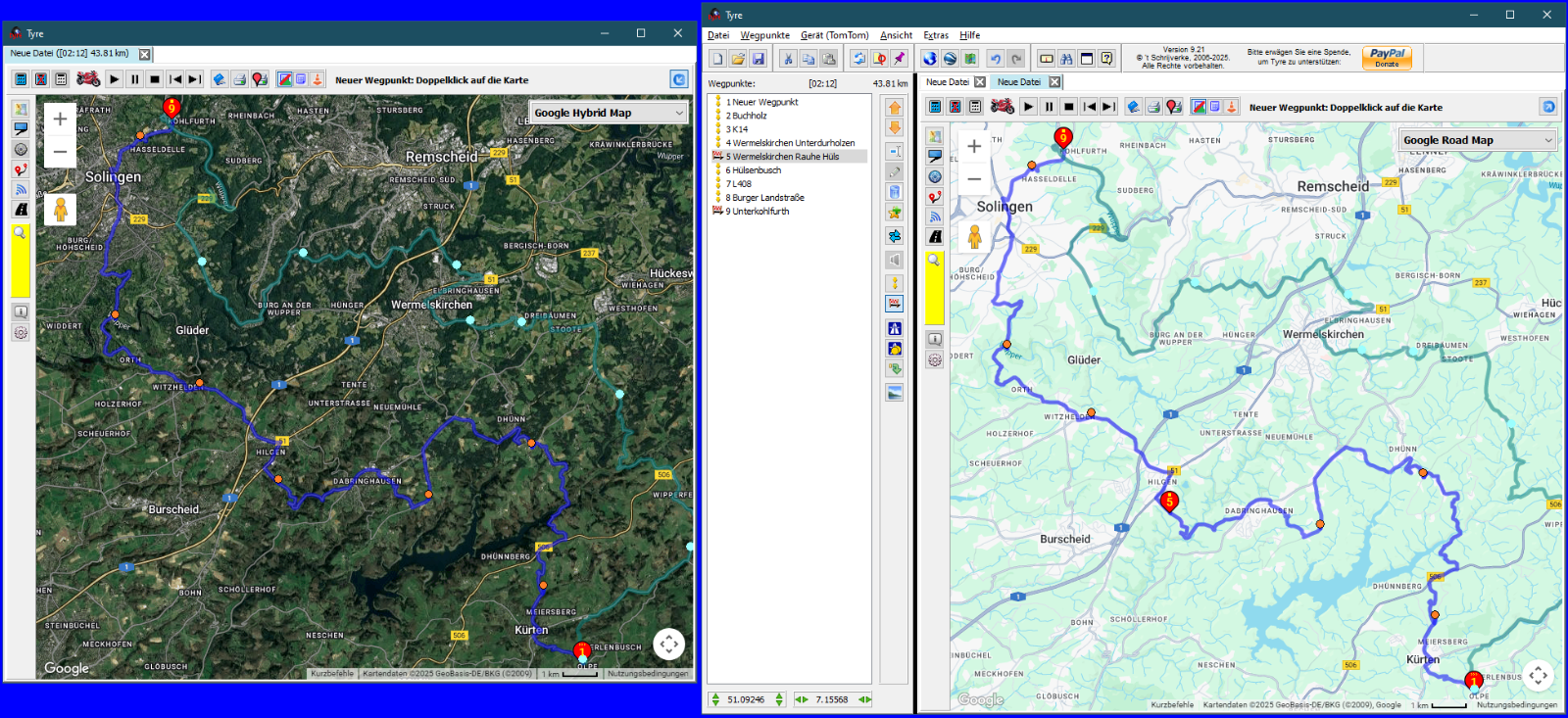

Here are the 2 views I use, that's all I need.
Tyre Demo.png (1.64 MiB) Viewed 1674 times
Set start and end points, set sharpening points, done. Then save and that's all I need.
