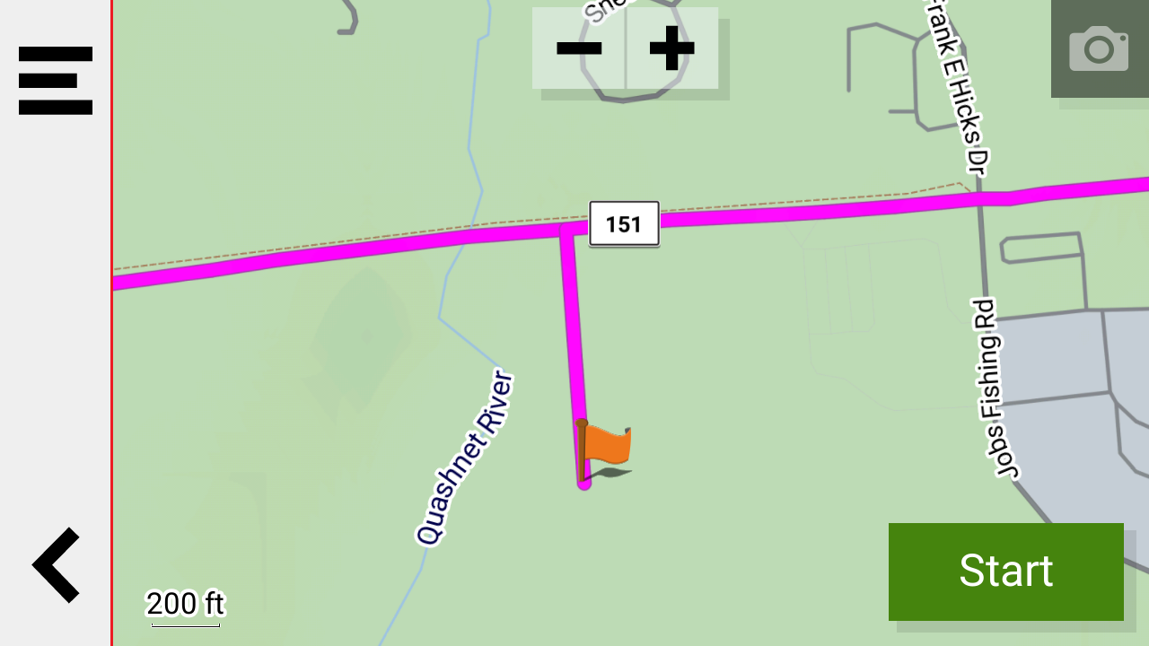

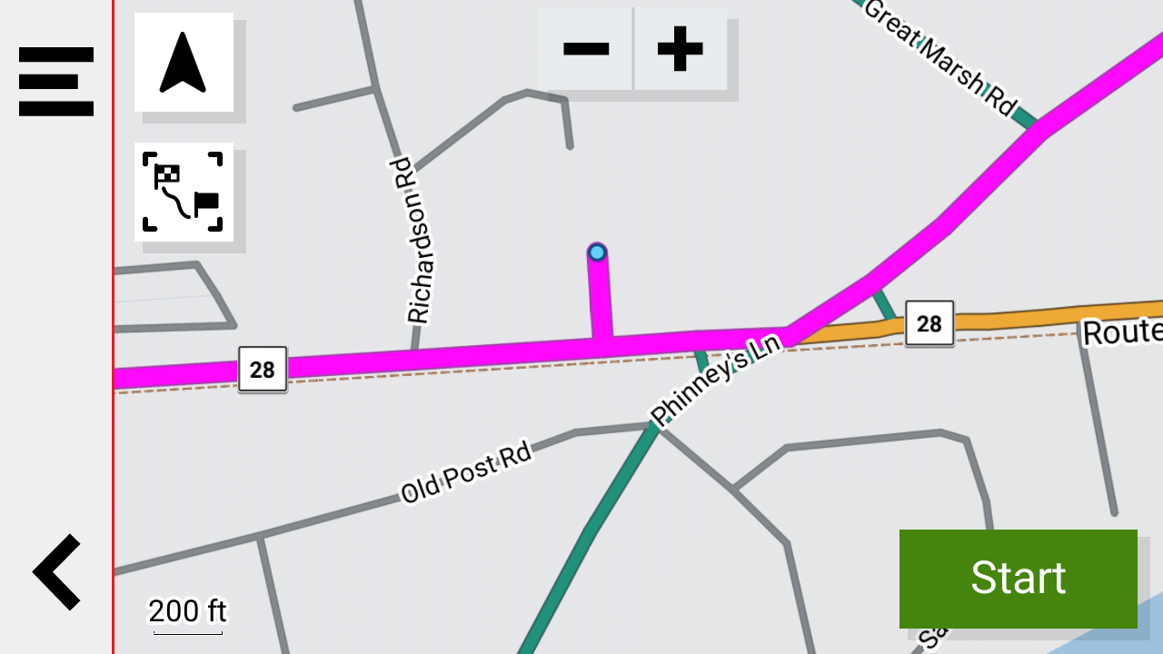

Re: XT2 won't calculate route
@Trilergy I regularly connect my XT2 directly to my pc via USB cable when using Basecamp. You get a warning from Basecamp that the XT2 is not fully supported, but it works fine for transferring gpx files and other functions. The warning is because the XT2 has newer features which Basecamp doesn't support.
Like some others here, I have removed the Tread app from my setup entirely because of multiple issues with Tread.
I have found Trip Manager to be an excellent tool for transferring routes from pc to XT2. It has several additional features which are very helpful.
viewtopic.php?p=24080#p24080
I have no problems with route calculation even when route points are not perfectly on the road.
Here are a couple screen shots showing that. The route was created in Basecamp. It was transferred to my connected XT2 directly from Basecamp by right clicking the route, selecting "send to", then zumo XT2, Memory Card, User Data. After disconnecting and restarting the XT2, I imported the route and selected it.
I also did some route tweaking on the XT2 to force recalculation on the XT (e.g. change from fastest to shortest distance). Still no issue.
In general, I would suggest that it is good practice to zoom in on your route points to make sure they are on the intended road. I have, on occasion, accidently placed points on the wrong nearby road or the wrong side of a highway
Hope this helps.
