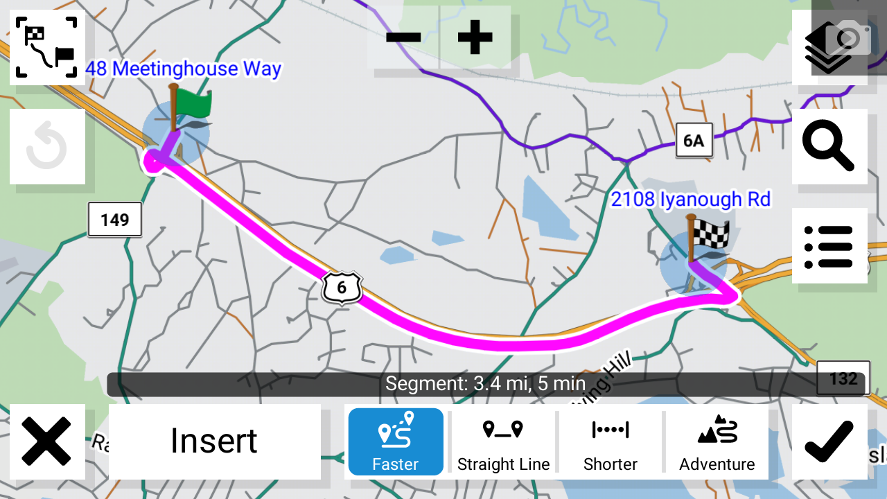

Recently, while trying to figure out a strange Closest Entry Point behavior, I realized that my XT2 was ignoring my avoid highway setting.

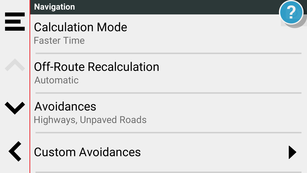

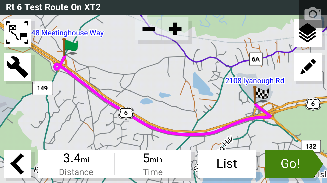

To verify that, I created a simple 2 via point route using the XT2's Route Planner. The route could be navigated by highway or by parallel local roads. The XT2 routes over the highway even when set to avoid highways.
Note that Rt. 6 is a highway (and Basecamp treats it as a highway, using the same map)

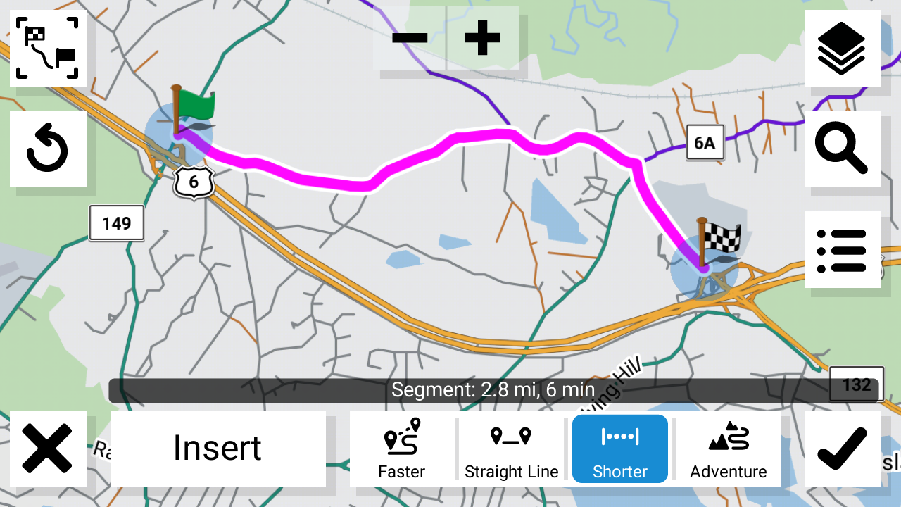

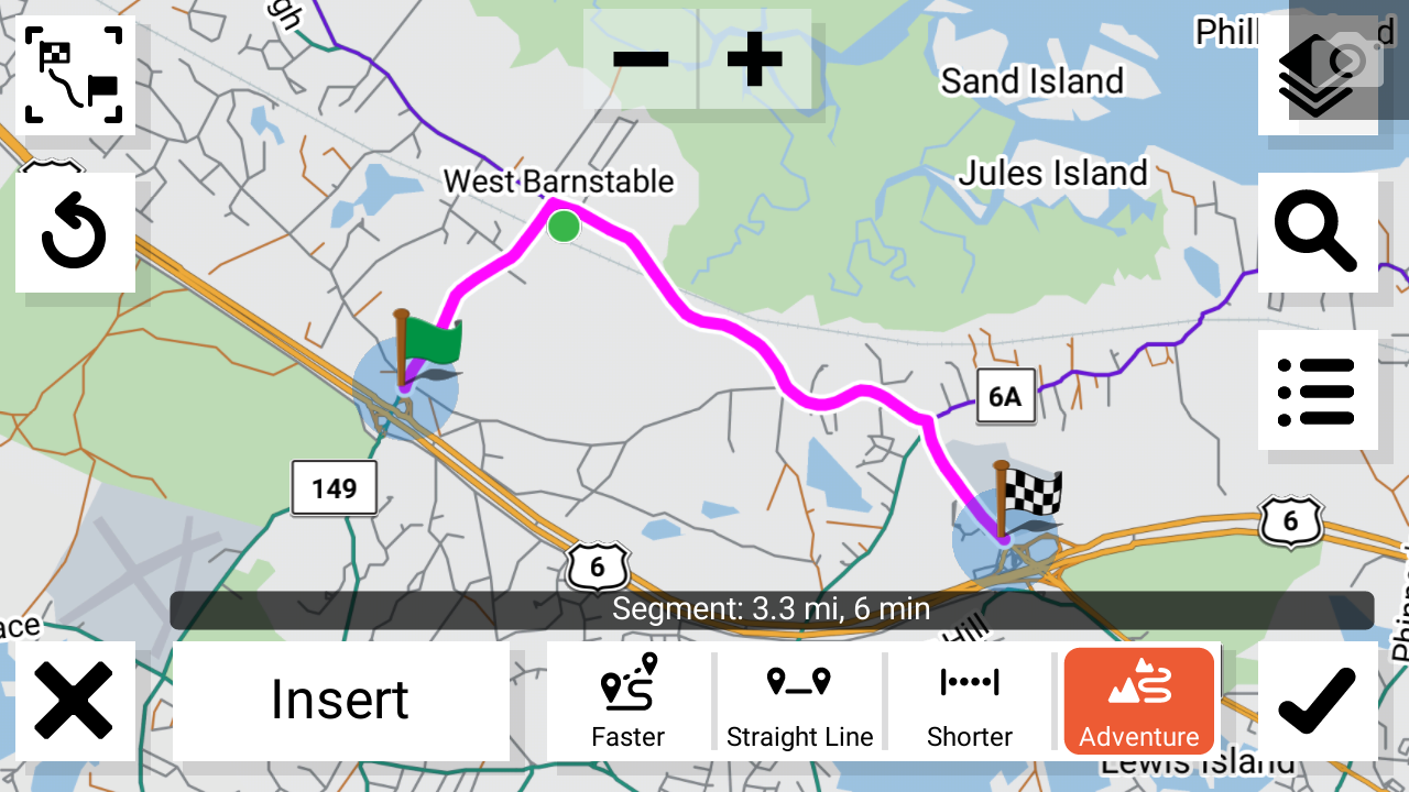

If I edit the route on the XT2, shorter and adventure versions of the route make sense.
The "faster" route would make sense, IF highways were allowed.
Again, they are set as not allowed, but the XT2 takes the highway anyway.
