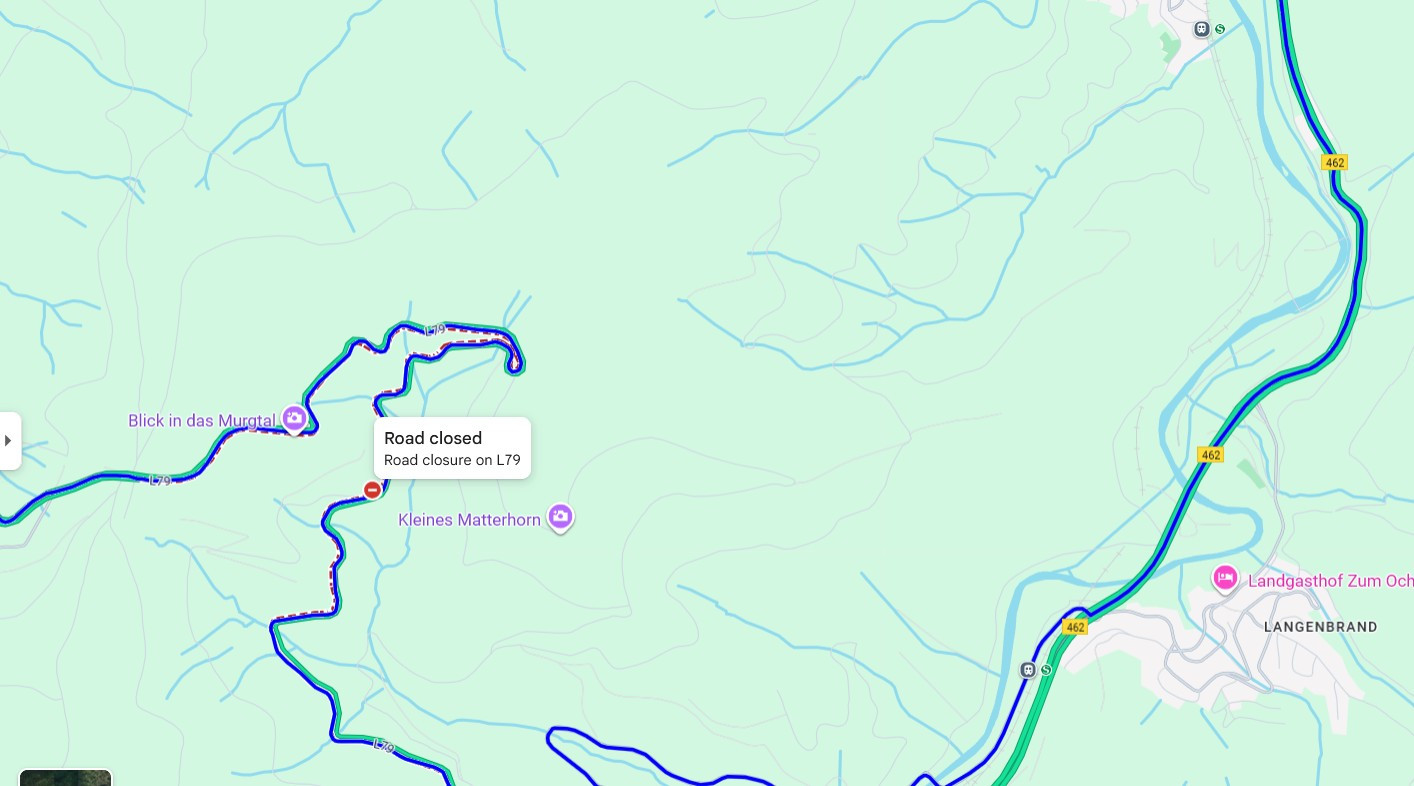

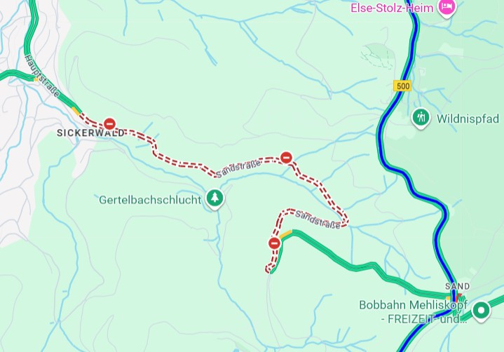

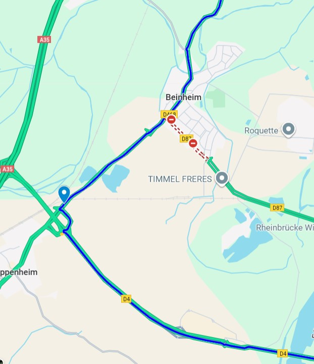

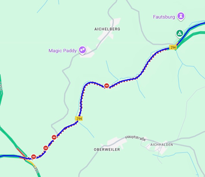

Snijderj wrote: Sun Aug 17, 2025 8:47 am I wouldn't know how far the closure extends
This triggered me. In Google Maps you CAN see how far the closure extends. And that doesn't mean I dont agree with @Peobody that he doesn't like to feed Google with more private data. But to me it's more important to find the closure.
I updated the pdf. viewtopic.php?t=1965
Here is a teaser. Some screenshot of closures of a coming trip. In total I found 7 closures on a 5 days trip.
