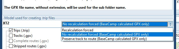

jfheath wrote: Sun Feb 22, 2026 8:03 pm Your routes will be calculated every time you load them into the Zumo because Trip manager does not create a route with all of the roads worked out.
Well that was true for the pre V1.6 versions. But V1.6 has the option to send a calculated route, that will not recalculate by default.
TM recalc.jpg (46.8 KiB) Viewed 1369 times
But beware. ONLY if the GPX is calculated by BC,with the same maps, Transportmode and RoutePreference. And even then, when the Zumo gets a chance to recalculate, it will be diffrerent.
My personal preference is to force a recalculation. That will work most reliable. You should verify that the result on the Zumo is what you want, but that can be done at home at your desk.
