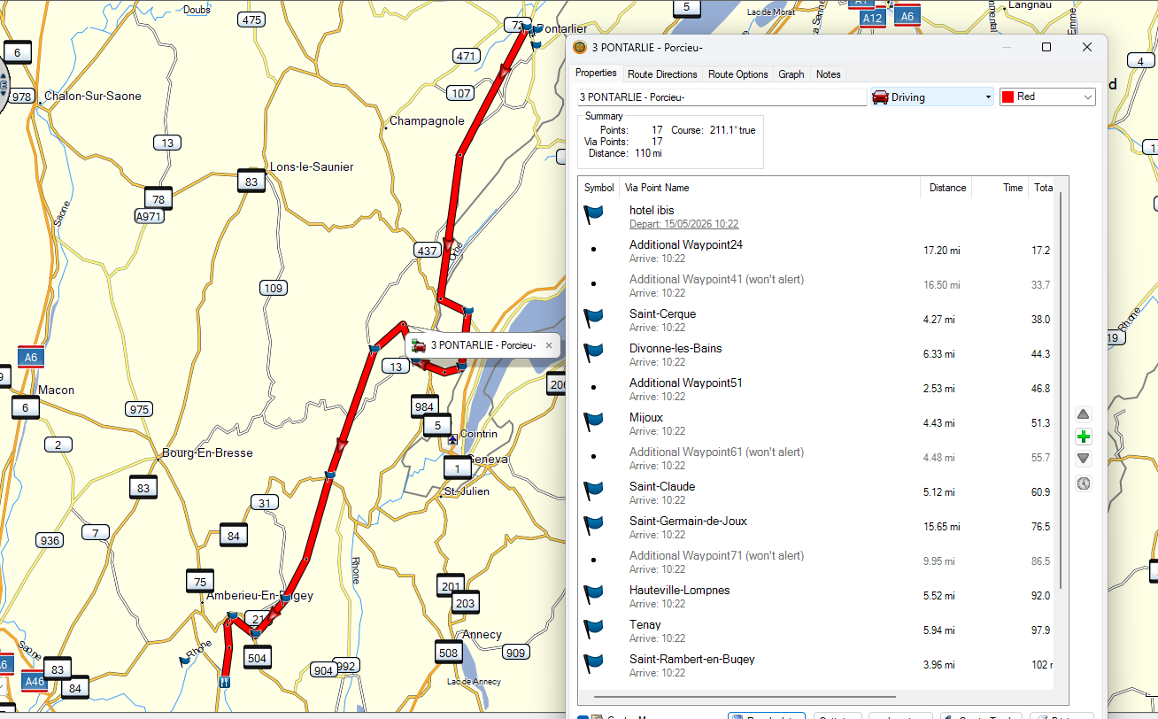

Screenshot 2026-05-07 004814.png (390.76 KiB) Viewed 575 times
]Hi Guys
I have a Zumo 390lm & a 340lm. I created around 12 routes on basecamp and loaded them on to the 390 - no issues. But when I tried to load them on to the 340 - I got the message - Route recalculation as route created on a map not loaded on to device. Both Zumos - have the same maps loaded.
When you view the map on basecamp using the map loaded on the 340's memory card - the road does not show and if you recalculate - the route turns to straight lines.
I have re installed the maps on to the memory card - but same outcome.
any ideas - what causing this issue?
thanks
Steve

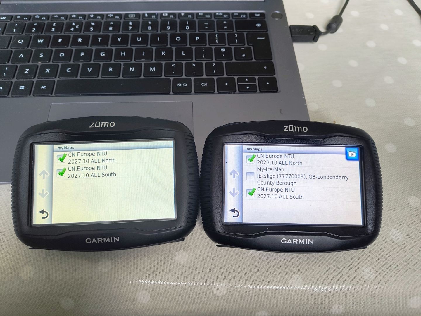

I have the exact same pair.
The maps that should be ticked are indicated in this photo. The 390 is on the right and the screen is a bit sharper as I had to replace it a couple of years ago. You can see I also have a customised OSM map on the card for the 390 which is unticked. I much prefer these units to my Zumo XT
