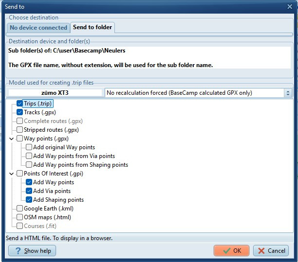

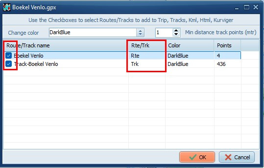

For MRA be sure to export including Tracks (Gpx 1.1 Route+track+Poi)
Tick the checkbox Tracks in SendTo
Keep the default selected checkboxes in the next dialog. Note that you can change the color here! (I tend to use DarkBlue)
And your tracks should be on the XT2. The only thing left to do is making them show on the map. You will have to use the collection settings for that.
