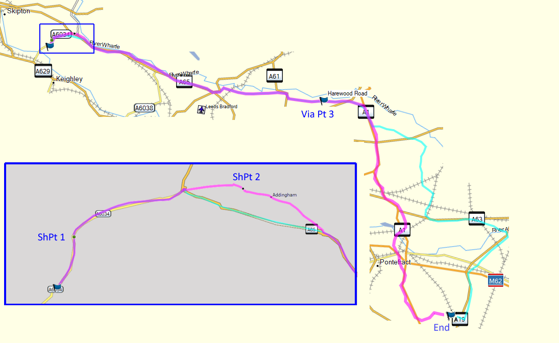

The route map - click the image to see a larger version:
Norton Test Route Overview Map.png (220.93 KiB) Viewed 220 times
The route has ShPt1 just after the start. This is there purely so that I can press skip to force the route to recaclulate. This seems to be one way that RUT behaviour can be triggered.
ShPt2 is placed on a road that I do not intend to travel. Instead of taking the 2nd exit at the rouandabout to ShPt2, I will take the third exit (UK, traveling clockwise around roundabouts) - ie heading East.
Via Point 3 merely forces the route away from a fast route along the M62 to the south of the map. I will pass through this point.
The only other point is the End Point. The Magenta route is the way Basecamp has planned it and is the way that the XT2 calculates it. I know that it will want to make me take the A1. It is faster and more direct. Nevertheless, I will take the route shown by the cyan (light blue) line.

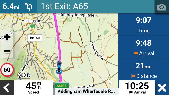

Test1 - Disappearing Route Points.
ShPt1 was skipped. That is the trigger for the behaviour that follows - the nature of the route has changed.
ShPt2 was still present and the route was navigating towards it before I entered the roundabout.
XT2 v660 RUT Test 1 - 00.png (191.31 KiB) Viewed 202 times

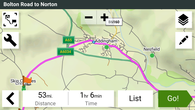

On exiting the roundabout, the route altered and Shaping Point 2 - which had been on the B6160 / Addingham - has been removed from the route
XT2 v660 RUT Test 1 - 05.png (210.04 KiB) Viewed 202 times
This particular behaviour, consistent with RUT behaviour is still present.

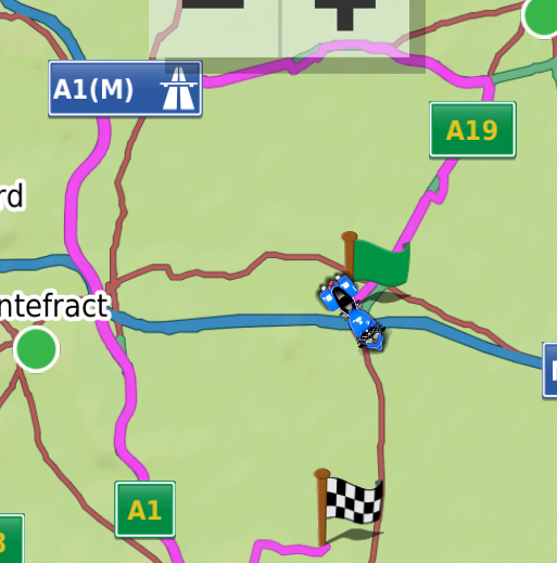

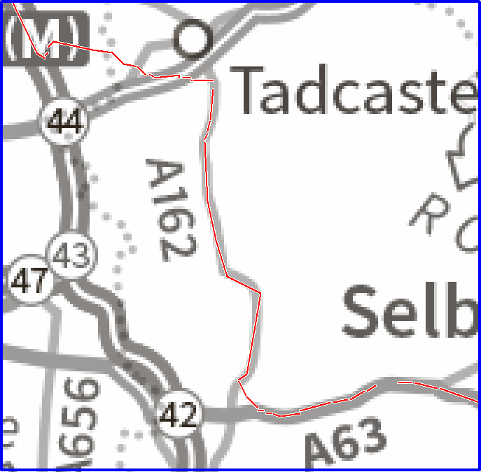

Test 2 - Fragmented Track Log
This is an observaiton rather than a test. It has happened with every route that I have tested that has displayed RUT behaviour and not with any route that has not displayed RUT behaviour. It has not happened with manually recorded tracks - only the automatically recorded CurrentTrackLog tracks. Each break coincides with when the route is recalculated.
Did my Test display a broke track log ?
Yes it did. Click the map for a more detailed image.
XT2 v660 RUT Test Broken Track Log.png (49.5 KiB) Viewed 209 times
These are the locations where it repeatedly tried to get me to go back to the A1(M) to the west. Most of these are typically not RUT behaviour, they are a legitimate request to go from where I am now, to the road that provides the fastest route. Most, but not all. But the track log is broken neverethless.
This behaviour - at the same location - can be seen as two videos of the XT1 screen at the link below.
Ignoring Shaping Points
Saved Route - Missing Shaping Point - Skip Involved
Imported Route - Missing Shaping Point - Skip Involved
(The links will replace the current page - to open the link an a new tab instead, right click and open in a new tab or window.)
I checked this behaviour when I first got the XT2 - it was identical, so I never bothered to get any evidence.
So this behaviour has not changed on the XT2 with version 6.60 of the software.

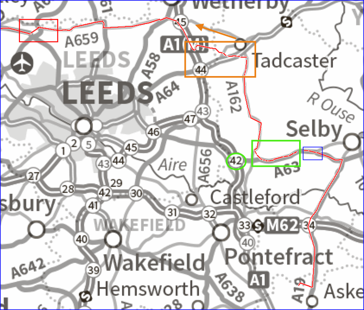

I need to look at the route map again:
U Turn Map.png (500.54 KiB) Viewed 186 times

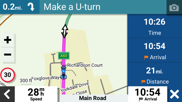

There are 4 places where I deviated from the Zumo's plotted route:
Red Rectangle. To avoid busy traffic lights. Broken track log, but the navigation continued ahead - no fuss.
Orange Rectaangle. Many serious attempts to get me to go back. 13 according to the number of broken segements - which sounds about right. But this is not RUT bahaviour. As I drove along it tried different roads to get me to head back to the A1 - initially junction 45, later junction 44. Eventually it decided junction 42 was a better alternative - which is more or less the way that I was heading. Despite the number of U turn requests and take a different road requests - this is NOT RUT Behaviour. The Garmin is Correct, I am not going the faster way, it is updating constantly and at each point finding the faster way from my current position. This is correct behaviour.
Green Rectangle. Almost within reach of Junction 42, Instead, I take the A63 heading East, and it goes bonkers.

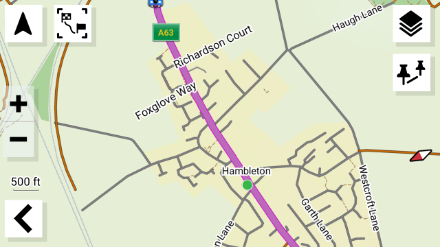

Now I know this road from previous tests. If I simulate my position on the A63 anywhere in the green rectangle and aske the XT2 to plot a route to my end location, it will head west to junction 42 to get onto the much faster A1(M). So although it is not the way I want to go, it is the better route given the routing that I have set it to use (ie Faster Time). I was getting repeated requests to either U turn or take a loop back route. Ten of them for the netx 3.5 miles. But again - this is NOT RUT behaviour. But after the village of Hambleton - where the green box ends - if I set my position East of Hambleton (in the blue box) it will navigate to the east as the faster way.
It gave two more requests to turn back and then less than a mile after leaving Hambleton, it navigated ahead.
Now - although I say it is not RUT behaviour where the Blue box and orange box is drawn, it could have been. It would do the same thing if it was. Exaclty the same. So I stopped at the side of the road and looked at the route that it was plotting to take be back to the A1(M).
It was not heading back to Junction 44, or to Junction 43. It was heading to Junction 42. That isn't RUT behaviour - RUT behaviour would take me back to Junction 42. Some of the turn back requests were not U turns, they were loop back using a side road requests. If this was RUT behaviour, I would be able to see them on the route.

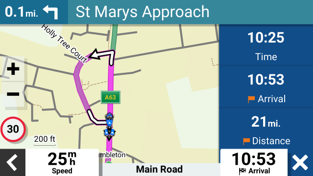

Below is one such turn back loop shown while the satnav is navigating. This is yesterday in the middle of Hambleton.
XT2 v660 RUT Test 1 - 24.png (110.62 KiB) Viewed 179 times
And the screen a short distance later after the route had calculated to the next U turn request.
XT2 v660 RUT Test 1 - 25.png (79.85 KiB) Viewed 179 times
The next image is the preview screen shorly after the previous screen. I stopped and zoomed out as far as I could and still retain the detail. You can see the tail of the motocycle icon on the road above the A63 road marker. You can also see the road where the turnback loop was plotted. The route no longer shows the turnback loop - even though at this stage the route is aiming for a U turn.
XT2 v660 RUT Test 1 - 26.png (157.46 KiB) Viewed 179 times
The above three are contrary to previous tests where the turnback loops have remained - primarily because the Zumo was calculating only to the point where it last asked me to turn back. It tagged this new short section of route onto its previous route. Which is why it could never escape from RUT behaviour - it wasn't even making an effort to calculate a new route. It was only tagging a bit to get you back to where you were.
