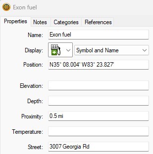

Regarding an audible warning to occur 0.5 miles in advance of this WayPoint (see attachment), I perform the following:
Settings
Driver Assistance
Proximity Alerts
Audio
Single Tone or Continuous Tone.
I tried Continuous Tone but one-half mile of tones was overkill.
I tried Single Tone, and I mean I really focused on hearing the single tone, but I never heard the tone.
I typically listen to music so I expected an interruption in my music in order to hear the Single Tone but to no avail.
Anyone have any advice for the successful use of Proximity Alerts.
I thank you in advance.

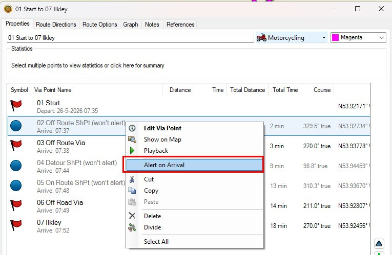

3) It can be part of a route/trip. It will alert only when it is marked as a Via point/Alert on Arrival in BC.
Are you talking about 3? Set it to 'Alert on arrival' on the route in BC, or change it to a 'Via point' in the 'Trip Planner' on the XT.

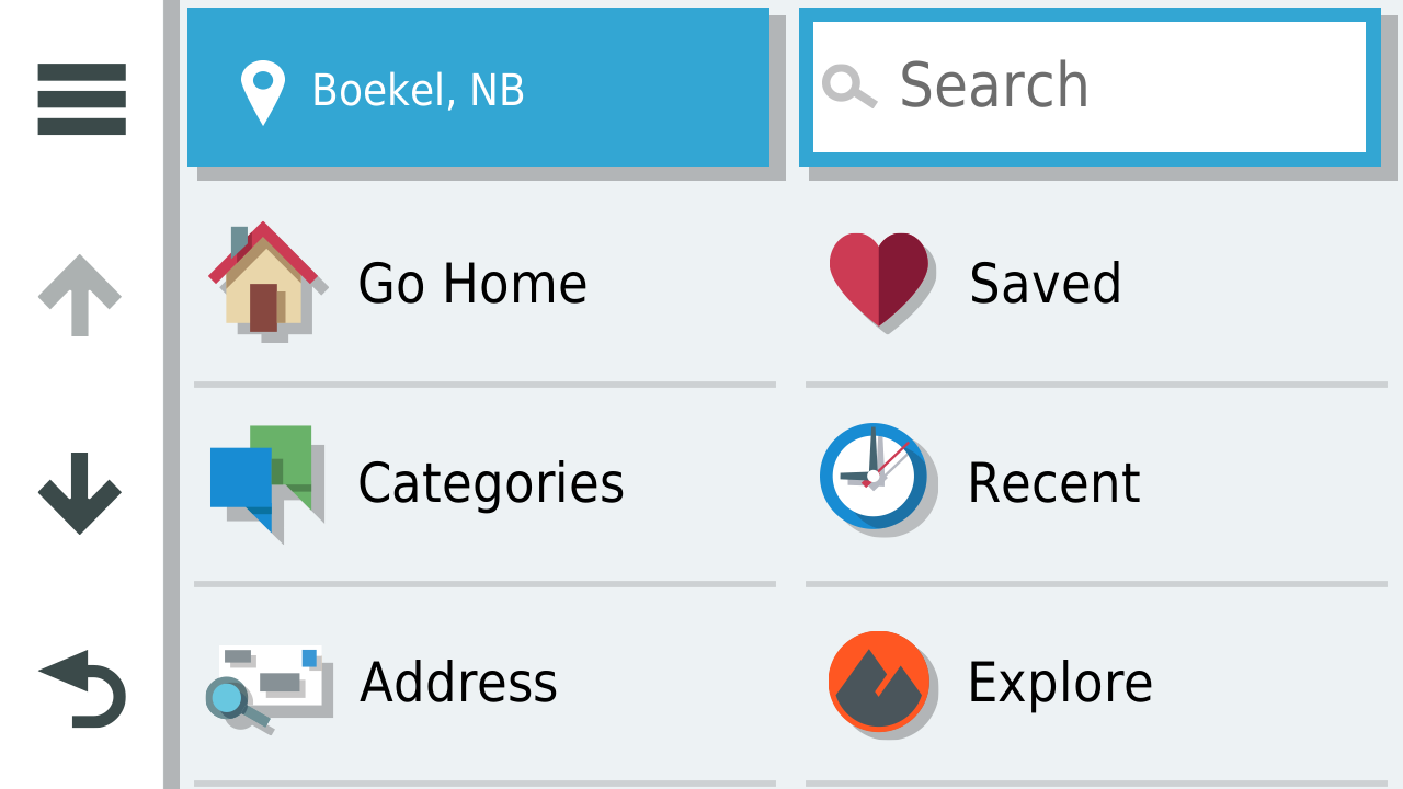

Screenshots of the XT:
When you click on 'Where to' choose either 'Categories' for option 1, or 'Saved' for option 2.

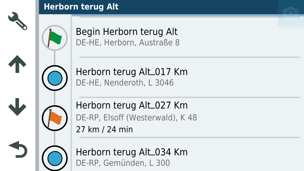

When you open a trip on the XT, in the Trip Planner. You can see shaping points as blue dots, or via points as red flags. The blue dots will not alert you, the red flags will.
