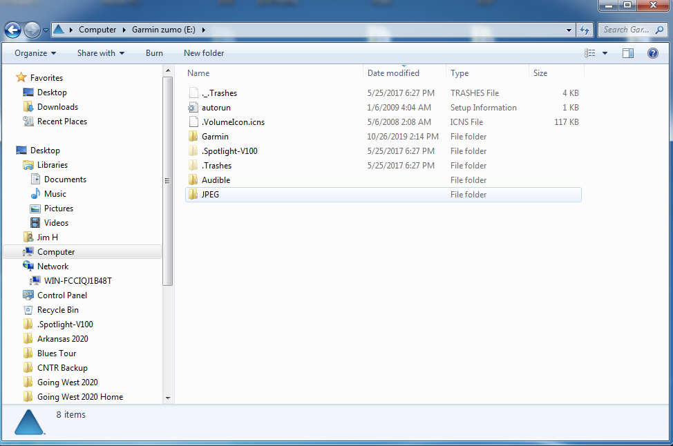

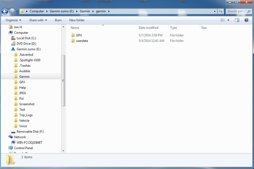

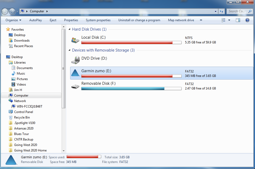

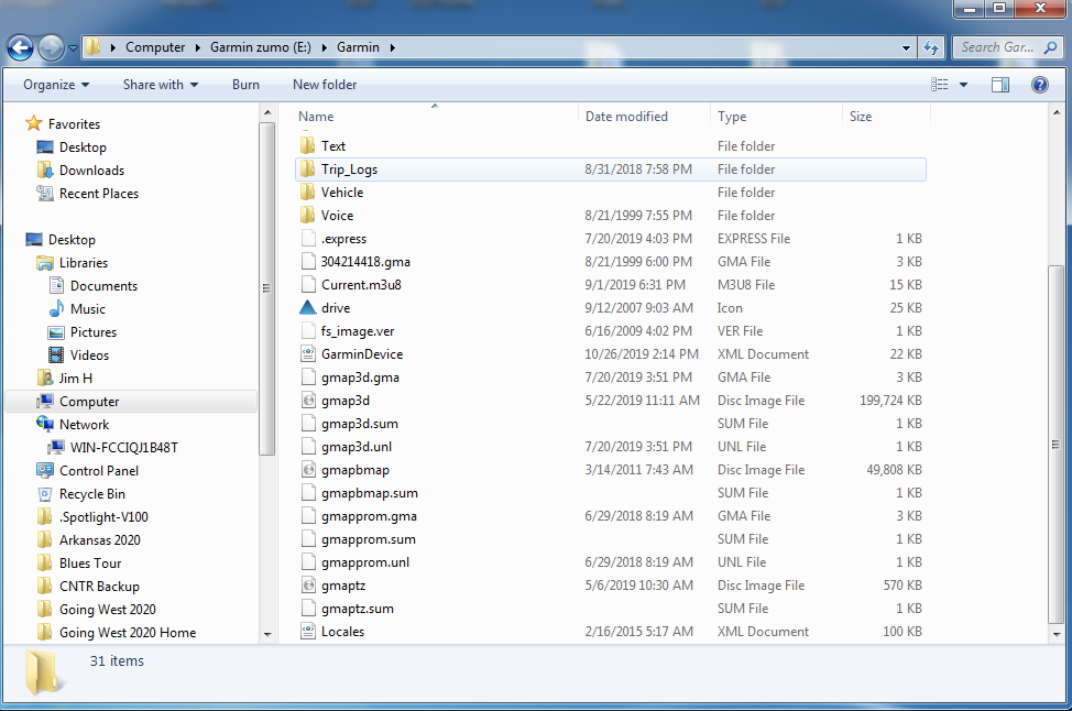

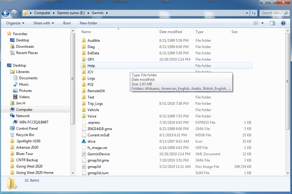

Here are some images from the files on my Garmin Zumo 665' main memory. As you can see, there is not a lot of space left and there appears to be a "hidden" file or two which I suspect are some old 2019 maps.
- Garmin Device
- Screen Shot 2019-10-26 at 1.25.57 PM.png (143.71 KiB) Viewed 5532 times
- Garmin Main Memory
- Screen Shot 2019-10-26 at 1.23.22 PM.png (156.95 KiB) Viewed 5532 times
- Garmin Folder
- Screen Shot 2019-10-26 at 1.23.33 PM.png (128.46 KiB) Viewed 5532 times
- Garmin Folder in Garmin folder.
- Screen Shot 2019-10-26 at 1.23.47 PM.png (117.41 KiB) Viewed 5532 times
carolinarider09

Re: 660 locks when asking for Route Preview

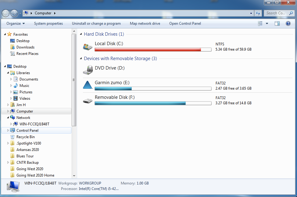

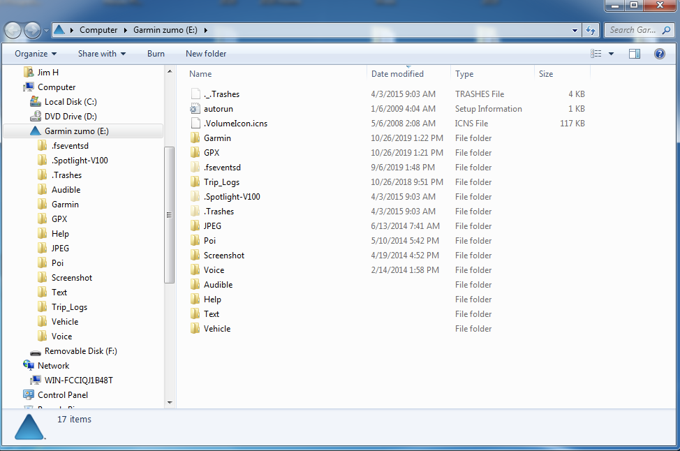

Here are some pictures of the Zumo 660 memory. I had thought that the map files were stored on main memory on the 660 but such is not the case. In looking at the 660's information, the 2019 maps are not there which is what I suspect is taking up the space on the main memory of the 665. But since the maps are stored on both devices on the memory card, the only real issue is can I recover the space on the 665's main memory?
- Memory Available
- Screen Shot 2019-10-26 at 2.15.26 PM.png (146.1 KiB) Viewed 5529 times
- 660 Memory Allocation
- Screen Shot 2019-10-26 at 2.15.34 PM.png (133.74 KiB) Viewed 5529 times
- 660 Garmin Folder (Pic 1 of 2)
- Screen Shot 2019-10-26 at 2.15.43 PM.png (173.64 KiB) Viewed 5529 times
- 660 Garmin Folder (Pic 2 of 2)
- Screen Shot 2019-10-26 at 2.15.58 PM.png (176.62 KiB) Viewed 5529 times

You seem to have plenty of available memory on the 660. Can you do a similar look at the 665 and see if there is a remnant gmapprom or gmapsupp file lingering in the "zumo>Garmin" directory?carolinarider09 wrote: Sat Oct 26, 2019 6:26 pm Here are some pictures of the Zumo 660 memory. I had thought that the map files were stored on main memory on the 660 but such is not the case. In looking at the 660's information, the 2019 maps are not there which is what I suspect is taking up the space on the main memory of the 665. But since the maps are stored on both devices on the memory card, the only real issue is can I recover the space on the 665's main memory?
I didn't know that the map files were on an SD card in the 660. I wonder if your issue with the 660 locking up is because the files are on an SD card and the data transfer handshake between the processor and the card is puking (I assume that you have a full mapset on the card. It might be that you are asking the processor to deal not only with a full mapset but manage a handshaking protocol as well). Since you have so much memory available on the 660, perhaps you could try installing a mapset that is only of the regions you reasonably expect to be riding in using MapInstall. North and South Carolina, eastern Georgia, eastern Tennessee, and Virginia are only about 175Mb.
