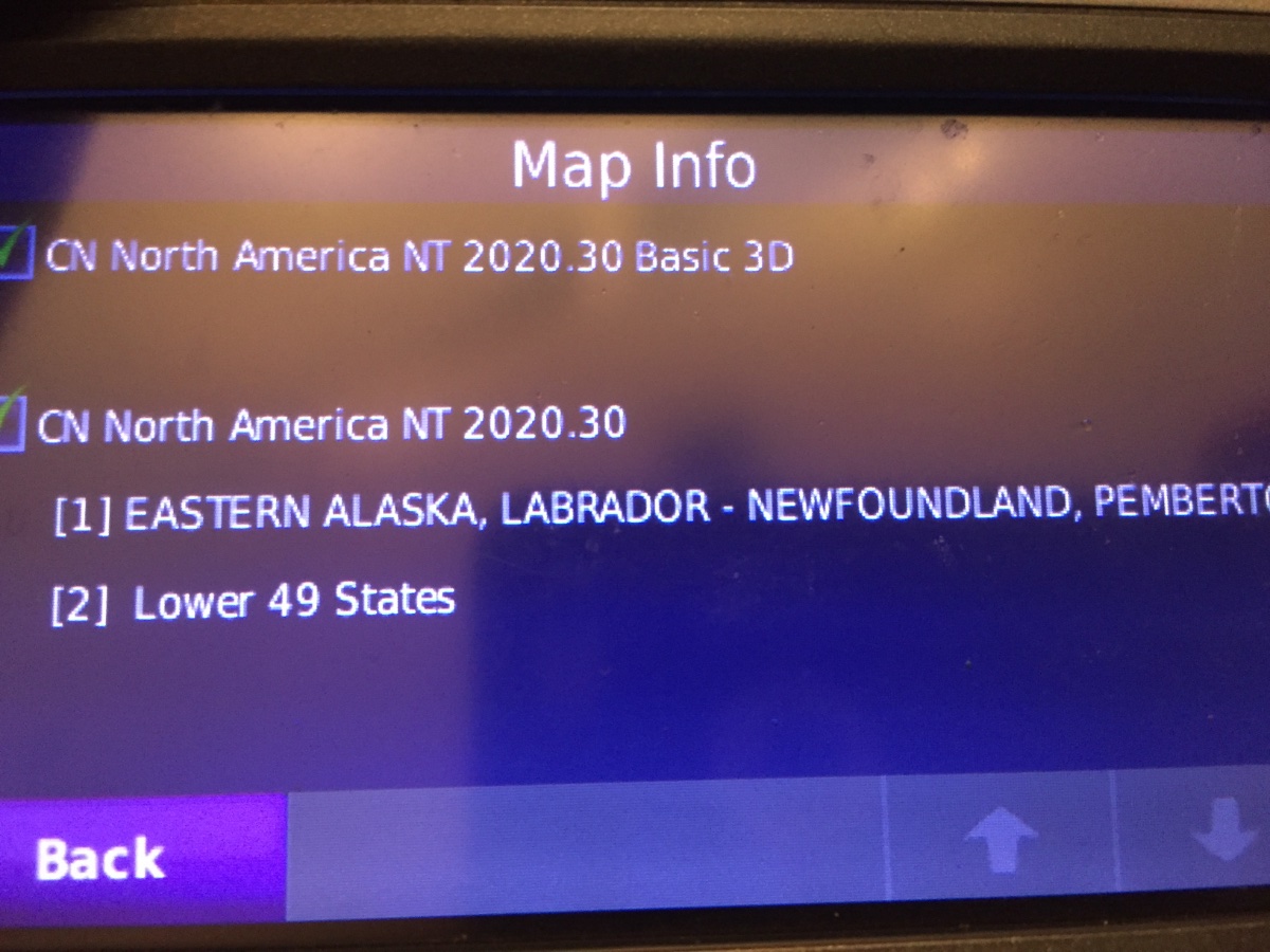

I will attempt to "clone" the new 32 GB card I purchased today (already did a FAT32 format under windows) and see if it will work in the unit.
I wish I had taken before and after pictures of the GPS Map info screen. The picture below is the current status of the GPS.

Status - It appears that I now have the maps they way I wanted and now have an install process for future operations.
