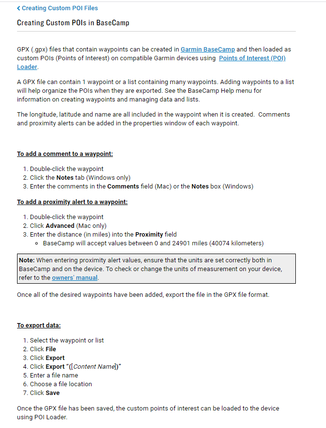

I have POIs on my device. I loaded them with the POI loader. I have followed these links and none of them talk about a ".gpi file" You have referenced ".gpi file" quite a few times. BaseCamp makes the file a .GPX when I export it, just like the directions say:
https://support.garmin.com/en-CA/?faq=T ... H7hQQyEet7
Capture 1.PNG (113.43 KiB) Viewed 3472 times
The POI loads the .GPX file and I have them on my GPS as that is where I am saving them to.
If I save them to my computer, then the POI loader makes the file a .GPI. But then what? I tried to import the .gpi file into BC. But it wont recognize it.
What is the difference from GPX and GPI?
Other than being able to load the GPI file what good is it? How can I view it?
