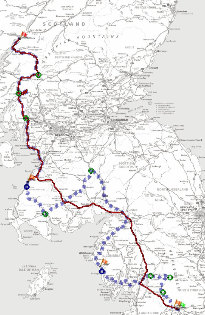

For Possibility 1 above, Here is an example of what happens when you select the next destination when starting a route.
(Click the map to get an enlarged view)
Next Destination 2.jpg (165.18 KiB) Viewed 6208 times
The route has 3 Via Points - the orange flags. One is close to the start at Skipton - placed there to stop this error being made.
The other 2, working north west are at Ravenglass and at Girvan. The end point is at Fort William.
The route starts at the southern end and heads north.
Between the flags are some shaping points shown on this map as green or blue circles.
The blue dotted route is the route that was planned in Basecamp and which is loaded into the Zumo perfectly.
When you load the map and press Go - it asks you to 'Select Next Destination'.
It offers my start point Ilkley, Skipton, Ravenglass, Girvan, Fort WIlliam
If I select Girvan, the red line on the map is what happens to the route. The satnav makes its own way to Girvan and ignores every single shaping point and Via Point in order to get there. From Girvan onwards, the route is navigated properly.

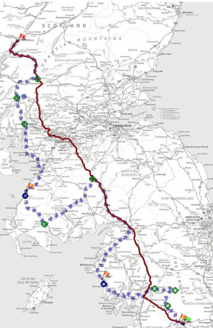

If you select the end point of the route in response to 'Select Next Destination' , then this is what happens.
Next Destination 4.jpg (165.16 KiB) Viewed 6208 times
My entire route from Basecamp is completely ignored, and instead I get a new one that is calculated by Zumo. The last few miles to Fort William coincide - but only because there isn't another way.
For my routes I usually place the start to be where I consider my route to start, not my actual starting point. I believe rbentnail did the same. That way the satnav will get me to that point, and I don't care which route it takes, and then starts to navigate my route from there.
