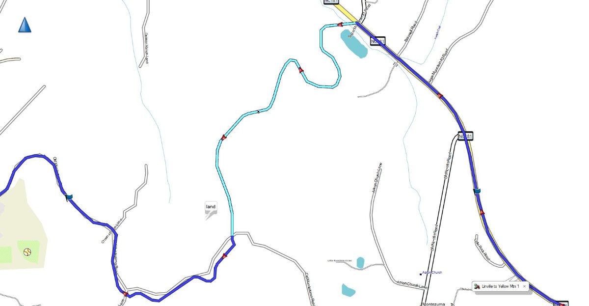

Here is the section of the route in question (click the map to see the full detail):
rbentnail detail.jpg (56.8 KiB) Viewed 5856 times
There are two blue flags on the dark blue section of the route - these are Via Points.
There is a small square do in the light blue section of the route. This is a shaping point.
So the blue route is precisely what the author of the route created on a USA Garmin Map. I have loaded it into OSM maps and it has retained the same route.
I have coloured the middle section light blue - because my OSM maps indicate that there is actually no road on my maps for that section. A bit of Google research revealed that there used to be a road (or track) as seen from the satellite images, but the historic street view photos show no road in use for at least the last 11 years.
So my maps appear to be correct, the ones used to create this route seem to be out of date for this particular section.

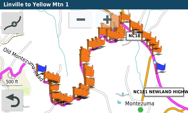

This screen shot hints at a possible issue. The original route had 7 routing points in addition to the start and end points.
I can't count how many Via Points there are on the image below, and I can't see the single shaping point. Zoom in a bit.
Strewth !!!! What is going on here then ?
Well _ I can only guess. Sorry. I can only make an educated deduction....
1. I have coloured in two of the orange flags. They are now blue. These were there as Via Points on the original route. Everything else has been added - and they were added by Basecamp, not by the Zumo. I know this because I exported the route as a GPS file from Basecamp and studied its contents.
2. The Shaping Point has moved. I think this has been moved so that it is on a road that my Basecamp with my OSM maps knows exists. This is just after the first Via Point on the right hand side of the map.
3. The original route has been retained. Even though it is not following a real road, it has taken each of the invisible route points (I call them Ghost Points) that make up the fine detail of the route, and turned them into something else. On the Zumo screen they look like Via Points, but they do not show up in the Zumo's route list of Via Points and Shaping Points.
I am guessing that the only way that a navigable route can be retained when routing on roads that are not on the map, is to plot a number of fixed points and join each one to the next with a short straight line. It looks as though this may be what has happened.
4. So how does it behave when navigating ? I can only do a simulation - turn the GPS off, position the bike in North Carolina, load the route, tap Go and see what happens.....
.... and it follows the route. As it approaches each orange flag, the screen flashes up a message - 'Approaching' - just as it would with a Via Point. But there is no name or label. Just 'Approaching'. One of the ways to find out what else goes on in the Zumo's brain, is to Skip a point. I discovered that all sections of a route are recalculated if you skip a point, doing this. So I tried to Skip the next point to see what happened. The change route option (which is where the Skip facility is on a Zumo 595) was greyed out. Skip is not available while it is navigating this section.
So I let the Zumo continue its simulation, and when it reached the next original waypoint (the blue flag at the left of the screen image), it continued along the route as before.
It did occur to me that these numerous not-quite-Via points were the things that were creating navigational issues for the original member. You would have to visit them in order to stop the satnav trying to get you to go back. It seems as though that section of route is locked in.
