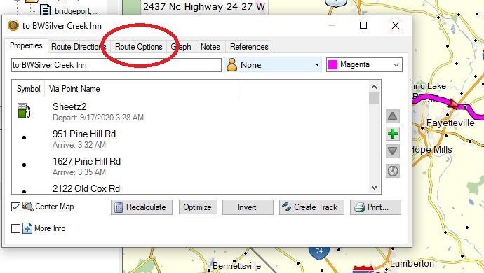

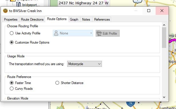

Re: Can I stop my nav from recalculating my designed route?
Route Properties.JPG (57.6 KiB) Viewed 10726 times
Customize Route Options.JPG (41.36 KiB) Viewed 10726 times
Another thing- when you make your route in Base Camp, select "Customize Route Options". Do this by double clicking the route name to open the Route Properties box. Click the "Route Options" tab.
Then tick the "Customize Route Options" box and fill out the info below that.
This may help to specify to your gps device to use custom selected parameters, kind of overriding the generic Base Camp or device ones. It helps immensely on the 595 model.
Just note that rather than customise route options for individual routes you can also go to Edit, Options, Activity Profile from the BaseCamp tab bar then select the routing tab, this will set it for all routes using that activity profile. Note in this tab you can adjust the speeds on various road types that BaseCamp uses to calculate the route, some find this helpful to force BaseCamp to avoid, or use, certain road types by setting speeds higher or lower than the default ones.
While you're there note you can also set up your own activity profiles, I find this useful.
